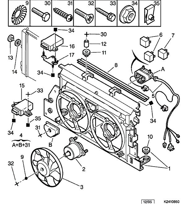

From the third picture, it looks like there’s a way to get to the wires inside the relay box to see their colours and follow them around the back.
