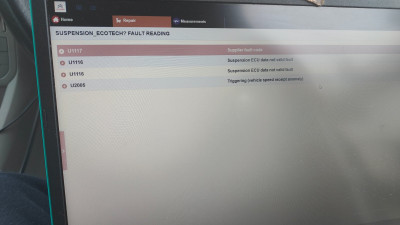

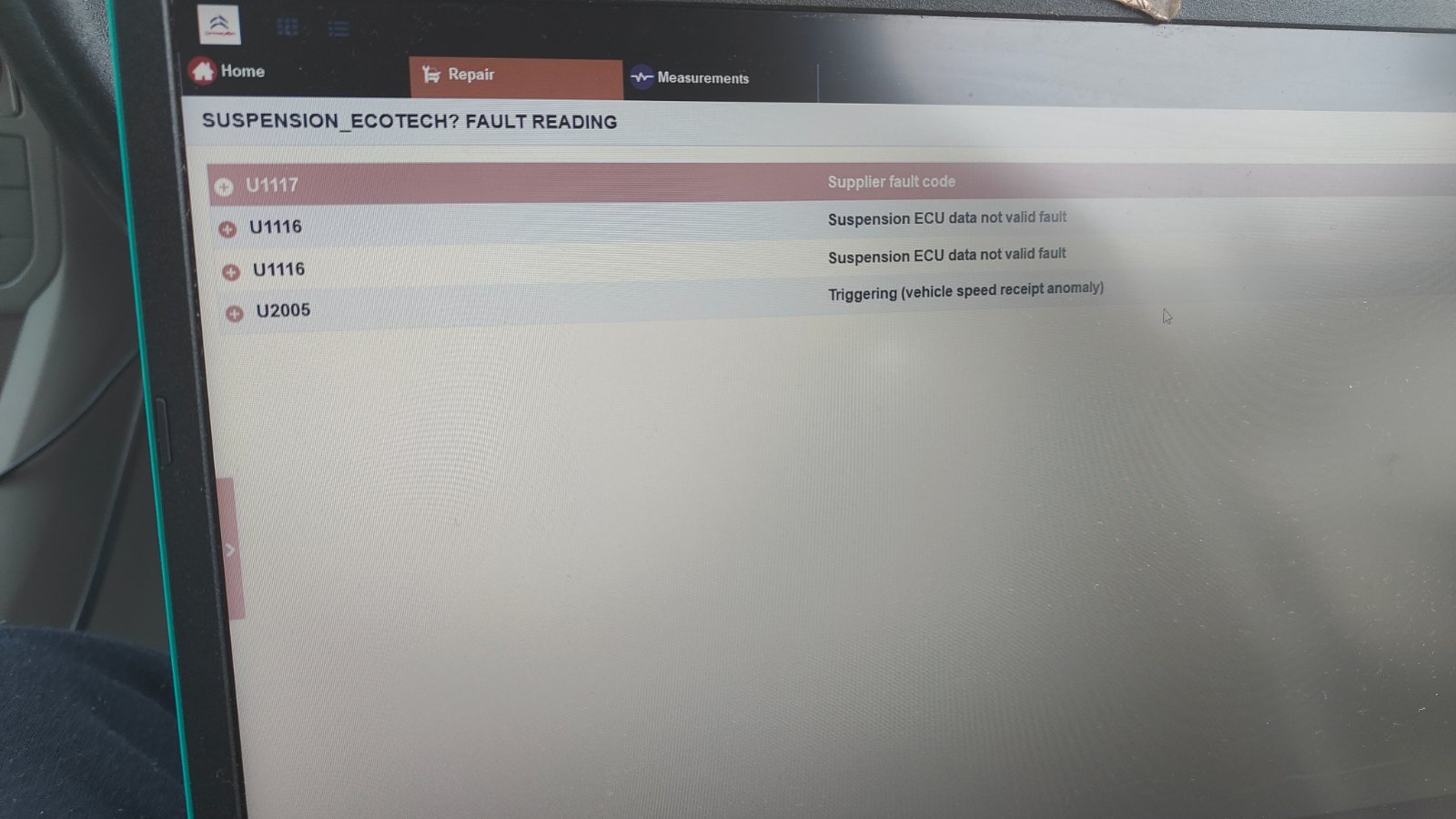

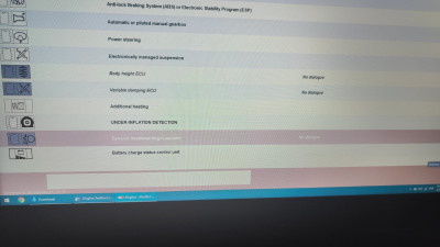

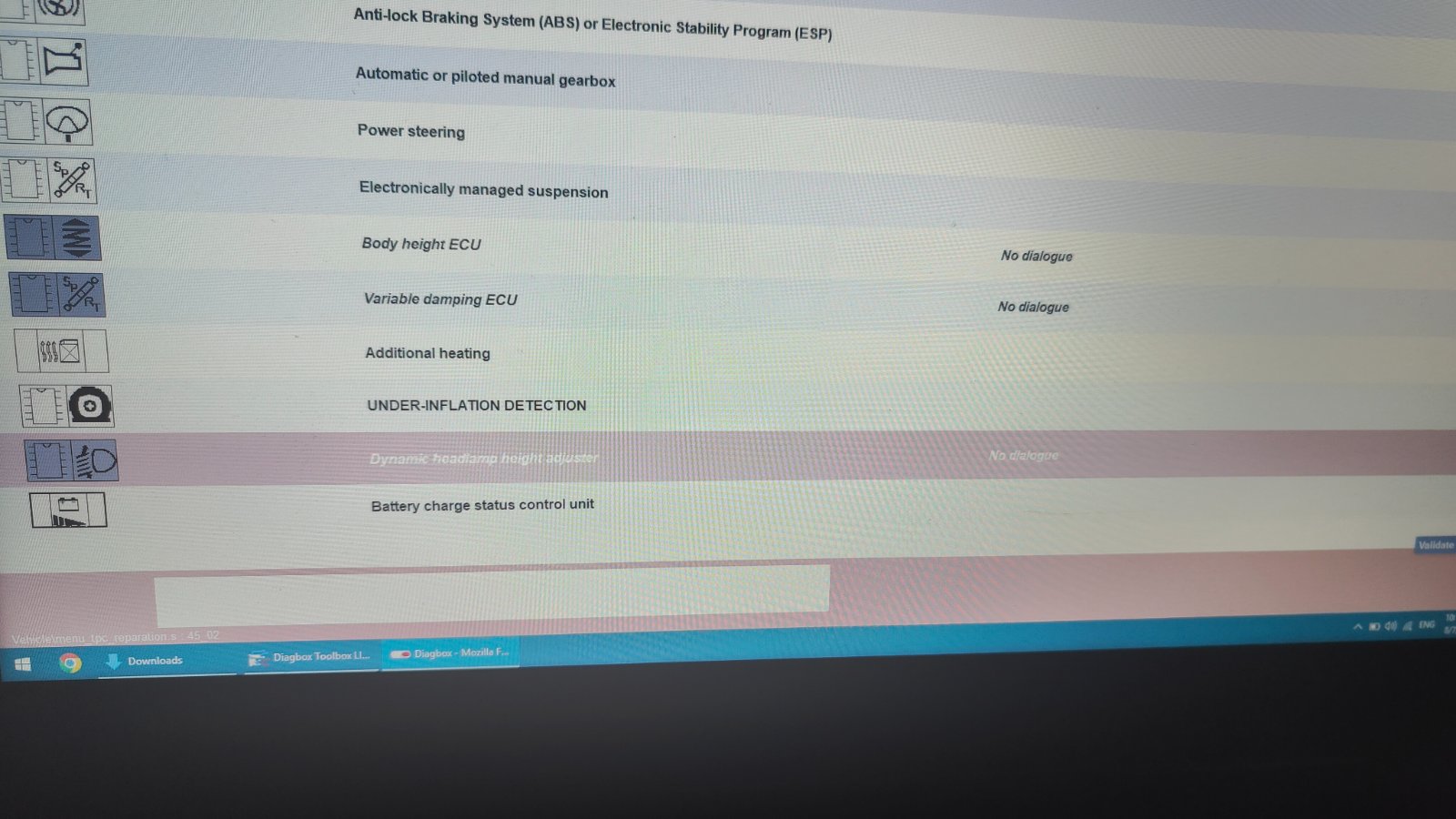

U1116 Suspension ECU data not valid fault
This is the fault that I get when I give another test, and also telling me that
Body height ECU - no dialogue
Variable damping ECU - no dialogue
Dynamic headlamp height adjuster - no dialogue. Can you tell me what should I change first? where to start? Thank's

There is no further data available on the fault because with these data errors, it simply cannot communicate with the BHI. The protocol controller is part of the CAN system and the suspension ECU uses the CAN network to communicate with other systems. If the CAN controller in the BHI is not working, then this is why you will get issues.
So you've either got an issue with the electrical connections or the ECU in the BHI.
Fault for the Integrated BHI:
U1116 Suspension ECU data not valid fault : Protocol controller not functional
Fault for the Directional Headlamps:
U1116 Fault: Suspension System ECU missing : Absence of communication
U1117 Dialogue with the suspension ECU : Absence of communication
