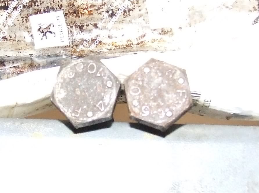

I took some photos of my "spare" bolts, the markings seem identical to yours.
