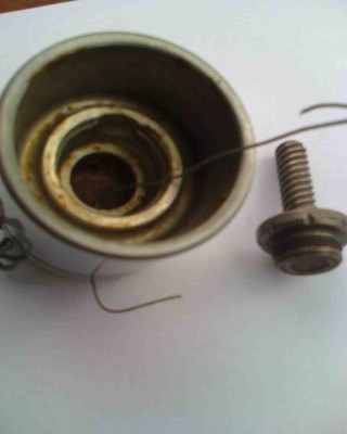

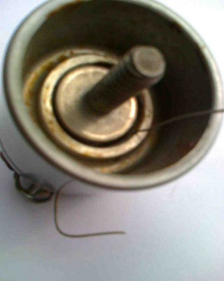

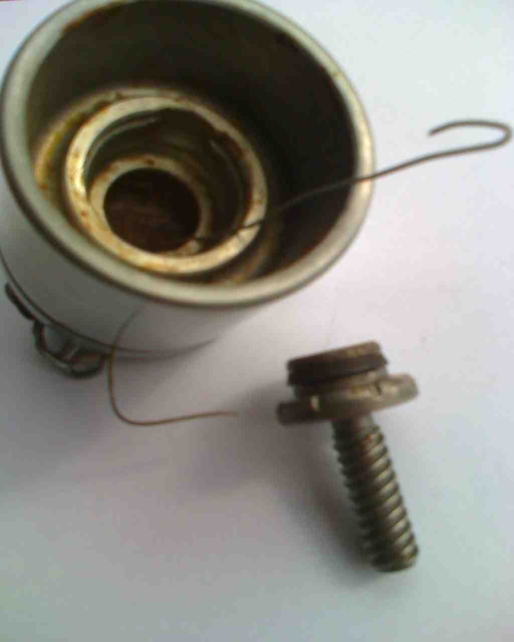

urzica
- Posts: 7
- Joined: 27 Nov 2011, 09:35
- x 1

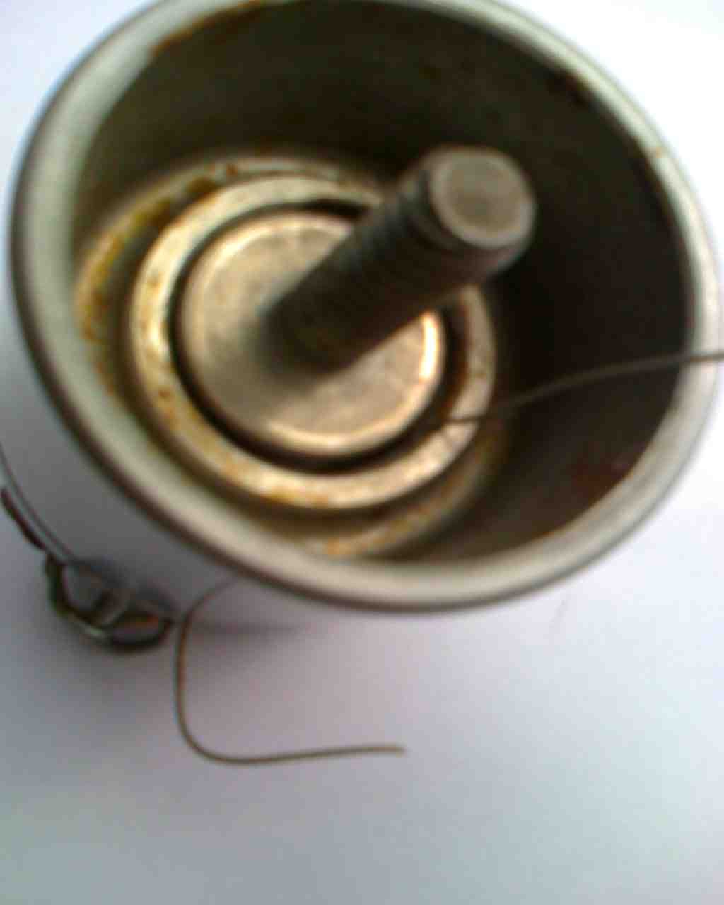

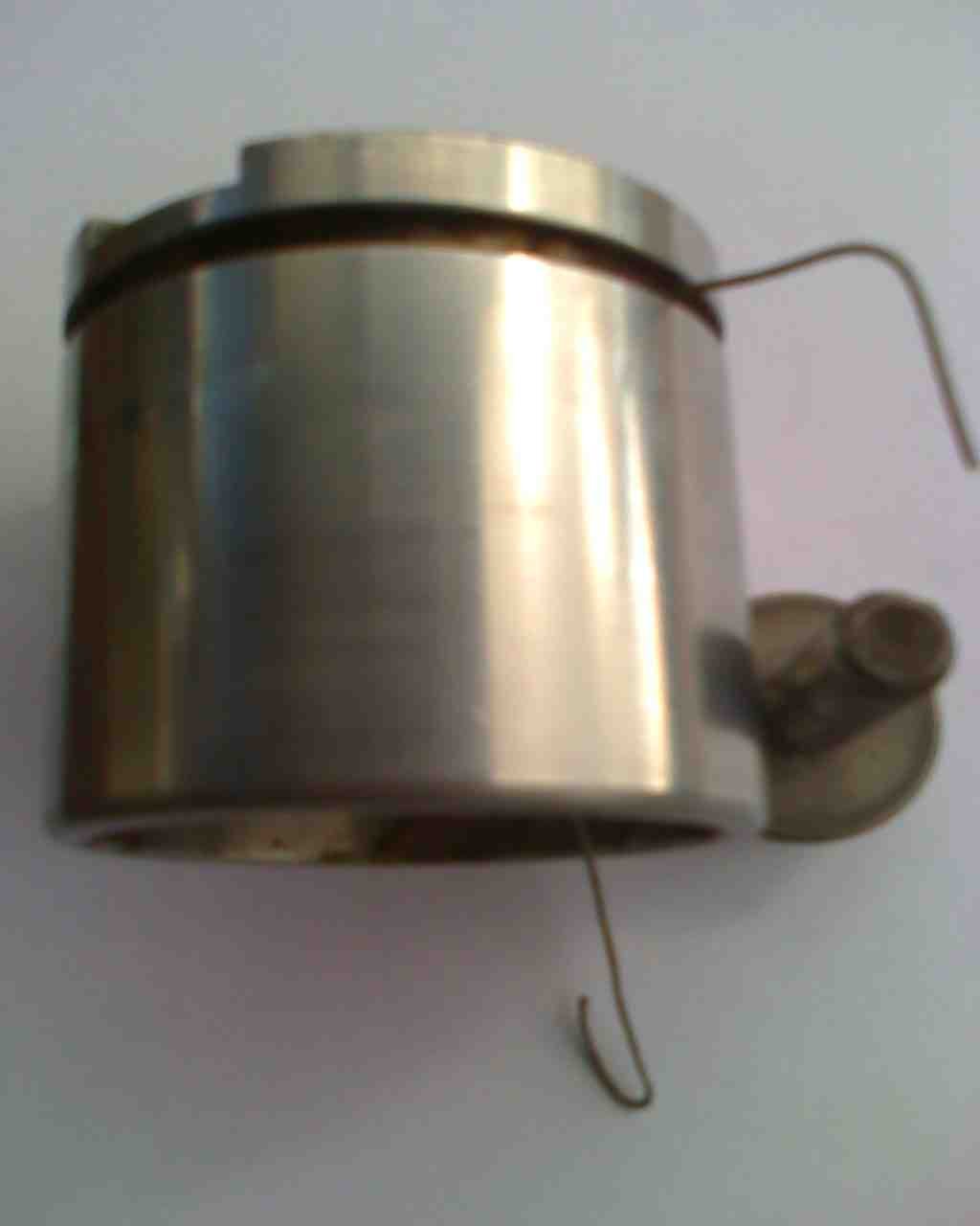

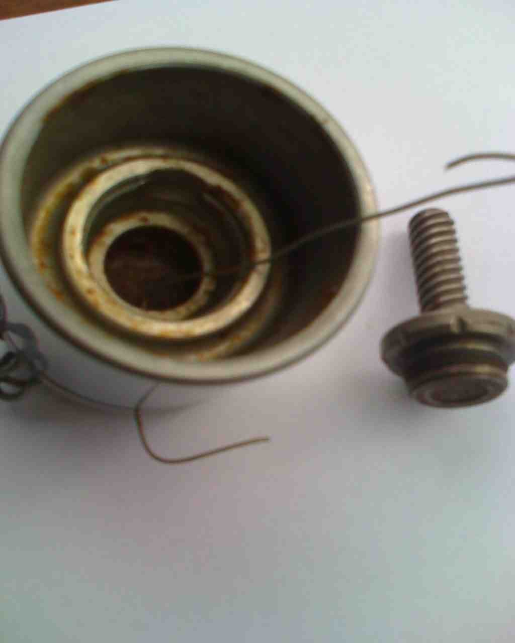

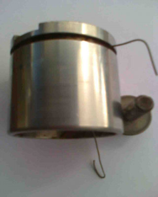

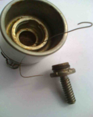

Re: Citroen C5 - N/S FRONT BRAKE CALIPER PROBLEM
This is a picture of inside piston mechanism. There is a breather orifice in the piston wich need to be cleaned in order the piston to retract away from the brake pads
You can see the wire thru that breather hole
