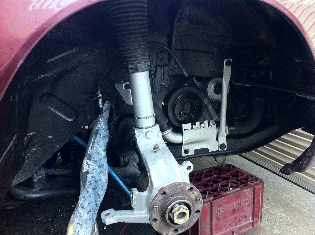

Here's how it looks with it's struts in place. I forgot to put the drop link in place before slotting the strut into the hub carrier, I haven't bolted it all up yet and as you can see there's a healthy smear of copper grease on the bottom of the strut so it shouldn't take much to pull it apart again.
I managed to flare the brake pipe using a machine mart flaring tool. The Flare isn't perfectly symmetrical so I'm going to have to keep an eye on it.
Steve.
