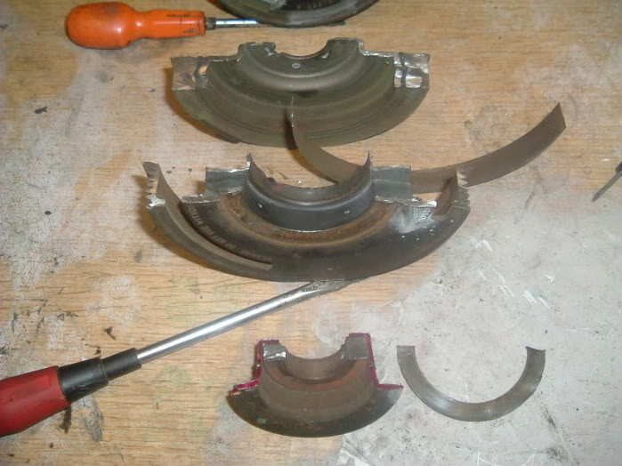

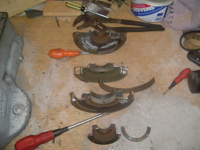

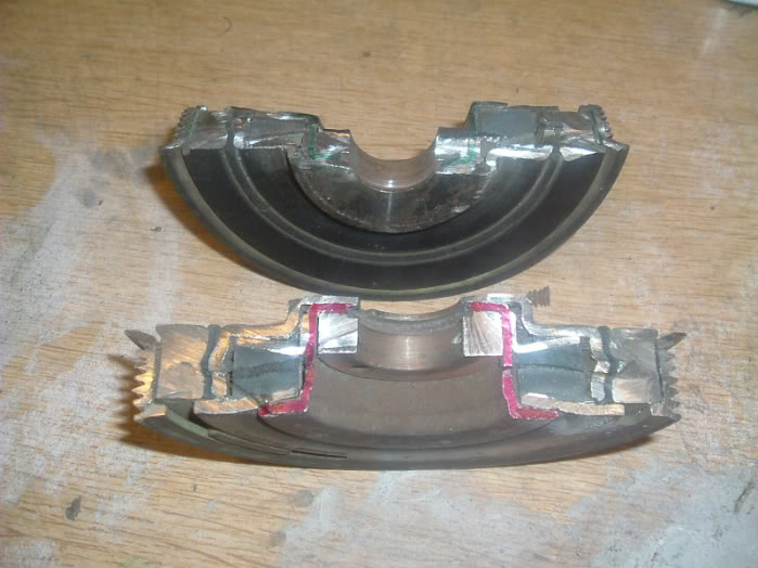

After all the hassle that pulley has given me, i gave it some serious payback :twisted: - plus i'm just nosey and wondered how it fit together...and Mr Grinder was looking bored..
@ Xac, here's how it's set up:
I'd guess it's the large metal shim type thing,near the rear that rusts away more than it being the rubber at fault? It's well rusty, and thin...?
Cheers all, Dave.

The crank pulley should be F tight BTW - something like 60ft lbs PLUS 60°. With loctitie! You don't want it to work loose, so it might be worth re-torquing it - and consider replacing it - a new one is a couple of quid from Citroen and comes ready loctited. If I remember I'll look the torque figure up later.

I agree with Richard, I'm sure the IDI crank pulley bolt is a stretch bolt and should not be re-used. I think they're about £7 from Citroen and come with threadlock applied. It'll be worth cleaning and chasing the crank thread before refitting too IMHO.
