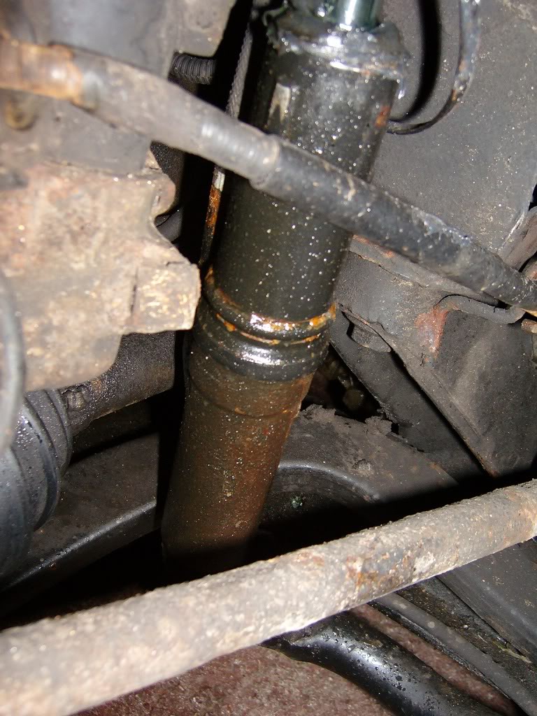

And here's the ram, is there supposed to be what looks like molybdenum (typo?) grease under the ram gaiter?
Cheers.

That looks like silicon sealant to me - my Molyslip grease is as black as coal!Dommo wrote: And here's the ram, is there supposed to be what looks like molybdenum (typo?) grease under the ram gaiter?
