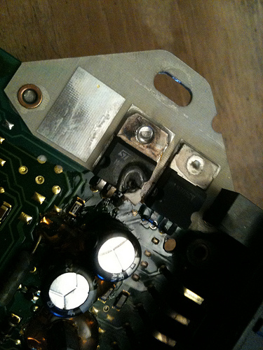

i did the diode fix, and rechecked the fuses, turns out i was checking the wrong fuse (cos it was dark), the hydractive fuse is a 20a fuse, in it's place was a 5a fuse?!? So I put a 20a fuse in it's place and I hear click/hiss coming from the hydractive ecu, followed by a "smell", oh dear, i am opening it up now, I will post pictures of any damage.
I reckon I've ballsed this one up!

Not necessarily Dei,
The first signs were very hopeful...
See what has fried and then work from there. It might need a bit of drawing of the circuit around the VN05s to see what is going on. The, with a meter and maybe a 'scope, a bit of diagnosis may be done...

Now who was it that said that a faulty VN05N can bring down the BUZ11?
I assume it acts as a fuse, isn't it a power regulator or something?
I think it's my dodgy soldering to be honest, cos the path that leads from the 'destroyed' pin of the BUZ11 leads directly to a certain outer pin on the VN05N's, and I am sure f00lz mentioned something about contamination to the solder and that it would cause problems later....
RS don't have their BUZ11's in until the 20th of January, I did order them with the vn05n's but i cancelled the buz11's in case it would delay my order, turns out like i need them after all, i will try soldering one back in, and tidying up my soldering of the vn05n's and see how it goes next time, we're talking end of the month now. The vn05n's still look ok though, can't see any more burning on the board.
But I should have check those fuses properly in the begining, but it does make you wonder why a 5a fuse was there in the first place. What a great start to the new year!

Hi deian
The BUZ11 is not a regulator. The L4705 (5volt) regulator is on the pad next to the BUZ11. The L4705 is a special very low drop voltage regulator and should not be replaced with any other generic device. The reason for this is that when the starter is engaged the battery voltage can drop as low as 6volts for a few seconds. Using a L4705 keeps the ECU alive while the starter is engaged.
The BUZ11 is a power MOSFET high speed switch.
The VN05N are solid state (electronic) relays and the BUZ11 is the electronic switch that operates those two VN05N relays. MOSFET devices are one of the most static sensitive electronic components. They are more likely to be killed by using an unprotected soldering iron on the ECU than by the VN05N's malfunctioning in service.
It looks to me that your BUZ11 has burnt out where its earth pin is connected to the main junction. This would happen if the BUZ11 went dead short.
Most soldering irons are direct feed from the mains supply and are not suitable for use in a static sensitive environment. In that case an isolated soldering iron (as you see in some of Jim's electronic photos) is typically used along with an earthed bench surface to work on.
The holes in printed circuit boards are usually through plated so they are better cleaned out with a solder sucker as drilling may damage or destroy the through plating.

don't be sorry john, all my fault really, i've been looking at my soldering thorugh a magnifying glass and a strong whit led light and it's not as tidy as it should be to be honest, i really should equip myself better, i understand the theory about the feed going through the soldering iron, and it does make sense, i secretly hope it's my bad soldering, and if i tidy it up that a new buz11 might work next time round, if not i will be hunting for a new hydractive ecu, pointless having the vsx spec car if the suspension isn't working correctlyxmexclusive wrote:Hi deian

i have ordered some now, even if it doesn't work at least i will have some spare to hand out to forum members if they want some, they are on back-order by RS and are available on the 25th of january now, thankfully the L4075 is still intact and they don't seem to be available now.
am i right in thinking that my shabby soldering caused a short in the buz11? there is a path that goes from a certain pin from both the vn05n's over the top (along side the connectors) and down towards the buz11's source pin.
