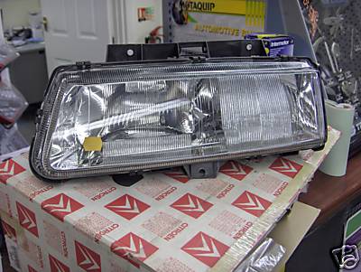

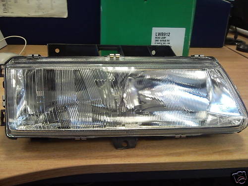

Which lenses do you have?
Image or Image

Both of those lenses are original Xantia Mk1. The difference in light output is significant. The later one on the right has less fluting and more light actually gets to the road (on low beam). The change happened some time between mid 95 and mid 97. It is possible that they both have the same part number.

I think in one of my previous threads on headlamps, Kowalski said that the early S1 xantias had the poor design/performance headlamps fitted up to late 1994.
As Xantia-_v6 says, you should study the subtle differences in the lenses lines/markings in the above pics very carefully when checking against your headlamps. I've just been given headlamps off a P reg xantia, and one of them was one of the old design, despite car being built 1996 - the owner had no idea.

I am not sure, but I think that this lens change was additional to the 94 redesign. I am sure that 1995 cars were manufactured with the heavily fluted lens, and from memory, the Citroen service site does not show any change in part number after 1994, hence my theory that this was just a component improvement with no change in P/N.

well i went out earlier and had a look when i git back they are the earlier type with the heavy fluteing, i'll have to see if i can find a set of later type glasses,

The first design of headlight with the poor lens was produced until RP 6442. i.e. 30th June 1994 so 'M' reg is the latest Xantia that would have had them fitted from new unless it was a very old stock car when first registered. The vast majority of these cars fitted with these lights would have been "sinkers".

DickieG wrote:The first design of headlight with the poor lens was produced until RP 6442. i.e. 30th June 1994 so 'M' reg is the latest Xantia that would have had them fitted from new unless it was a very old stock car when first registered. The vast majority of these cars fitted with these lights would have been "sinkers".
Despite the Citroen documentation, that is just not what is seen on the road. My May 95 VSX had the heavily fluted lenses, and I am quite confident they were original, and all M reg cars and many P reg cars seem to have the heavily fluted lenses.
I have read on this forum of early Xantia headlights having an internal plastic lens. I have never seen such a headlight on a Xantia. Did they exist? and when?
I beg to differ as both I and my Dad each bought brand new Xantia's in 1995 (N reg) and both had the later headlight lens, as does my present P reg VSX (built 5th July 96) whereas an L reg 94 VSX I also owned had the earlier (fluted) lenses and they were awful by comparison.
The only explanation available is that either the car's you mention have had their lights replaced due to breakage or were very old stock when first registered and on that note I recall that when I bought my new SX TD in 1995 being offered "new" Xantia's that were over a year old at a very large discount.
