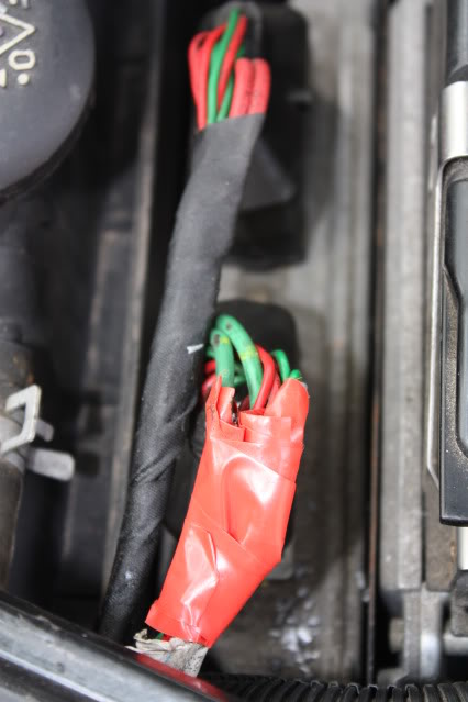

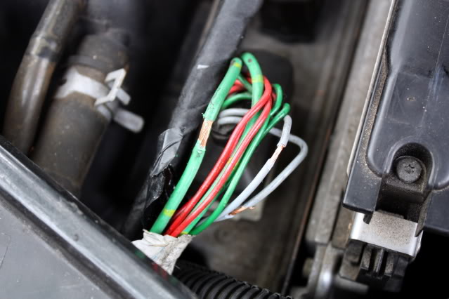

I have done the diode bit but it still does not seem right to me.
Should i go for the corner spheres next or do you think any other ones.
Any input would be gratefull for..
