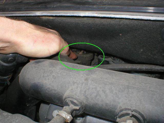

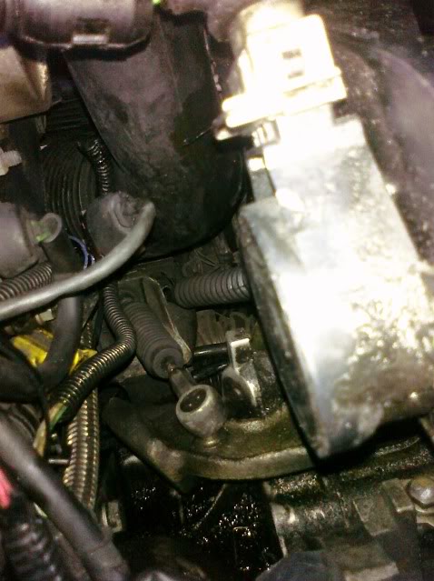

One thing that Dave did not mention in his procedure was the need to keep the master cylinder reservoir well topped up. This takes normal brake fluid (not LHM) but access is poor.
It is up under the bulkhead. This shot shows where it is on an Activa, which uses the same clutch and is just as inaccessible as a 2.1TD. The reservoir cover should clip off...
Good luck and I hope this has a happy ending. The 2.1TD is a very good model and worth getting fully sorted out. I had one for a long while.
