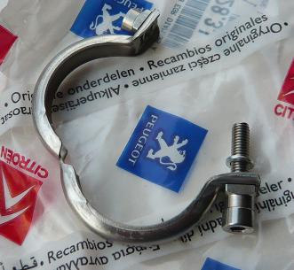

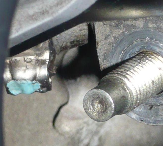

OK so I've progressed to the point now where I've found that I'll also need to remove the clamp that holds the connecting pipe onto the side connection of the ERV.
The original clamp is a V type clamp (see picture).
I've obtained a replacement clamp from the dealer (see second picture). The replacement part has a screw fixing instead of the original type of clamping arrangement.
The clamp cost about a tenner (bit expensive, I thought). I've also ordered a gasket for the front face for about 50p.
Funny that they had the clamp in stock, but they don't have the gasket or the valve. Does somebody know something?
