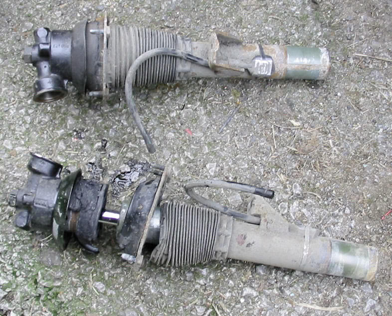

Another "speared" Xantia strut top...Check YOURS!

Whoa. NOW I'm scared!
I dread to imagine the damage caused if this happens at speed. Such a thin collar of metal holding the front up, surely a potential deathtrap.
Definately calling in my local(ish) cit independant tomorrow morning. I only hope he can do it before Saturday, I have a 200 mile trip due!

people definatly need to check them from underneath as mine look fine from above but underneath there is signs that it's going to go, just passed it's m.o.t today as well so don't expect an examiner to spot if it's about to fail.
the offside on mine looks far worse than the nearside gaitor is at halfmast ect so i've ordered a new one from the dealers @ £109.00.....ouch, i think i'll go ahead and order the other one though just to be sure as it can't be far behind the other one, is there some kind of fastener that holds the gaitor on or does it just push over the lip on the rubber

When you think about it, it 'calms' the excitement of driving in a 'spirited' manner in a V6 or Activa...
I've caught 5 [3 Xantias & 2 Xm's] now before they've failed and seen two actually fail [one an Xm and another the VSX Xantia].
The Xm 'popped' as I was pulling away from the kerb outside the house at low speed; the Xantia damaged a load of it's nearside panelwork as well as the bonnet 'landing' after the offside strut went when it's wheel slightly struck a glancing blow against a highish kerb...
I personally feel this IS MOST DEFINITELY a serious issue on these cars and IT WILL cause potential DANGER unless the strut tops are thoroughly checked regularly.

What's crap about all this state of affairs is the corner-cutting cost scrimping by Citroen for the sake of some decent weather protection or thicker metal. There's a swedish kit for reinforcing Xm strut tops BUT this will restrict the rubber movement of the strut top.
It REALLY does move a lot on the crown in a poor man's ball joint fashion - get someone to steer the car from lock to lock when the bonnet's open and see the tilt of the strut top in relation to the bodywork...

D.Slatford wrote:Oh, is this problem common only to Xantias? Was there any similar mass failure on the older BXs, XMs etc?
On this Xm, what's interesting on revisiting the pictures is the fact that the rubber is torn away without the metal appearing to be noticeably rusty!

Yep, thats quite normal in many countries including NZ.andmcit wrote:On this Xm, what's interesting on revisiting the pictures is the fact that the rubber is torn away without the metal appearing to be noticeably rusty!
There are TWO modes of failure for the strut tops - metal plate rusting away, and the rubber block cracking, perishing, and then shearing away.
Some countries - notably the UK, seem to trigger the rusty plate mode of failure well before the rubber gets time to perish.
I guess the cold temperatures
In other countries, including NZ, Australia (?) and more tropical regions like Malasyia, the metal plates seem to be just fine (I havn't seen a rusty one yet) but the rubber block perishes at an accelerated rate, perhaps due to higher temperatures and humidity. (Although the later seems to discount Australia which is generally less humid than NZ
One of the problems with the way the bracket plates and the rubber block are designed is that the upper and lower metal supports DONT overlap, which means that the rubber block carrying the weight of the car is subjected to SHEAR stress all its life instead of COMPRESSION stress, which it would have if the plates overlapped a large amount.
BAD idea. If they overlapped not only would the stresses on the rubber be mostly compression instead of shear, but if the rubber did fail, (which it probably wouldn't, under compression) it would prevent it from spearing the bonnet.
Not only that but the rubber blocks have deliberately designed weak points to allow them to pivot like balljoints (try turning the steering from lock to lock and watch the strut tops tilt 10-20 degrees!!) so it's little wonder they fail.
I'm apauled that mine only lasted 8 years before they were showing signs of imminent failure. Possibly the single worst piece of design that Citroen has ever done...

Round my way, there's never any grit but PLENTY of rain! South Wales [the UK one!!
] INVENTED rain - in fact it's one of Wales' main exports!
This is great for damp conditions that'll allow the metalwork to do it's thing with rust degradation. Thing is the rubber actually gave up on the Xm pictured! Can't say it's EVER been that humid/hot to ruin the rubber...
Yes, a totally rubbish design by Mr Citroën - F - could do better - BACK TO THE DRAWING BOARD.

Hard to give an exact answer on this - as so many factors influences on this problem.
No doubt a low mileage car would suffer this problem as well. The problem is more related to corrosion/detoriation from weather & road environment - than it is on the mileage the car has covered over time.
On the other hand - the more mileage the more mist from the road it will have suffered. Time is an important factor - as the problem starts from day one on the roads - or in the driveway.
But thats certainly no different from other cars not proteceted against rust & environment. The difference is the dramatic consequences on XM & Xantia - as you can see from above you get no warning

I guess if we work on the basis that the UK cars fail due to corrosion of the metalwork rather than the rubber deteriorating it would seem a good idea to put some durable hard enamel paint on top of the finish that Citroen use when it comes to renewal with replacement tops.
A regular jet wash of the whole wheel arch area with the car on high may be the only other alternative with originally fitted ones. I wonder if in fact a car being used regularly is going to fare better as the air circulation would help keep the strut top dry rather than allowing the damp to fester!
No, don't think there was a redesign on the Xantia though there was on the Xm.
