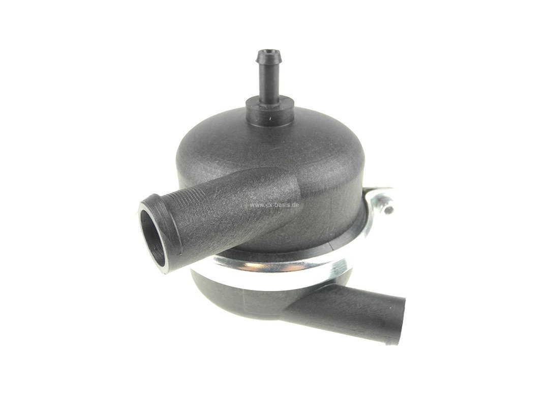

I need to start getting it ready for the WOF by June so that would be cutting it quite fine. I don't know what other work the car is going to need, or whether I can solve the ignition cutout problem, and I can't really test that until I fix the coolant leak.
A bit of Googling tonight has turned up this - it looks promising I think, and the angles look correct for the Xantia ? Is 11mm for the upper connector correct ? (I think the Peugeot version is much larger diameter ?)
https://www.cx-basis.de/dampfblasenabsc ... 20726.html
Please, nobody buy one in case they have low stock. :lol: Not until I have one safely in my hands at least.

I decided to go ahead and order this - 20 euros for shipping so all up around £50, I guess that's OK for a replica of a part that's extremely hard to find!
Any tricks to fitting it or is it pretty straight forward ? Is it bolted to the engine somehow or does it just hang on the rubber hoses ? Am I going to need to take the upper inlet manifold off to get enough access to fit it ?
If so I'll need to order some more paper gaskets as I don't think I have any left. Will also need coolant as I'm going to lose a lot removing it and might as well do a full coolant drain and change as part of the job.

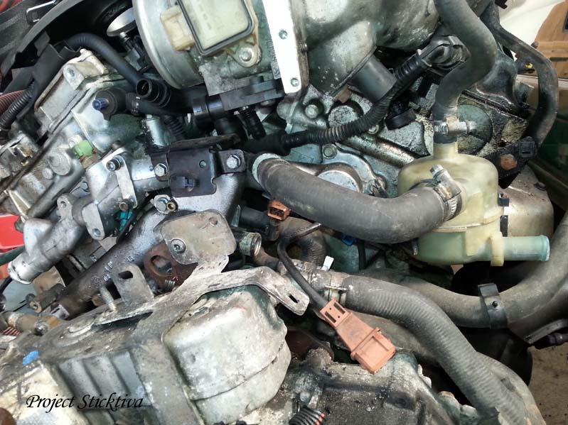

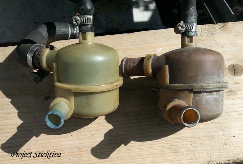

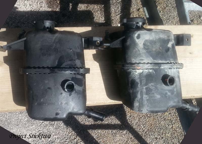

Stickyfinger wrote: 18 Jan 2017, 12:53 These are the hj coded parts, nearly new and old....the OP image is not for certain...fitted and the matching expansion tank (for the Xantia)
Do your rubber pipes match those shown ?
The middle image shows one end of the spring clip that holds the degassing tank.

The replica I've ordered shows some kind of clamp around the middle - whether that's actually holding the two halves together I don't know, but I presume it will fit the spring clamp that is attached to the motor....
Given how impossible the original is to find I guess I'll just have to make it fit.
