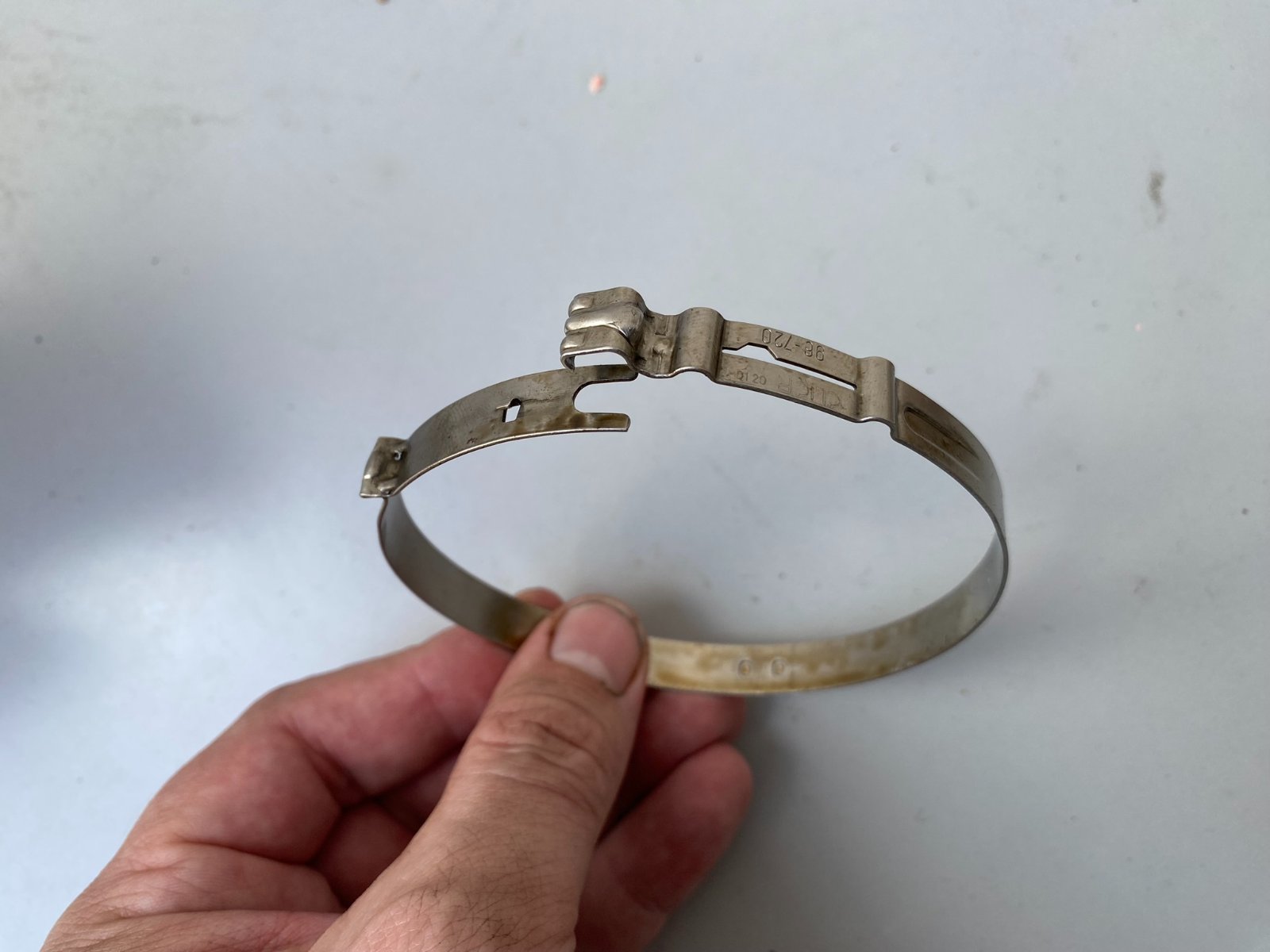

Can anyone tell me what circlip pliers I need for this clip on the sump strainer ?
I somewhat foolishly disconnected it to clear some chunks of rubber from the strainer thinking I could get it back on again with a normal pair of needle nose pliers but no, can't do it.
When I look for circlip pliers online I can't find any that look like they would fit, and I don't know what I'm looking for by name.
Any ideas ? I'm now stuck until I can get this silly clip back on. Well, not completely stuck, I'm still yet to clean and degrease everything so I can apply the new sealant, but I won't be able to reassemble until I can get the clip back on.

Never mind, I got it!

'R-clip' pliers but I've also used ceramic tile nibblers to good effect if you have some of those available .....

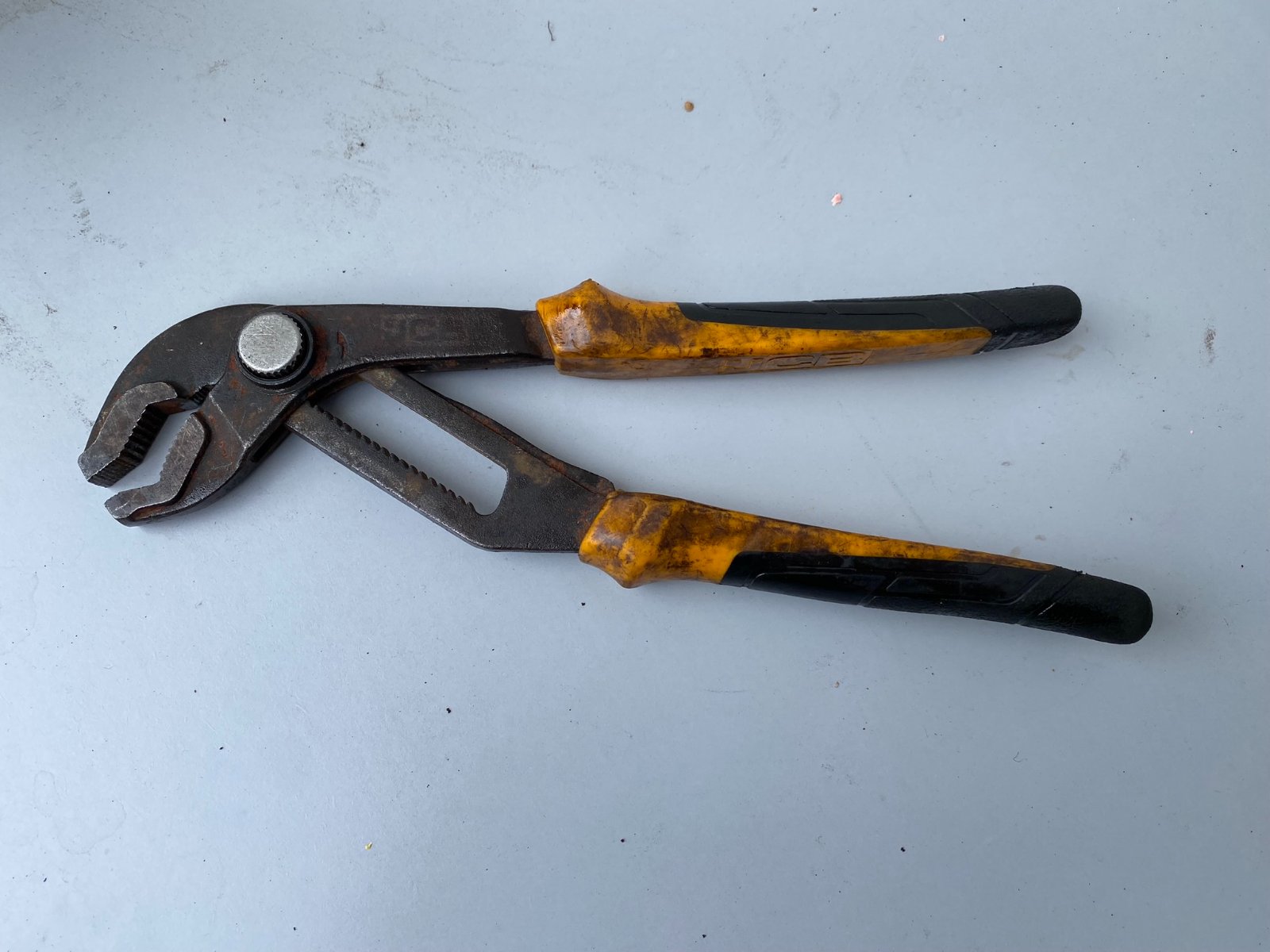

I used these - they did it with ease!
I didn't think the hook would ride up over the ridge just by squeezing them together with these but it did and it worked first try. On to the next bit of the job...

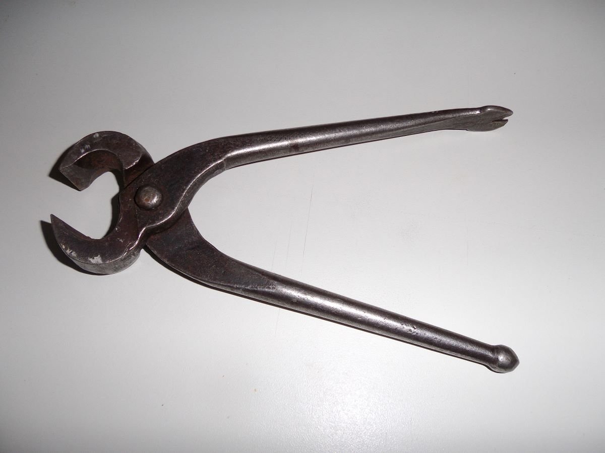

Re: Simon's new Xantia V6 and Leaf blog
Carpenter's pincers - the things they use for pulling out nails... I think... I don't do woodwork so I'm only assuming that's what they do with them...
I have a small pair that's just the job. Also good for driveshaft boot clips too...

If you mean these... they aren't a chippy, these are mainly used by steel fixers to tie rebar together with steel wire. Most chippys would use a claw hammer to remove nailsCitroJim wrote: 09 Jul 2023, 15:08 Carpenter's pincers - the things they use for pulling out nails... I think... I don't do woodwork so I'm only assuming that's what they do with them...

Yes, that's the kind of tool Ryan... There, I told you I was only guessing and assuming... Wood and me don't like each other. Very allergic to sawdust.
And paint and varnish...

These do the trick, carpenter's pincers.

That's the exact ones I was thinking of Eric
