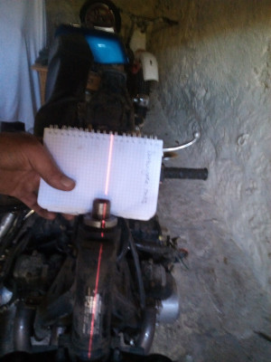

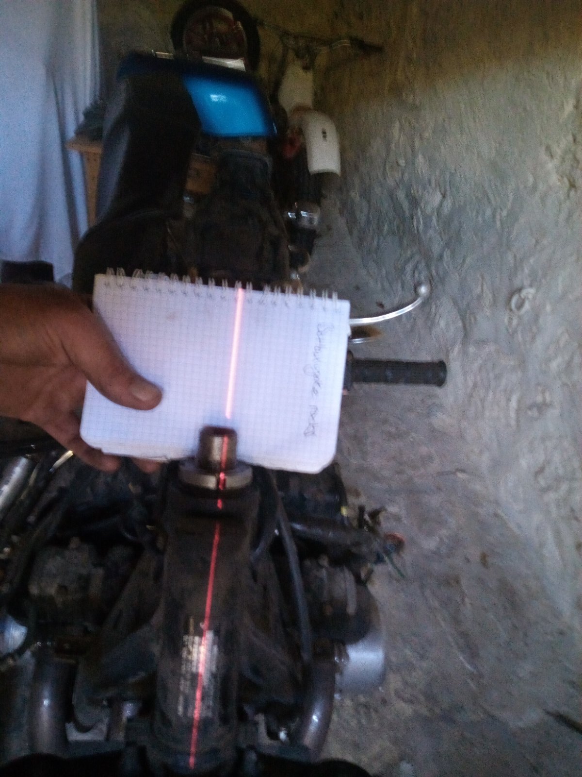

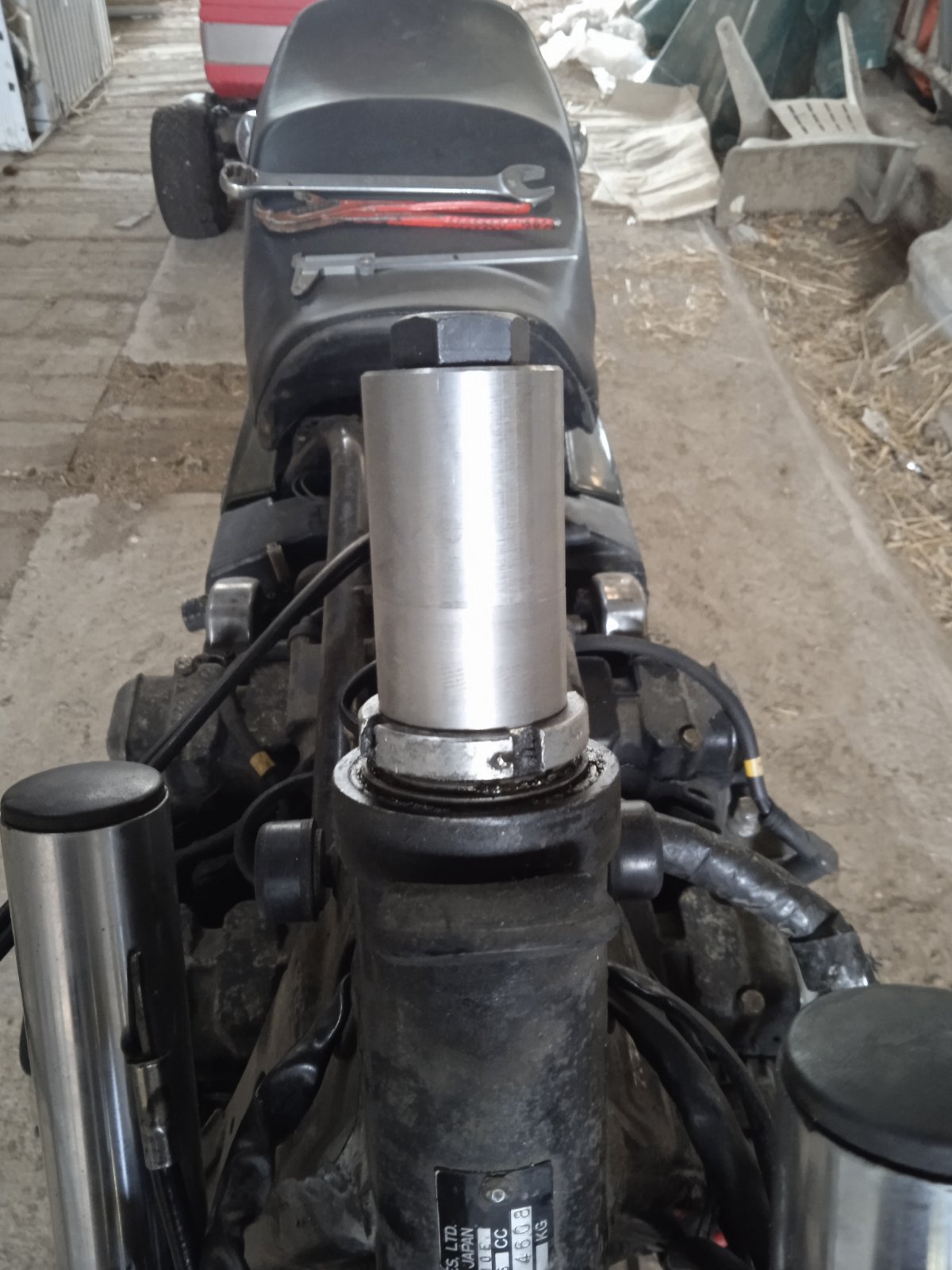

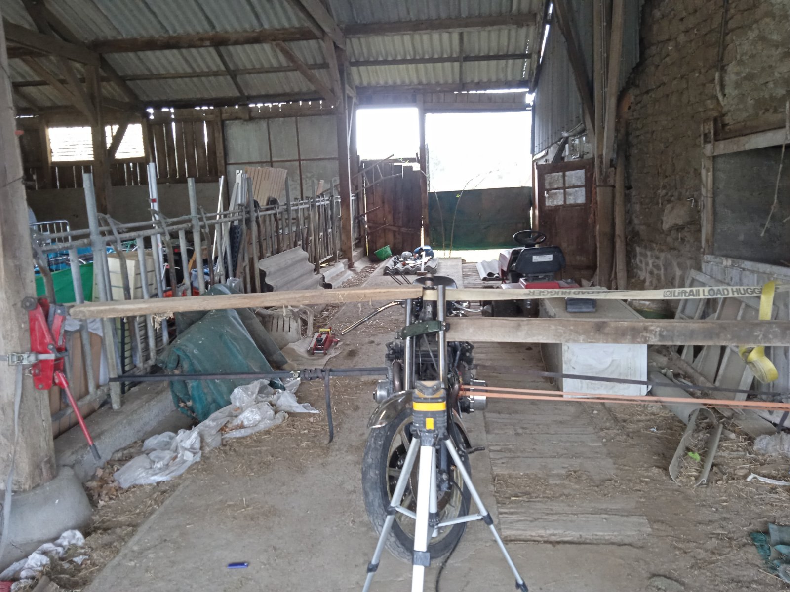

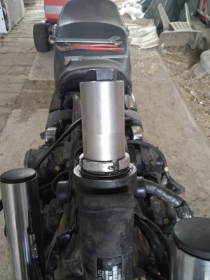

Well the special tool didn't make an entrance
The idea was to strap the bike up to walls then wollop the special tool with a sledgehammer whilst standing on a pallet lifted by a tractor to try to square up the headstock.
After more thought I came up with this
More controlled and I could see what other forces were being put on the frame so some re-positionng of ratchet straps was required.
Not spot on yet but gained 2mm.
The steering geometry was even worse now although wheel alignment had improved.
Bugger, the bottom yoke is twisted. one fork rakes 1 degree different to the other. Now that the headstock is better and after I removed the top yoke, front wheel and mudguard it was clear to the naked eye.
On the hunt for a set of yokes now......at least I know me method works

Excellent work Pete

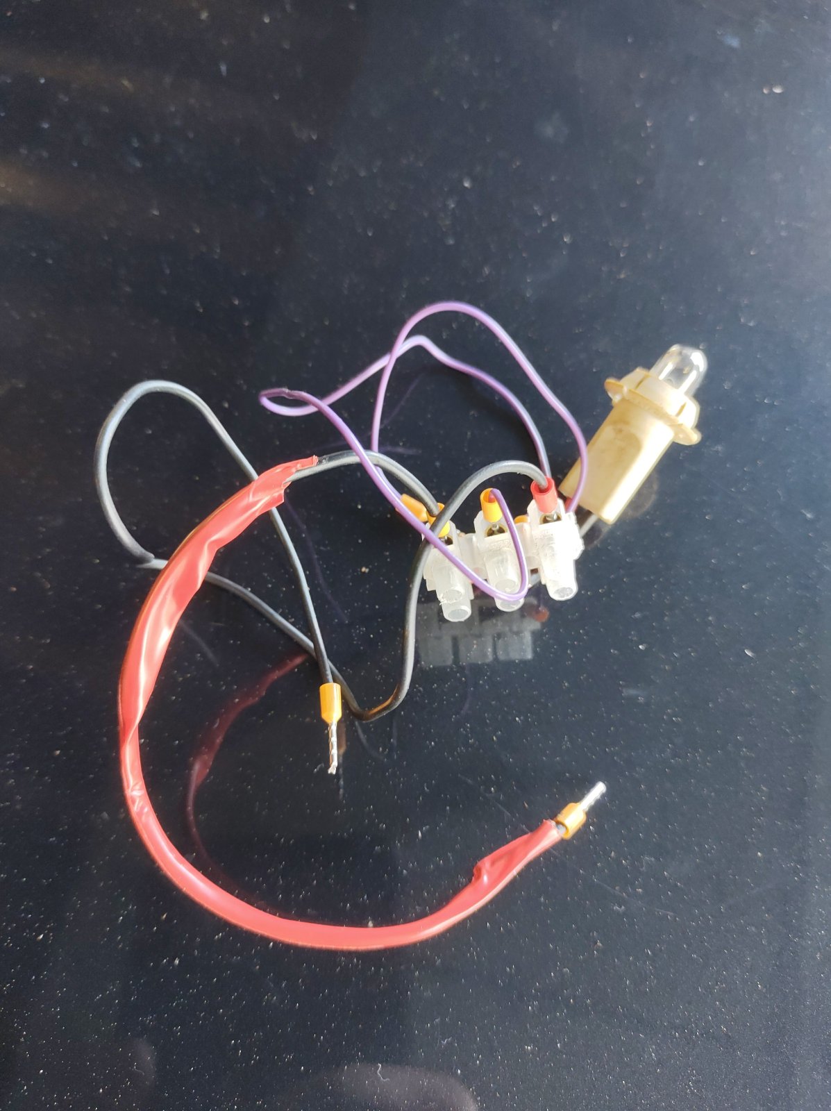

Your starter for 10.
No conferring please.
Is this....
A: A random collection of electrical bits found at the back of a drawer ?
B: A primary school project to show the basics of electricity ?
C: A highly sophisticated piece of diagnostics equipment used on a Mercedes ?
I'm sorry, I'll have to hurry you for an answer
More details over at.....
viewtopic.php?p=794651#p794651
Is this....
- Posts: 21202
- x 8128
Re: DIY Car Maintenance with function over finesse!!
A pulse flash detector?

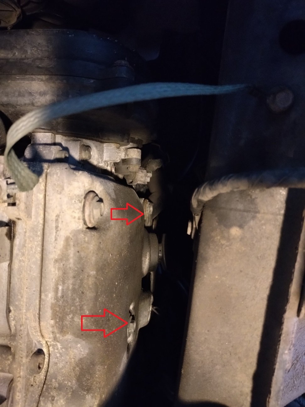

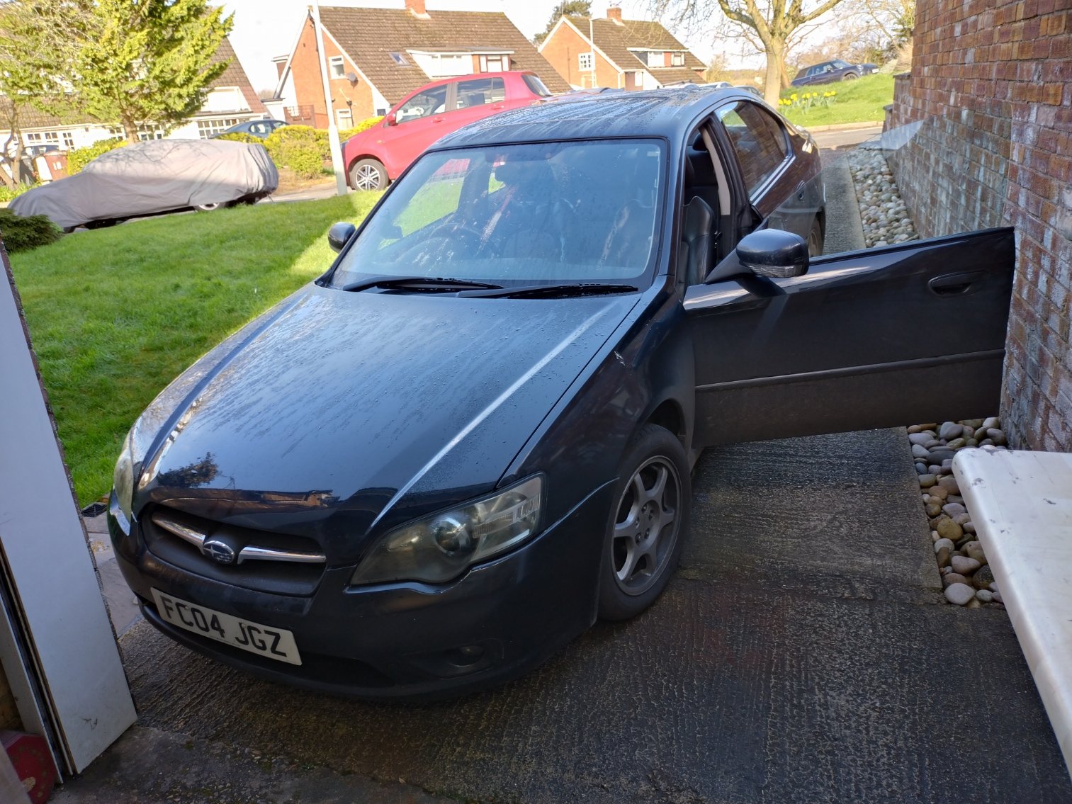

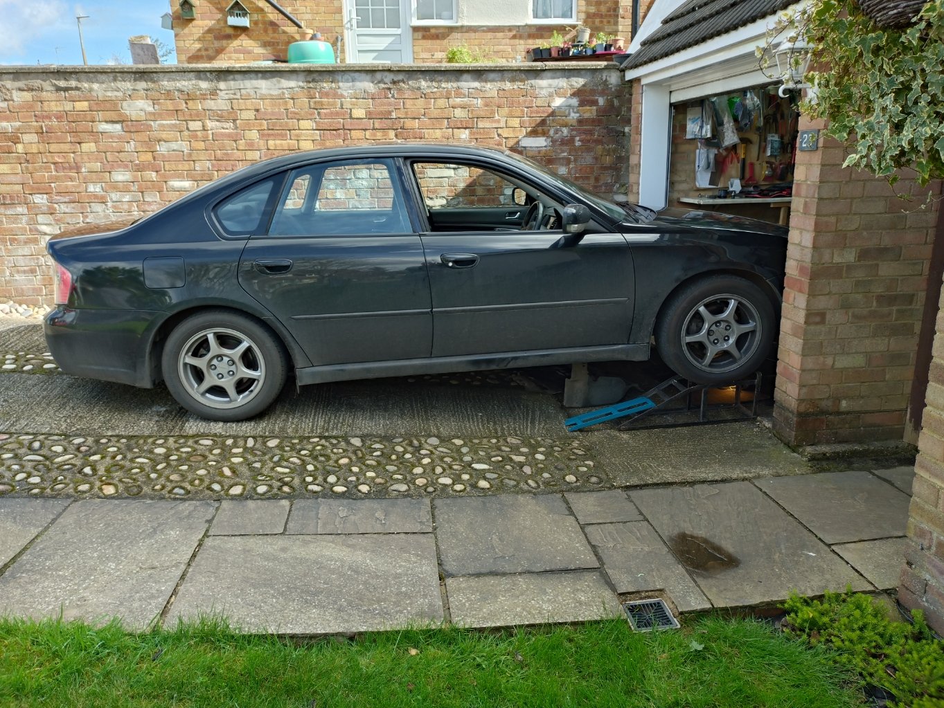

With the Wales Wander coming up fast I need to get the Subaru ready which means finishing the re bushing by doing the nearside lower control arm and give the car a full service. Unfortunately the track rod end for the nearside has still not arrived so I cannot get into that today, and I cannot do it here as there is not enough room to work on that side of the car on the flat part of the drive:
Knowing that would be the case yesterday, I called the dealer in Cambridge to check they had all the service parts I'd need and they said yes!! So I drove up there yesterday and when he went to get the air filter there wasn't one there!! It had been used by the workshop in the interim. I wasn't over amused as I had made the effort to call before going but he simply apologised and said he would have it delivered to me today by UPS. So far no sign but I got on with the cabin filter change:
and then put the car on the ramps which, with my drive, leaves it fairly level but accessible underneath:

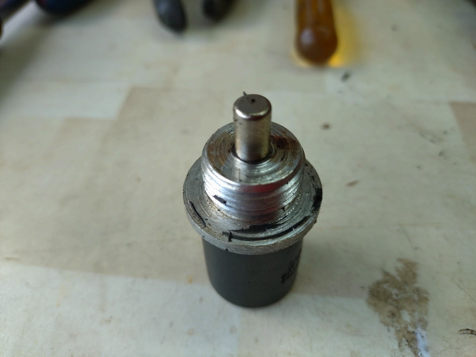

Under I went and removed the undercover, 3 x 12mm bolts and two body studs with the central pin and expanding surround. Drain tray in place and removed the sump plug which, coincidentally with Matt's order, is a magnetic one and I was very pleased to see it was completely clean:
The oil filter is too small for my trident adapter so it was a chain wrench but no problem at all. Replaced the plug with a new washer (£1.99!) and fitted the new oil filter and filled her up. Next job is to change the spark plugs which are not the easiest to get at:
So in view of that I came in for a cuppa and to post this much, hoping that the air filter will arrive soon as I have to remove the entire airbox to get to the offside plugs so it would be good to replace the filter at the same time!
To be continued............

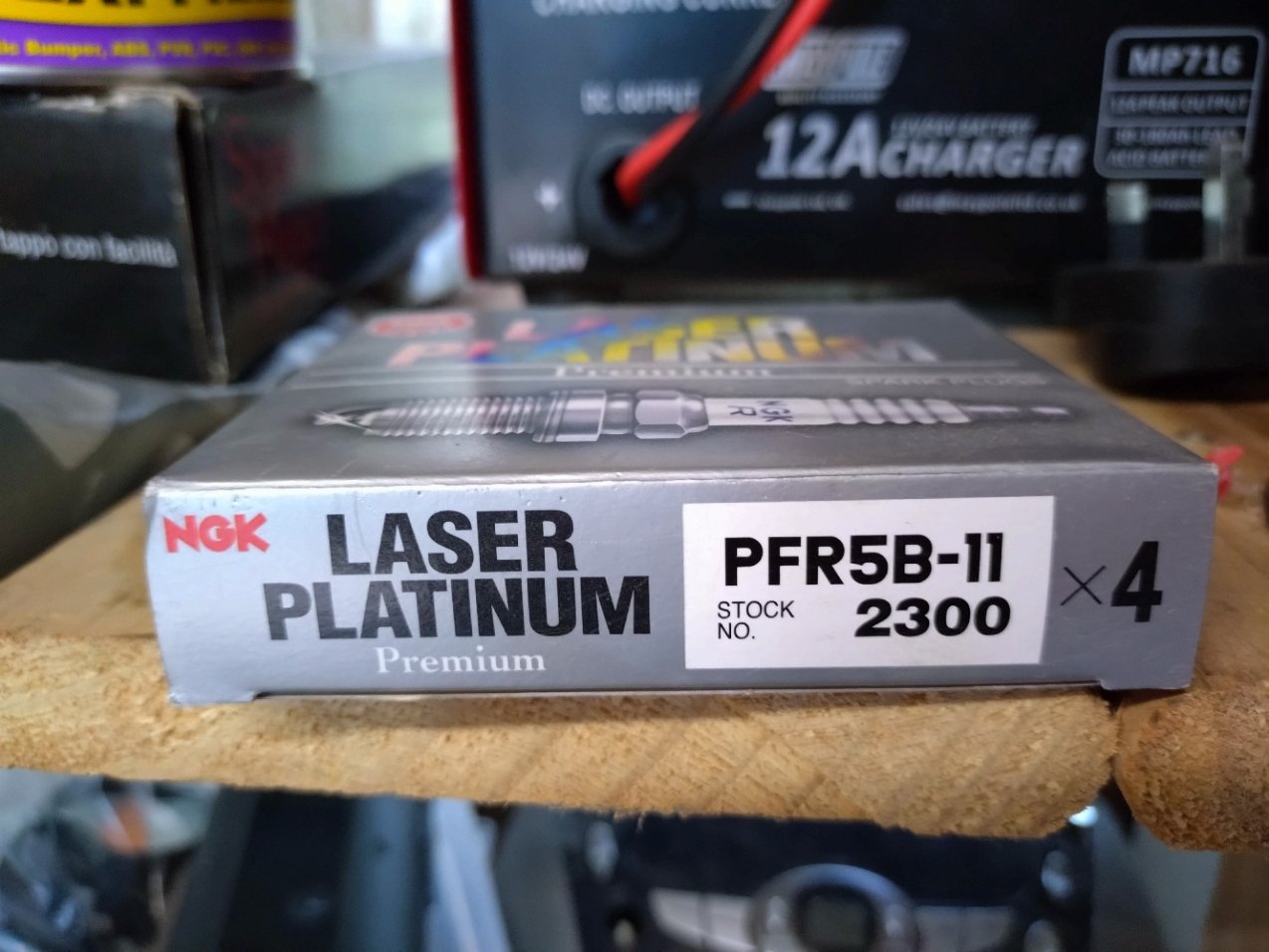

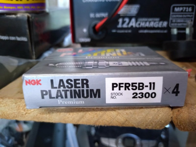

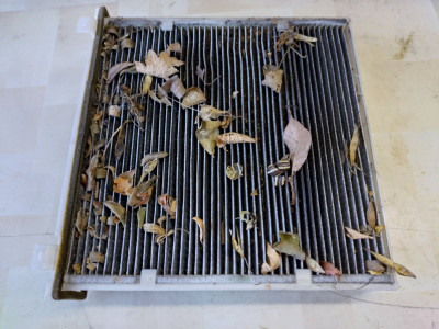

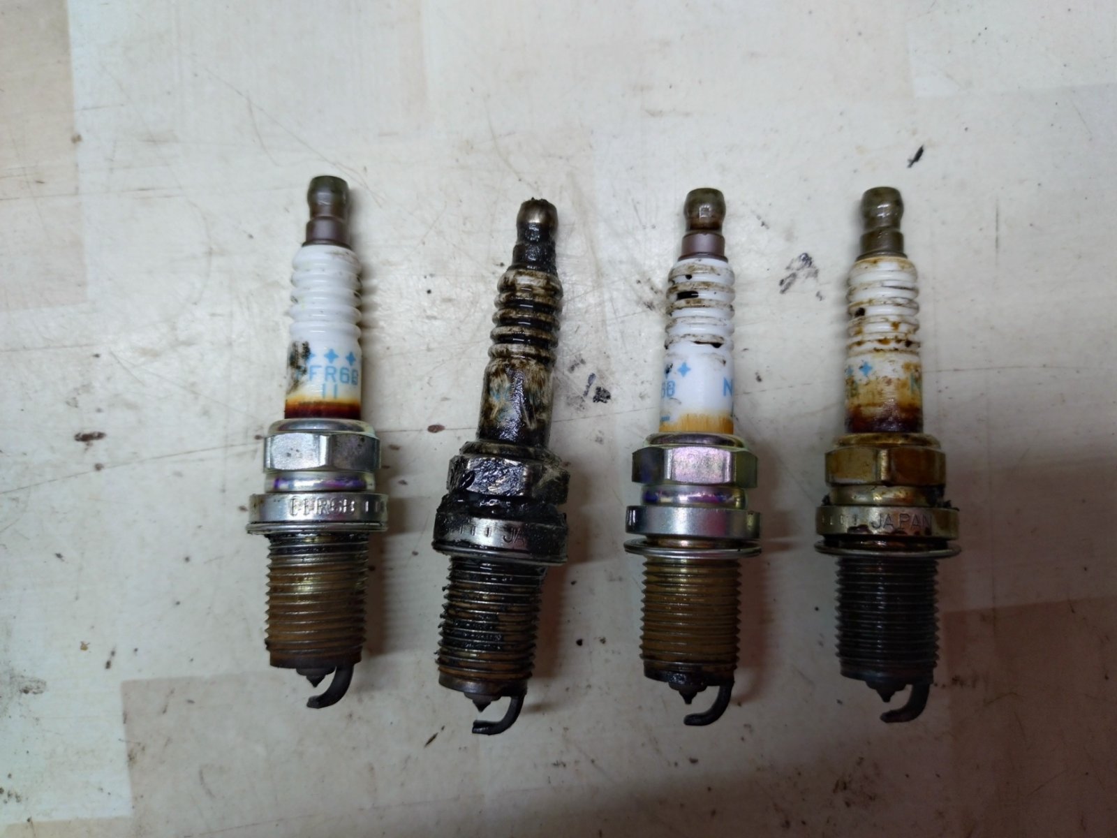

Well sadly the air filter has not arrived but I decided to attack the spark plugs anyway so all that will be left is the air filter swap, 5 minutes and of course the lower control arm. I was going to take the car to my mate's man cave to do the arm but he has been served a notice to evacuate as the building is up for redevelopment and now they have turned off the power. So I set about the spark plugs and for what should be a simple 15 minute job I can confirm that it is a real nightmare on this car. However I managed to work through it and get them replaced and methinks it's just as well I did:
In order to access the offside plugs I had to remove the entire air box so I was hoping for the new filter to arrive but, as it didn't, I was pleased to discover the existing one to be in pretty good condition. I gave it a good vacuum and refitted it in order to get the car back into service. I am pleased to say it started on the first turn and purred into life sounding a fair bit sweeter than before so I took it for a quick run round the block and was very pleased with the improved power and hopefully the fuel economy will be even better!!
So now just the nearside control arm to do which should be straightforward with my new super rattle gun and we will be ready for Wales!!

Those plugs
Good work so far Mick!

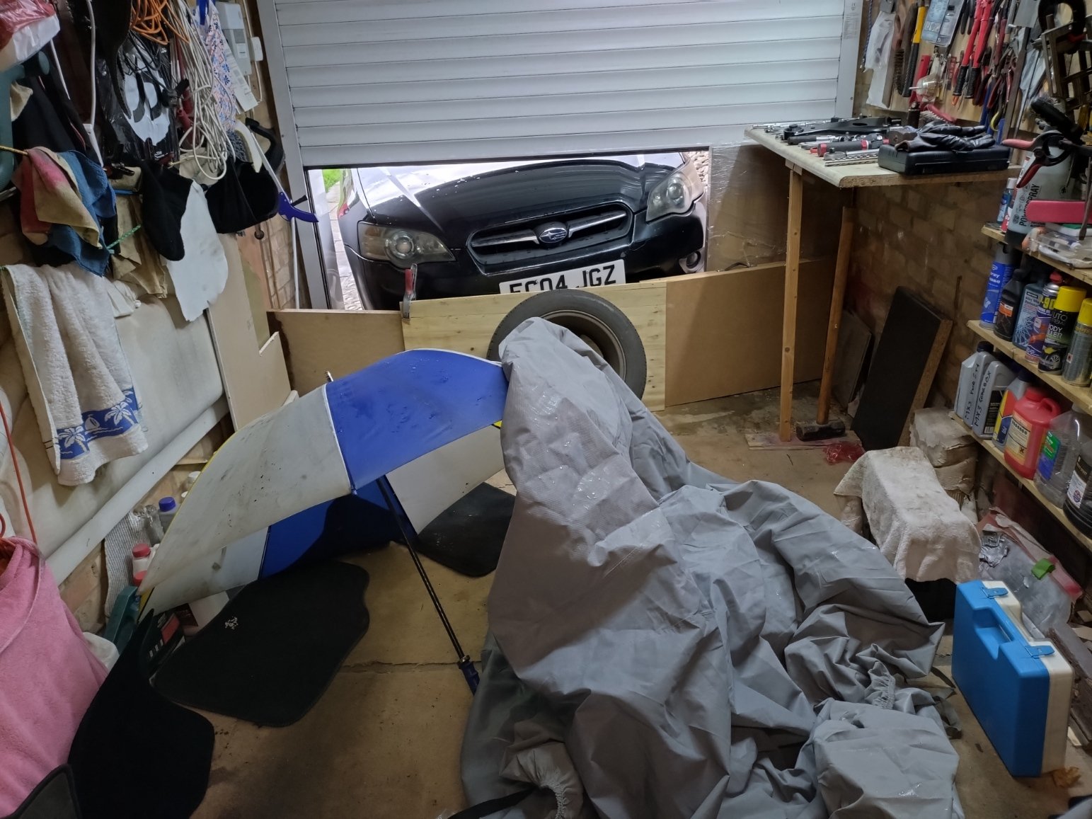

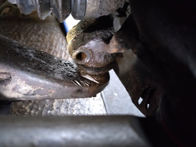

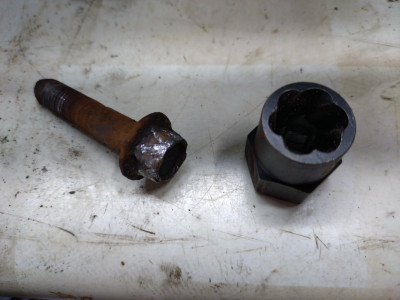

Well it dawned sunny and bright so I thought with my new super rattle gun to hand I would get on and get the nearside control arm and track rod end and ARB bushes done. I decided to park the car askew on the drive and do the job here as the lack of power at the man cave concerned me for battery charging, lighting and maybe the odd grinding need.
I jacked up the car and removed the wheel, inserted axle stand and got stuck in. The 19mm bolts and the 17mm bolt that had all given me a nightmare on the offside all submitted instantly to my new toy so I was happy about that. Before removing them I replaced the ARB mounting bush and track rod end with no issues at all. I disconnected the drop link with the new toy, no problem and then attacked the 14mm lower ball joint housing clamp bolt. I knew it was all going too well!!
It was now 10.30 so I popped in for a cuppa and to give the penetrating oil a chance. After tea a long arduous story followed involving various tools, blowlamp and much vocal accompaniment resulting in me having to jump in the MX3 and go and buy a set of twist sockets. Returning with them I tried the 14mm one and sure enough out came the clamp bolt.
Now all that was needed was to fully remove the other mounting bolts which I had loosened at the beginning and tap out the arm complete with ball joint from the hub clamp. Another arduous story followed punctuated by a thunder storm, a change of clothes, numerous tools being brought into action including a 5lb club hammer, my two 4ft pry bars, two cold chisels, a bolster and in the end my 14lb sledge hammer although not easy to make use of!!

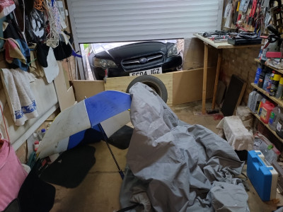

Suffice to say that my final decision was to wedge the clamp open with a jammed in screwdriver, soak the entire thing in penetrating oil and seal up the garage as best as possible including turning off the power to the roller door, for the overnight which I'm hoping will give me a fresh attack in the morning, providing its not raining heavily!!
Watch this space

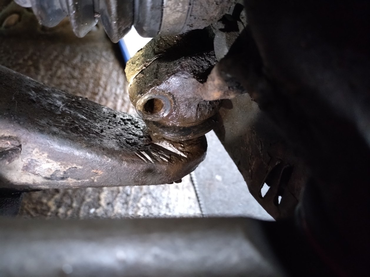

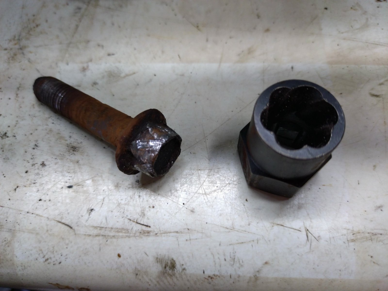

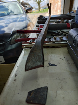

Sadly Jim your faith was misplaced. It was raining first thing this morning so I went to try and find a replacement pinch bolt. It's Good Friday!! The only option I had was my favourite parts and accessories shop in Watford, Midnight Motors, where I duly rocked up. Unfortunately he did not have the correct size and thread I need so I bought a couple of possibles which I may be able to use until I can get the correct one. They are over length so can be used with nylock nuts temporarily if needed.
I then called in to see my mate in Elstree to see if he had any better options which he did so I came home with three possible alternatives to use until I can get up to Cambridge for the proper one. So it was back to levering and hammering to try to release the ball from the knuckle. After 3 hours of many different approaches I had an accident which has never happened to me before!!

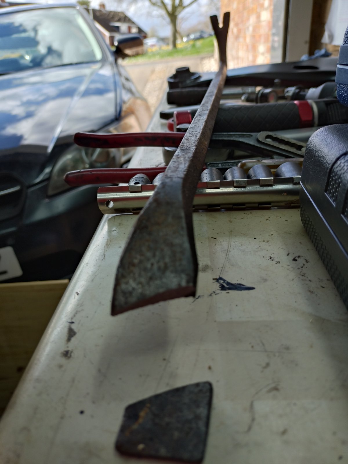

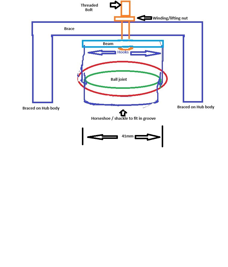

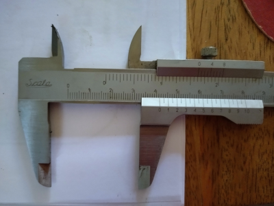

Clearly I am going to have to invent or create something to get this pest out so I can spend the hour and a half needed to insert the new parts and get up and running. By now I was physically exhausted so I came back in to put a few ideas together for a tool and I have come up with a poor sketch which does at least illustrate my idea. :

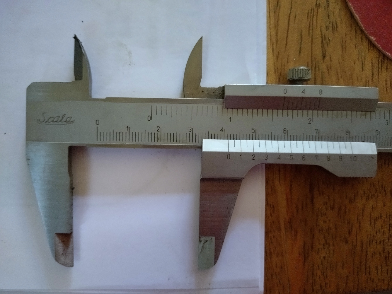

So with that general plan in mind I measured the diameter of the exposed lip of the joint to work out what I need to make it from:

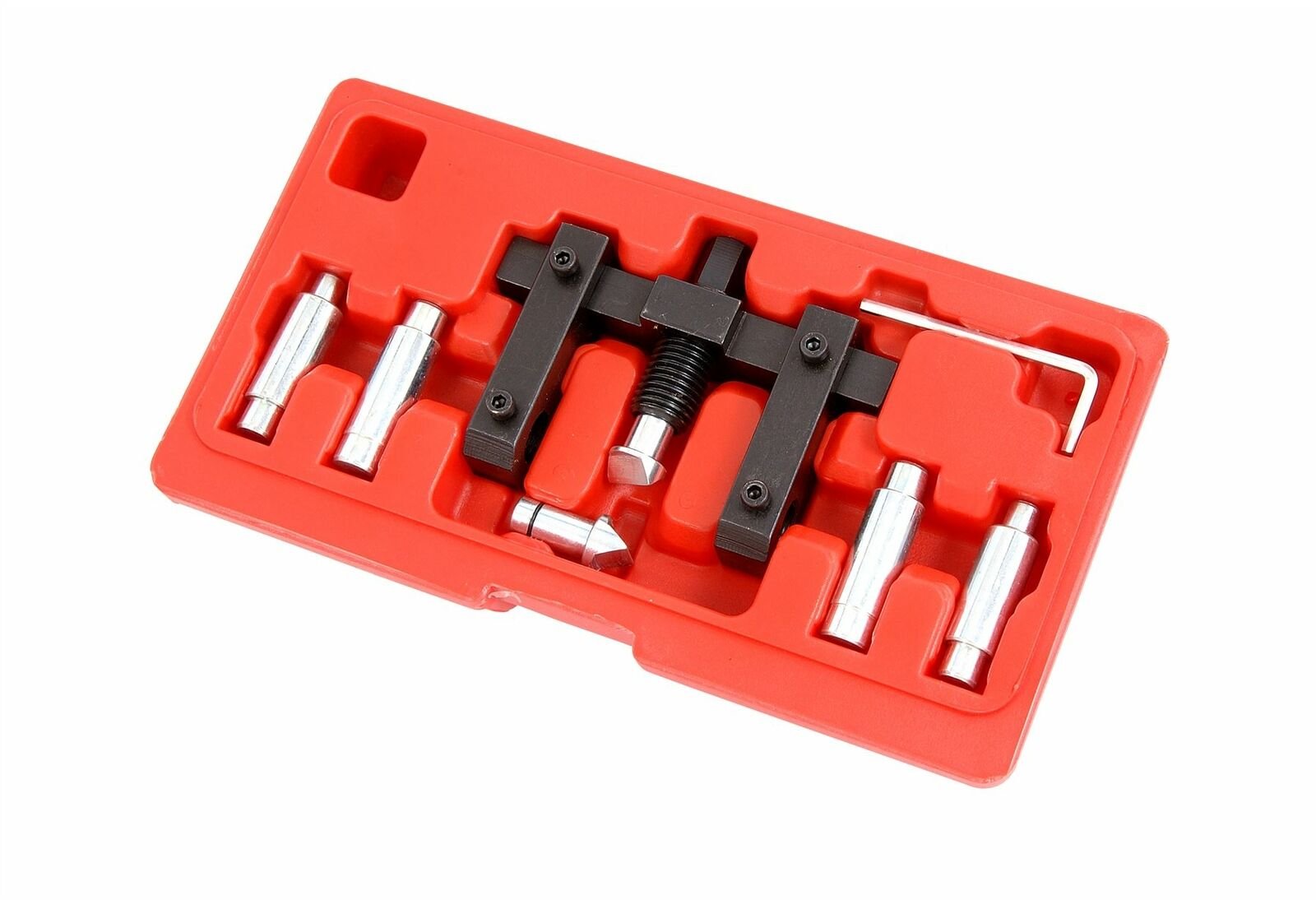

So at the moment that is plan B. Tomorrow with the shops open I will see if I can find a knuckle spreader tool like this:
and then with that in place have another go with the big hammer.
Watch this space!
