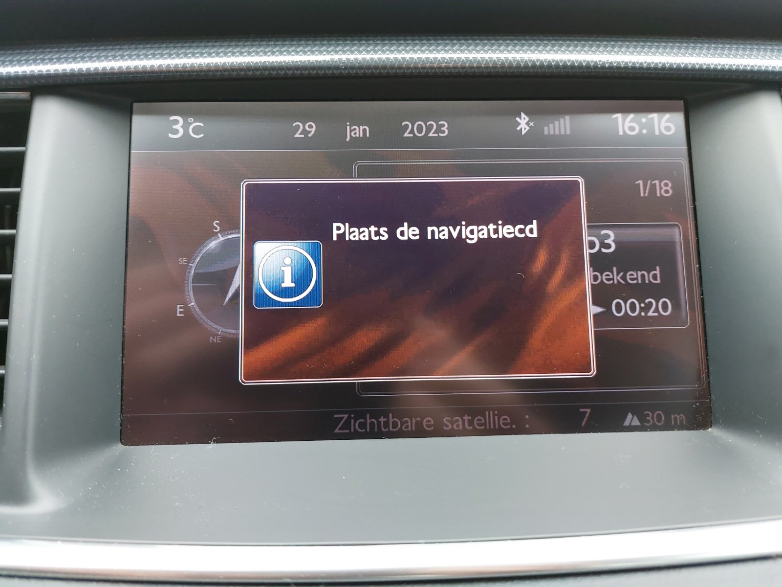

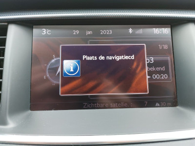

Re: How to Replace the Internal MicroSD Card - RT6
Hello Marc,
Peugeot 508, 2013
I'm currently receiving the ''Check in progress'' followed by the ''Insert navigation CD'' error, every time I start my car.
Can this problem be resolved by following the instructions you left at the top? I don't need the latest firmware, so I assume copying the Files from the old to the new SD card will suffice.
On a sidenote, Is there a way to check if I need a 8 GB or 16 GB SD card, without opening up the RT6 unit?
Thanks in advance !
Peugeot 508, 2013
Thanks in advance !
- x 6957
In most cases your Internal MicoSD card will be faulty and starting to cause data corruption.
The member above 'gurneya' had the same issue and has just completed the change and has his system working again.
Read the guide fully first and pay specific attention to the Mirascripts part A first of all and B later on afterwards. This will ensure you recover the user configuration files before the upgrade. If you don't there is a high possibility the system will lose all configuration and require a dealer visit. I can't emphasise this strongly enough.
In the case of 'gurneya' there was too much damage and Mirascripts could not retrieve the files, so he managed to mound the SD onto his PC and copy the files from the relevant partition manually, and restored them later after the upgrade.
You will need the latest firmware to do this. If you want a link to the ISO let me know.
As for car size, mu recommendation is to get a 16Gb compatible card - don't mess about with the standard 8Gb one as these are too small for the later, larger maps in any case! Just make sure you get a compatible card with the same specifications - don't get anything too fast or fancy or you may end up with other issues (remember these units have been out for 10 years now, but were designed years before then....
