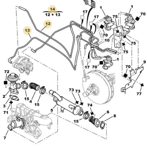

I don't think the C5 has a vacuum reservoir of any sort (according to the diagrams Marc has posted). The pipe from the pump goes to a two way splitter, which in turn go to electro valves (blue for EGR, grey for Turbo), and then head off to their respective devices. The relevant issues the Lexia shows suggest that neither the turbo or the EGR are working (inconsistent air and exhaust gas issues).

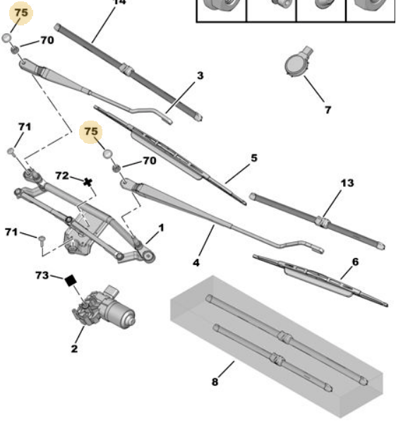

I will suggest that (in light of my experience) anybody who has to remove the rear wiper arm (and finds it has seized in place) purchase a nut splitter like the one in the link (I have no connections with the seller), then carefully cut the plastics away from the metal collar, and then use the nut splitter on the collar. Then take a wire brush to the splines, and you should then be good to go. I intend to also put a little bit of lith-moly grease on the splines, to try and prevent the new wiper arm binding into them.

Even better is to use the proper tool for the job. This is specifically designed for removing wiper arms and the like without obliterating anything else.

True, but (with the level of rusty adhesion between the arm and the spindle) I think that, in my case, that would have damaged the plastic arm somewhat. As I had already mullered the bloody thing I had to find an alternative option, which I did. However, as the rear wiper arm is made mainly from plastic ( the collar and the spring are the only metal bits in the arm) it is likely the arm would not have handled the strain.

Yes but the cover lifts up that covers the nut. This is what the windscreen repair people use James - it's pretty standard and no different on the C5.Hell Razor5543 wrote: 07 Jan 2019, 12:03Actually, now I look at this tool it would not have worked, as the wiper arm covers the spindle,
But as long as you have got the thing off; it's just that there is a specific tool for this job for the benefit of others.

Does anybody know what the inner diameter for the flexible vacuum tubing is on a Mk1 C5?

I think James means the thin rubber vacuum lines that go to electrovalves and so on... probably 6mm

If they're the EGR Control Vacuum pipes, they don't show the diameter unfortunately, but 12 & 13 are comprised as a set (14) and are no longer available from PSA, but the part is 1622V4 for the 2 pipes. Obviously nothing likely to be returned on a search - so he'll have to source them independently I suspect.

A couple of the pipes, solenoid end, have a different diameter than the butterfly end so it may not be as easy as buying a length of pipe, more like making one up. Why do you want new ones, are they generally deteriorated or just a sloppy fit at the end? If it's the later and you can spare a bit, chop a cm off. I do know that BX clear rigid return pipe does fit up the inside and makes a good join if that helps at all?
