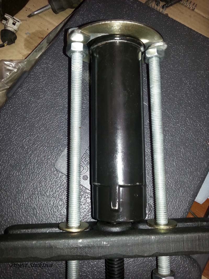

I made a special extractor out of two large truck washers cut in half for removing the scraper seal shroud, photos later.

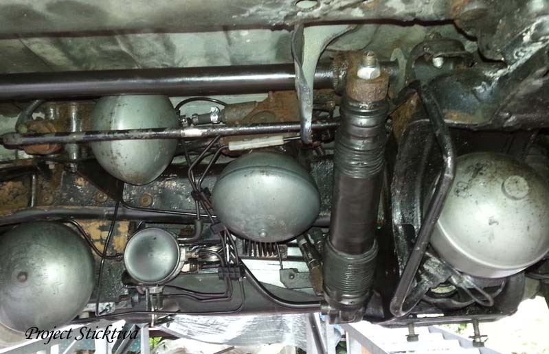

Ram is on, scraper seal shroud is on and seated, ball is on & all greased, gaiter is in position........and the Ram will not pull up to fit into the top socket, it is now about 3~4.cm short.
I have tried pulling it with all my strength via mole grips on an old nylock, no joy

Have you got the Activa system de-pressurised? Even if you have it's hard to move the ram so I find it best to use a jack on the suspension and move the suspension to the ram rather than try to pull the ram out...Stickyfinger wrote: I have tried pulling it with all my strength via mole grips on an old nylock, no joy

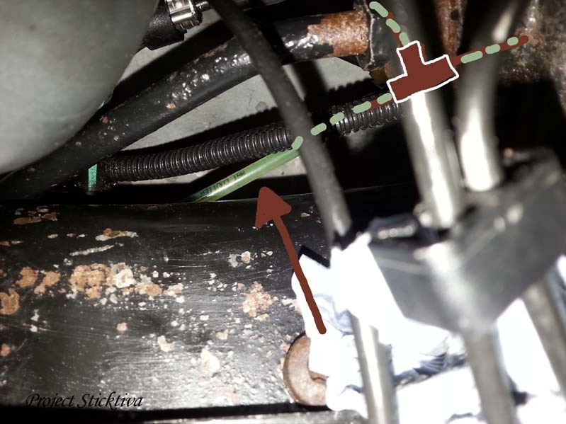

Yep, just done that, I can report the RAM is FIXed..........BUT

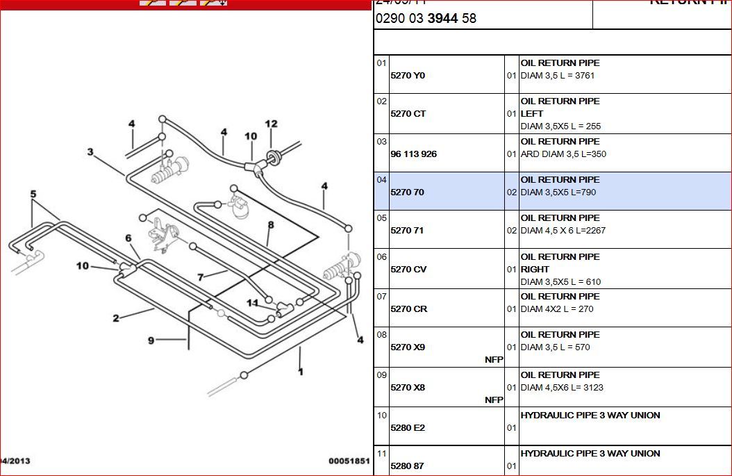

LHM is pissing out ! There is a three way connector up behind here....any thoughts about getting to it ?
Looks like No 4...or No 13 ?

Re: shortly to become an Activa owner...Project Stictiva
On thé non-activa version, the return connector can be reached by jacking up the car a little, removing the subframe bolts on one side and gently lowering the subframe.
If the plastic pipe is popping out of a rubber connector, put a small cable tie around the joint to increase the friction.

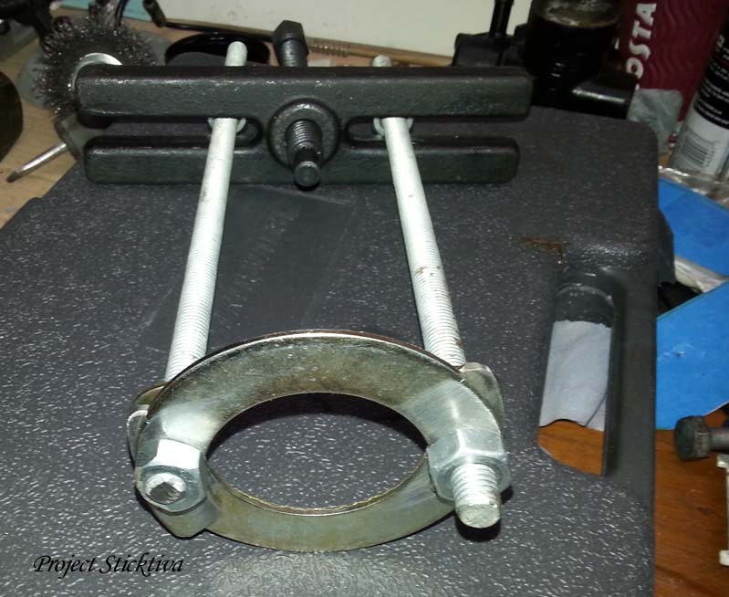

This is the puller tool clamp I made for the scraper seal removal, based on two cut washers.
knowing now just how weak the join is I will for next time weld on some captive nuts and use a smaller rod diameter as the clearance was just a little tight for my liking
So, who has a link to that procedure, I never done it ?

That's an excellent puller for the job Sticky!

That's a really impressive looking tool!
You should be able to rent that out...

It can't be number 13, because that's a high pressure connector, rather than a low pressure join?
You might be able to reach up and just push on the low pressure pipes either side, to make sure they are fully home? If you're lucky, that's the only cause of the leak, rather than the T-piece having split?

On the Leak issue, I put up the wrong image....new one below....I just cannot "see" how this relates to the car
is it 11 on 6, or 10 on 6 or 10 on 4

Although I've only done it on a scrapper it's not hard to lower the subframe a few inches to aid accessibility... Nothing needs disconnecting as there's enough 'give' in the pipework...
It's an essential task if you ever need to gain access tot he Activa electrovalve...

So ?? is it just a case of taking out the two sub-frame mount bolts on the right side and lowering, .....or....... undo ALL 4 ?...I am assuming just one side
