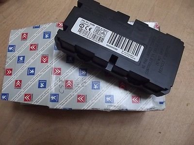

I've decided to make thing even more complicated, and have managed to obtain the TPMS computer for a fraction of the new price ... now I'll just need the antenna/receiver part and to wire everything to the car ... and wait for a good deal with the TPMS sensors (they can be had for 90 GBP for a whole kit) ... and this isn't the thing I was talking about in one of the previous posts ...
... this is one other project ...

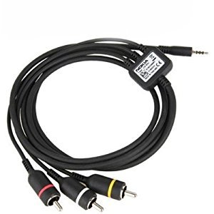

Of course, it can't be simple ... I'm missing a 3.5 mm 3RCA cable to test the video signal, I have 2.5's at home ... more shopping for me ...
EDIT: So far, so good ... I've set up a custom launcher app, and managed to fix the screen to horizontal ... the Torque app is running ... and this all on the stock Android 2.3.3

- get the image to the screen (need to obtain a cable, supposedly Nokia's CA-75U works like a charm);

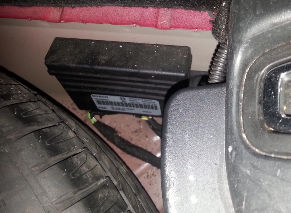

Anyone here has a C5 X7 Tourer Exclusive (or at least one that is equipped with the TPMS system)? I'd like to confirm my understanding of the main module location, is it under the left boot cover/box (the parking sensors module is also located there) ? The module in question looks like this:

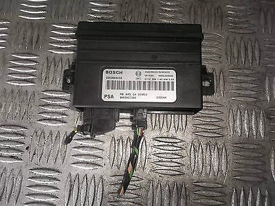

This ?

I'm not sure that's it ... maybe the parking sensor's computer (Bosch sensors, Bosch ECU ... makes sense)?
Then what do I have on the left side then under the trim box? Will need to go over the schematics once again ... the PSA documentation only shows the location of the TPMS module (not the antenna, that's under the car) for the saloon, not the tourer ...

Can I have a look tomorrow for you, I will take the wheel out and make a note of the unit numbers etc....or check on my Vin: VF7**************[VIN obfuscated, can be read by forum staff] and let me know where to look
