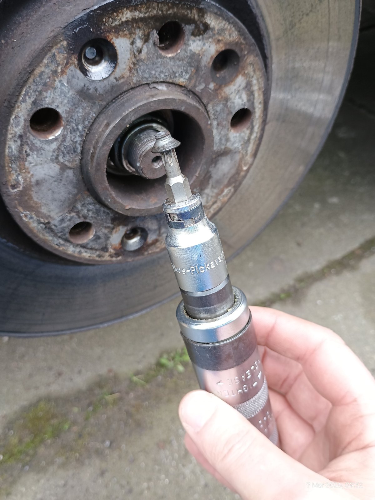

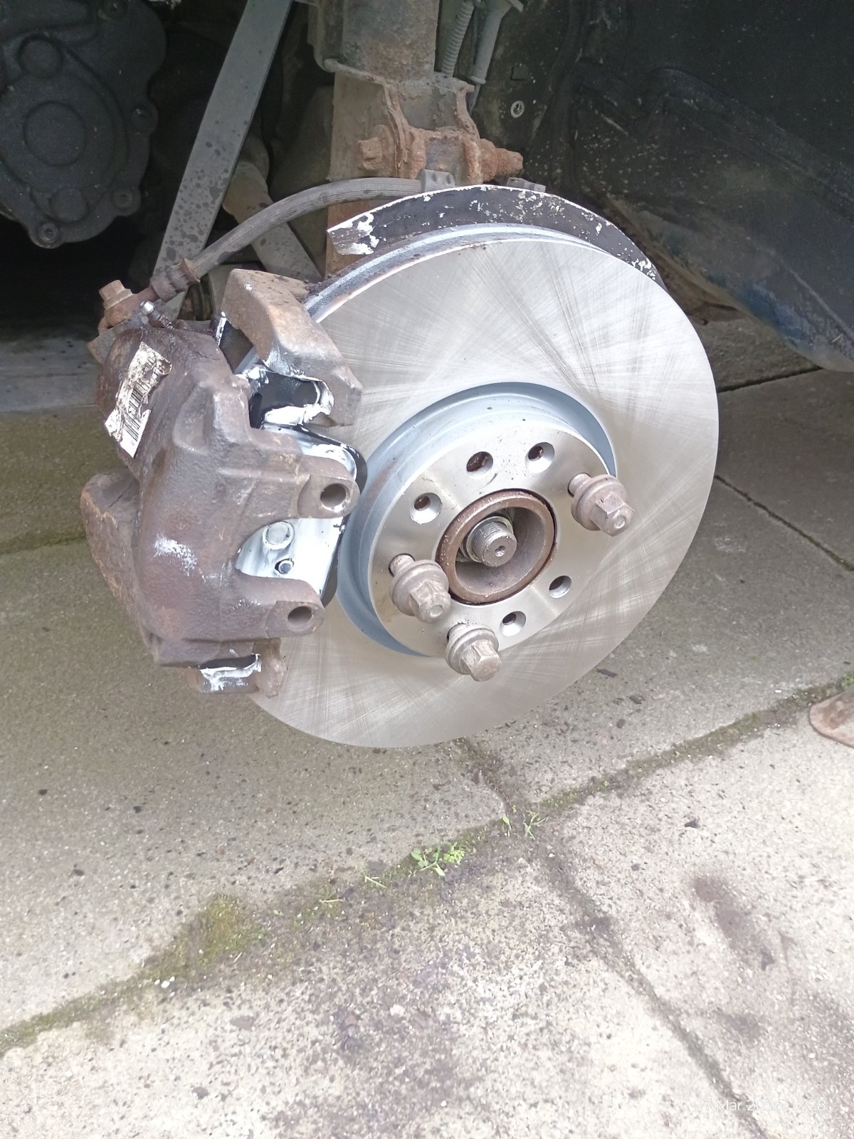

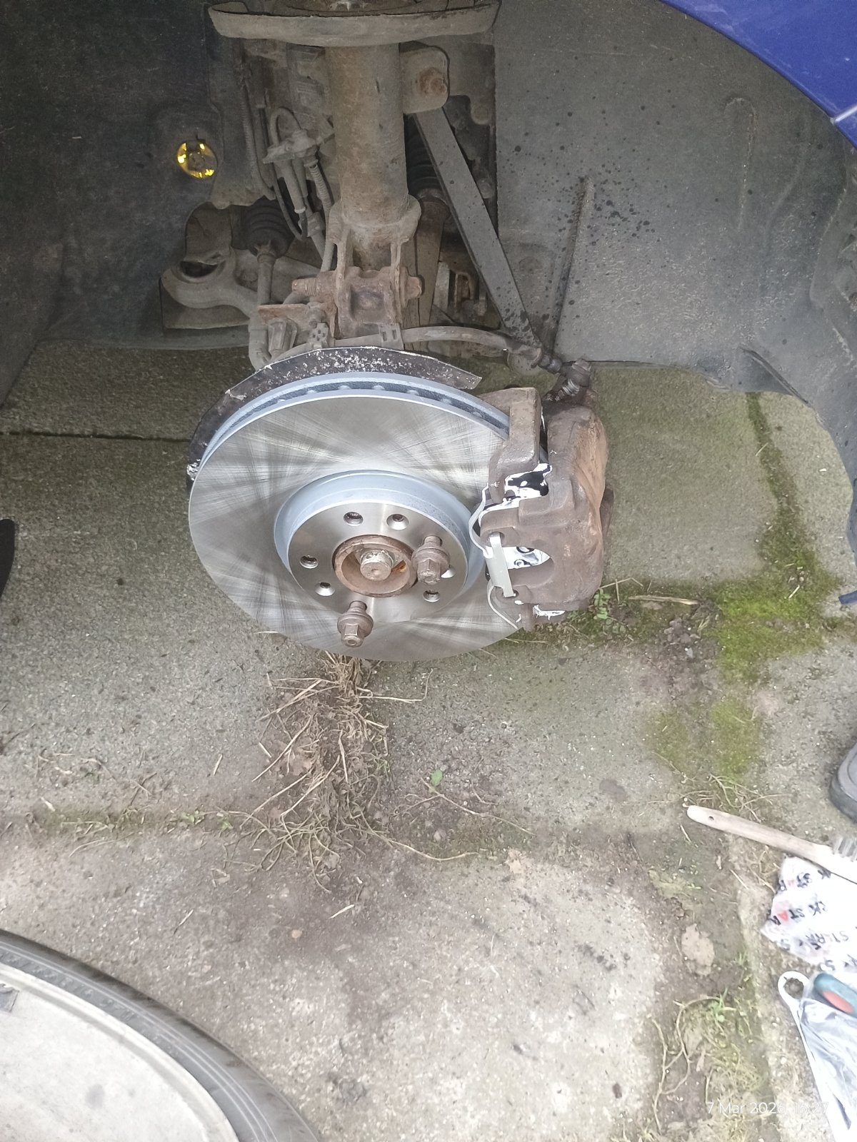

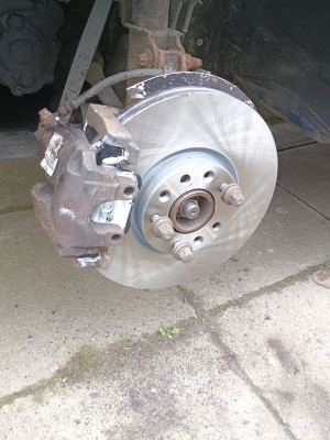

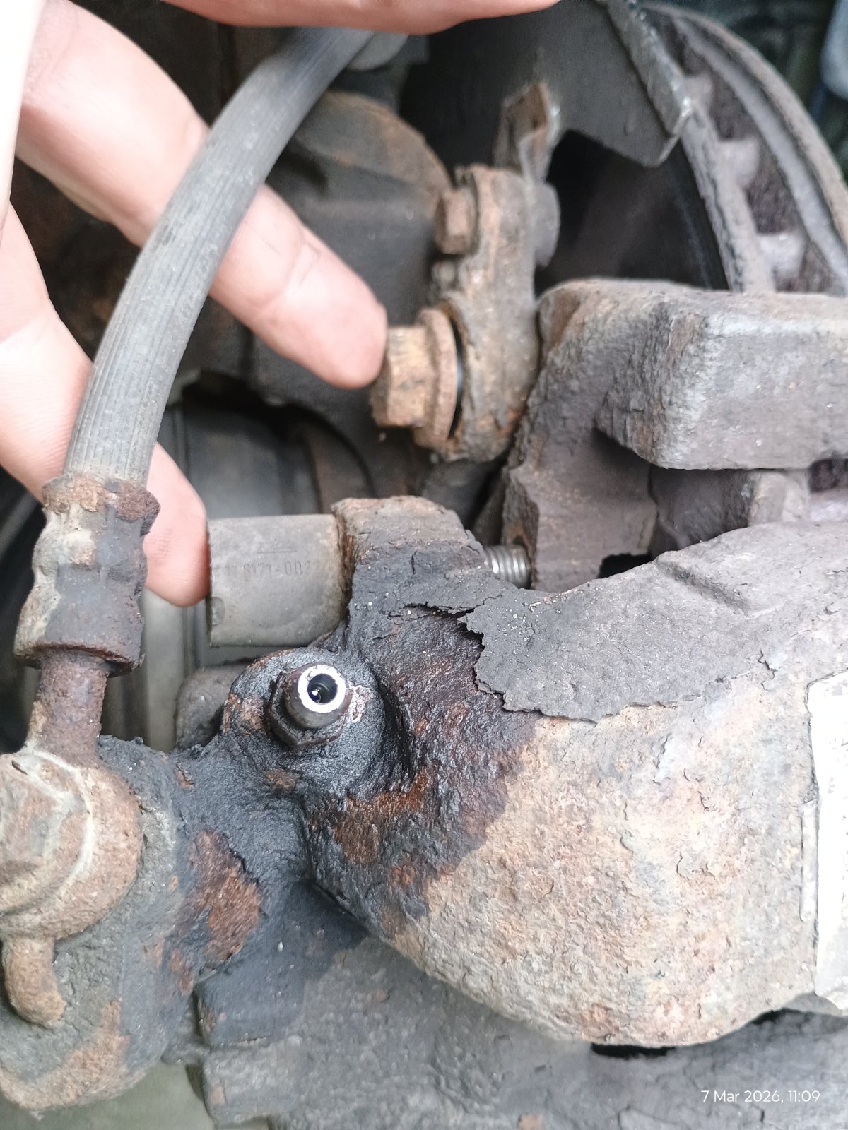

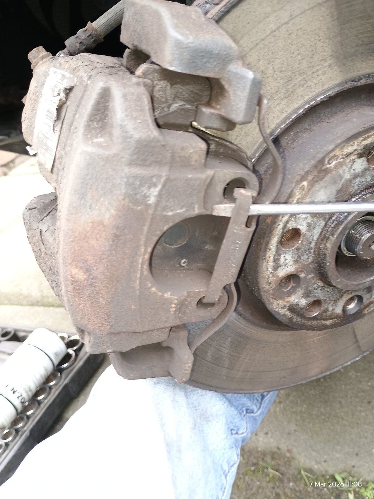

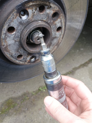

Start as you mean to go on? Thankfully things improved after initially shearing off all four disk retaining screws. Hand impact screwdriver is best chance on these but sadly none were co-operative!
Drilling and tapping for new bolts (see bag of 100 bought previously) will be another day's job.

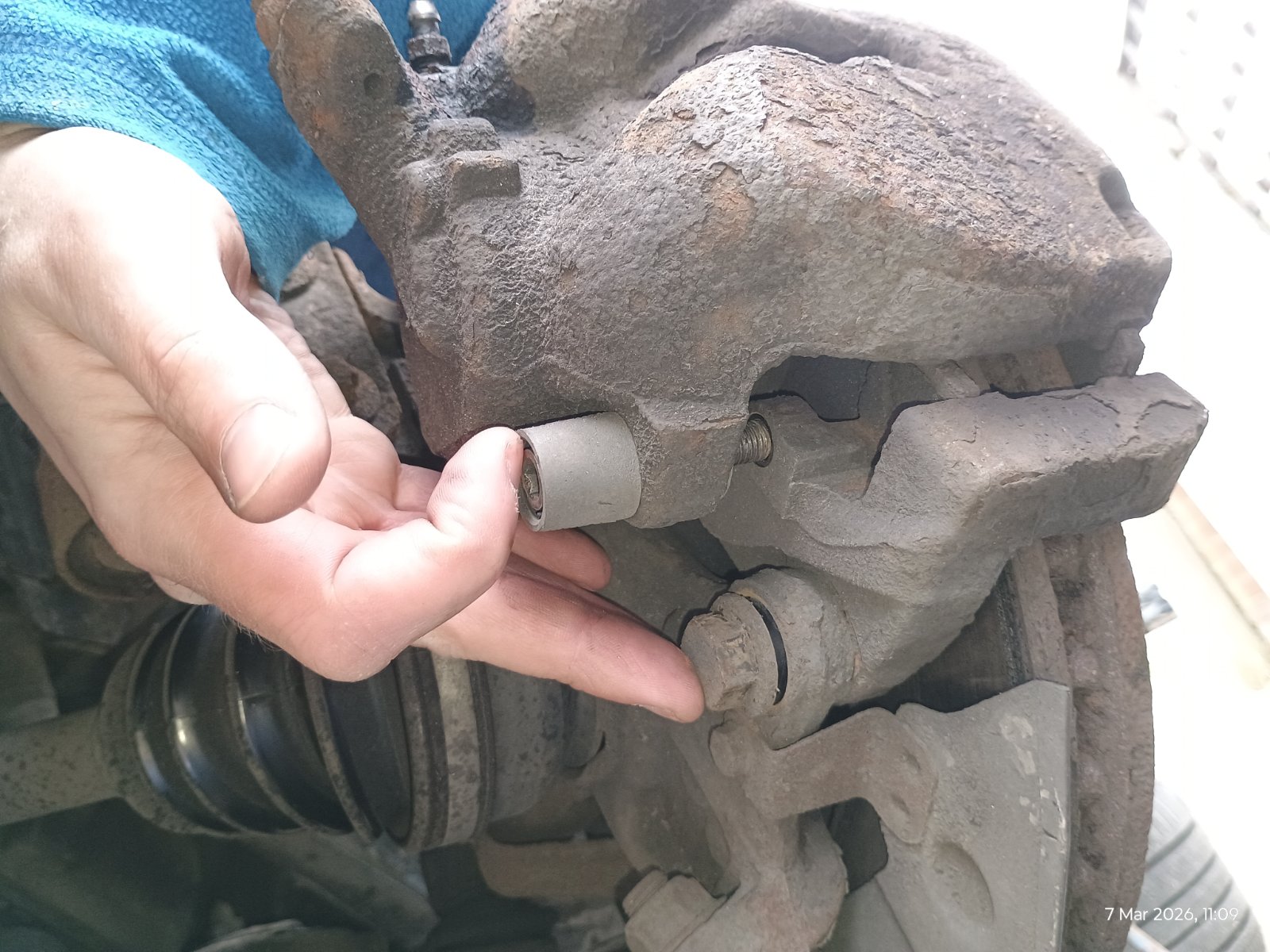

Retaining springs levered off. I was going to call these "pad retainers" but they actually interface with caliper and caliper carrier only.
Rubber caps (where not missing!) pulled out then slide pins (7mm Allen) and caliper carrier bracket bolts (18mm hex) loosened. Bleed screw tapped with hammer to show I'm serious then tentatively loosened. 9mm hex. Turns out these are M8x1.25 (and so the M8x1.0 I've got are no use!)
Then repeat on t'other side

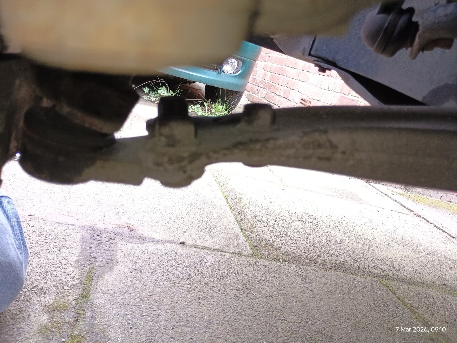

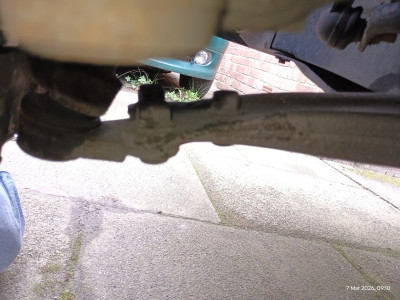

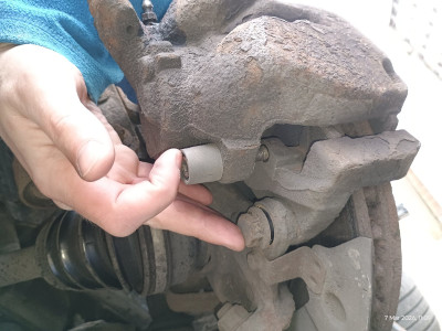

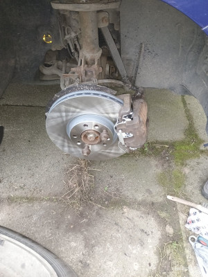

Ball joint and 1 of 4 mudflaps fitted

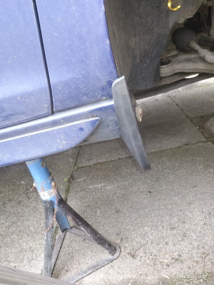

Not as many pictures of the ball joint "non- replacement" Surprisingly the ball joint connection (as supplied with the new wishbone) is bolted - last I encountered (probably on 306??) were big rivets that had to be ground off and only the replacement was bolted.
Ball joint stud is a 21 mm hex Nyloc. Possible to remove (I used offset ring spanner but offset not needed. No room for ratchet and socket due to CV joint.
Three bolts to wishbone, 18 mm hex. Again ring spanner rather than socket due to space. I was told you should have a minimum of 2 threads beyond a nut (to ensure full thread form of bolt within the nut) but whoever made/designed the wishbones didn't hear that one as the studs sit flush with nuts!

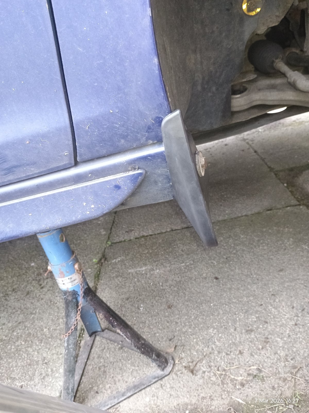

And then first of the new set of mudflaps popped into place. A good fit and retained by a single bolt! M8 in my case (as previously fixing mangled, so larger Rivnut fitted. Would have been M6)

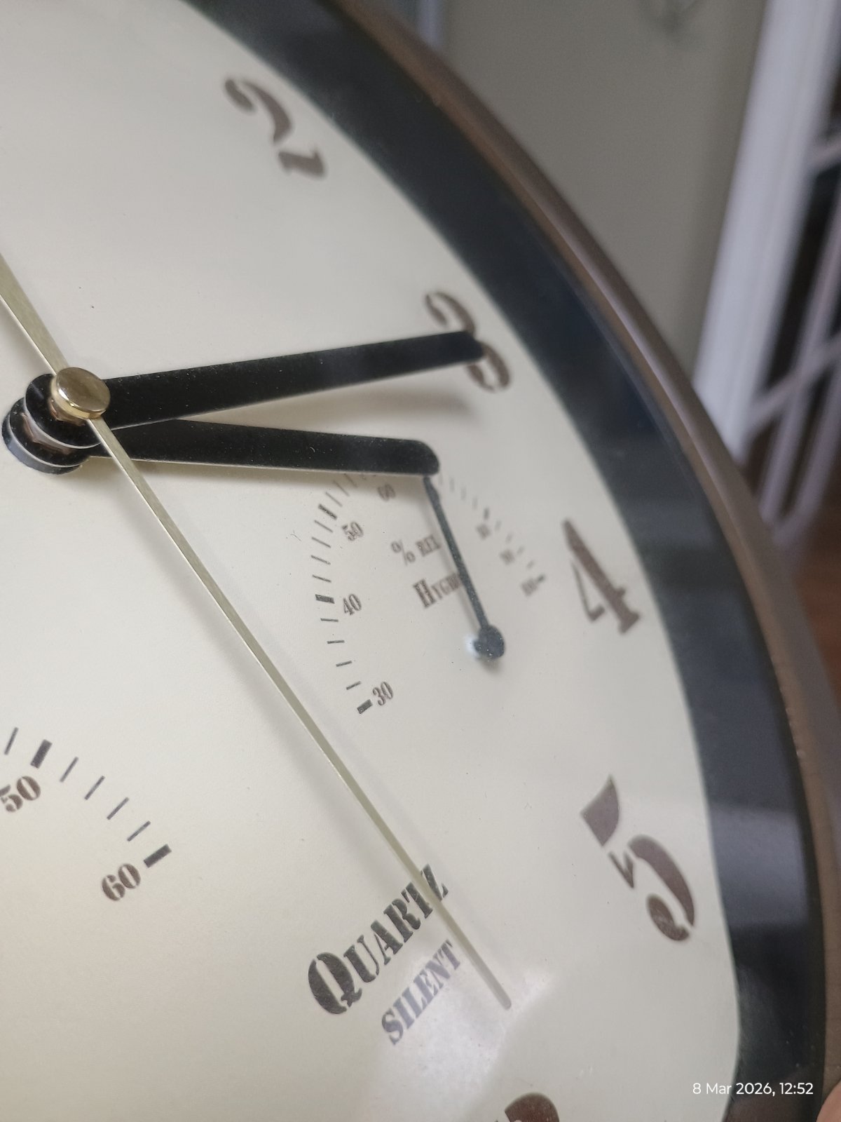

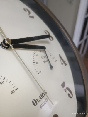

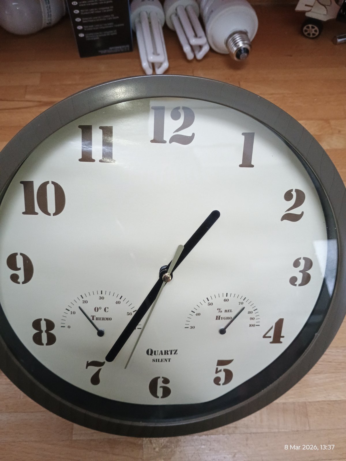

Hopefully a gentle Bend-optomy has done the trick.
Surprisingly the back surface of this (marketed as outdoor!) clock is cardboard

Interesting you should post that today Matt, only last night I was thinking about a formula to define when an analogue clock's minute hand lines up exactly with the hour hand at each of the 12 hours around the dial. Obviously you start at 12 O'clock then how many minutes past each hour do the hands line up again?

I could work this out for you in a bit -mickthemaverick wrote: 08 Mar 2026, 14:06 Interesting you should post that today Matt, only last night I was thinking about a formula to define when an analogue clock's minute hand lines up exactly with the hour hand at each of the 12 hours around the dial. Obviously you start at 12 O'clock then how many minutes past each hour do the hands line up again?![]()
Short version would be 12:00 lines up, next alignment is 1:05 therefore 65 minutes per interval.
However, the short version is wrong! The hour hand is no longer at the 1: o'clock marker at five past the hour so the minute hand would still be behind.
It's more obvious by 6 o'clock, as the minute hand being at half past, the hour hand would be half way to 7.
Anyway, braving the weather (currently moving the humidity pointer well away from a potential clash!!) and see I can get 308 arch liner in place and car back on the ground, ready for tomorrow's commute
