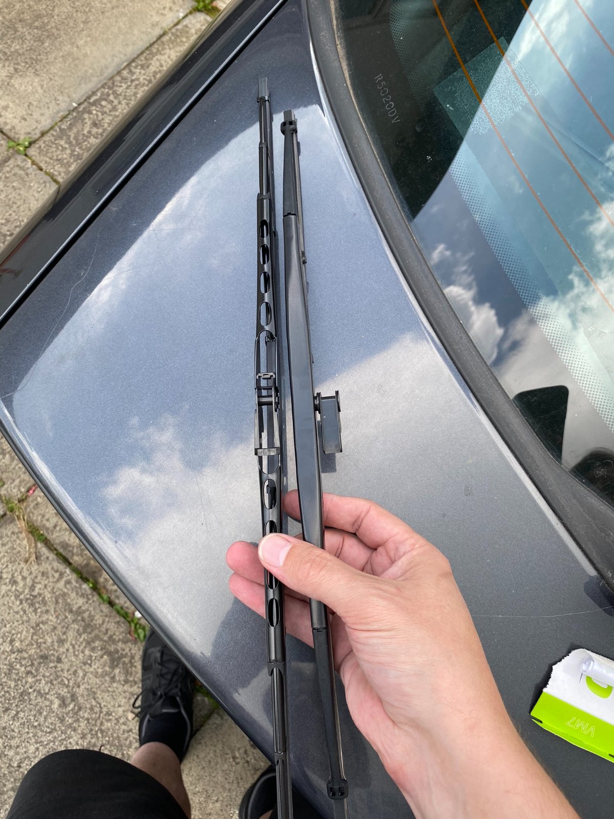

When I swapped the rear wiper blade on the Xantia yesterday - which was only replaced a year ago (!) the rubber on the old one was dry, hard and cracked, and the car has seen hardly any use. Incidentally, the wiper blade that I picked up from Euro Car Parts was not even remotely close to compatible despite the listing assuring that it is... :roll:
It not only doesn't have the side mounted pivot, (to clear the spray nozzle) the whole thing is longer and can't be fitted at all: (the original, correct one is on the right)
I was going to take it back but at £3.57 it was hardly worth bothering - however I then realised the rubber insert was compatible so I disassembled it and transferred the rubber over successfully - it was at this point that I remembered I'd done the same thing last time! #-o :lol:
It boggles my mind that so many suppliers are so absolutely awful at getting parts compatibility right, and they sometimes won't even believe you when you try to send stuff back that doesn't fit. [-X I remember having a real hassle with Pagid handbrake cables on the first Xantia V6 which weren't even remotely compatible with the car...

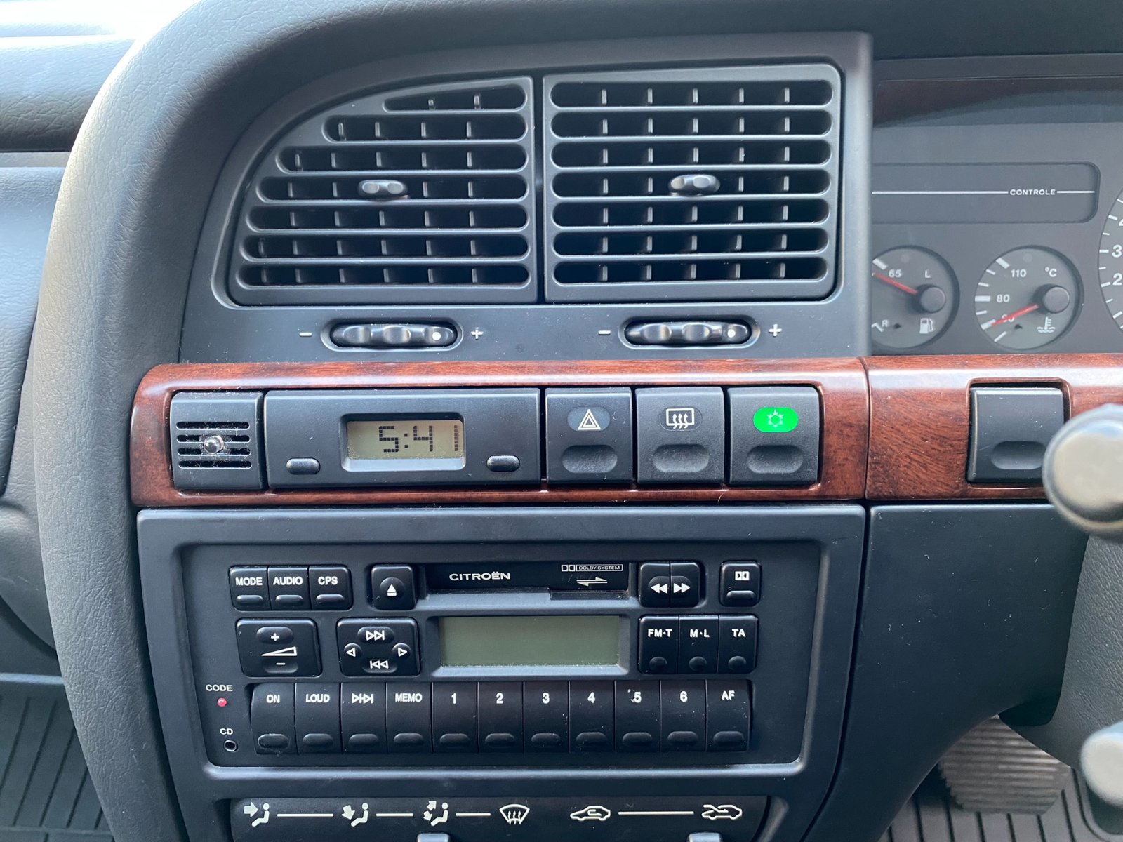

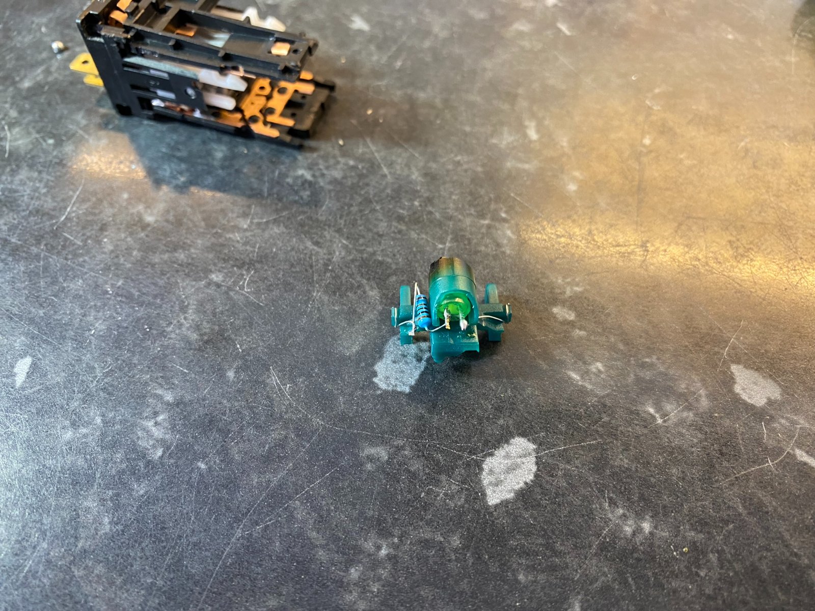

I decided I needed to fix the light in the aircon button before they test the aircon otherwise it's not obvious what is on or off... so I pulled the switch apart again and replaced the bulb with a 5mm green LED!

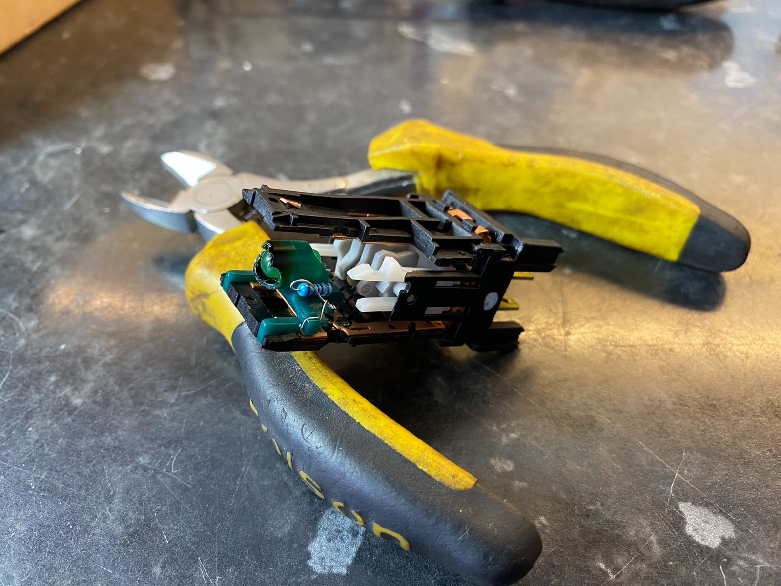

I was originally going to use a 3mm LED but a 5mm LED turns out to be a good fit and will be brighter so I used that. Of course when replacing the bulb with a coloured LED you want to knock the front out of the colour filter - no problem with mine as the colour filter was completely black and charred and disintegrated on touch! (Hence why the light was so dim - although the bulb failed later as well)
Squeezing the 1k resistor in is challenging though, there is just enough room for it to fit in a slot to the side in the sliding part of the button front! I soldered onto the old bulb legs so I could leave those wrapped around the posts. The resistor is connected to the positive of the LED.
And here is the end result - very nicely lit in daylight. =D>
Hopefully it won't be too bright at night... :twisted:
Potentially all of the button lights could be repaired like this with suitably coloured LED and the charred colour filters knocked out, but it's a very fiddly job so I'm probably not going to bother with the others. The rear window demist and hazard light buttons are both somewhat dim but visible and are still good enough, the only one I use that doesn't light up at all is the cruise control button, but I'm not sure I want that glowing all the time anyway as I always leave that button on!
A small tip to anyone doing this job - don't plug the bottom half of the switch in and turn the car on with the switch disassembled as it will cook the 40 ohm resistor on the PCB! #-o Fortunately I noticed it right away when the magic smoke started coming out and switched it off before the resistor was damaged beyond discolouration.
When the "PCB" is not inserted into the top half of the switch there is nothing to keep the various switch contacts sitting in the right positions so the spring tension causes them all to close at once, which presumably puts 12 volts directly across the 40 ohm resistor and would burn it out if left for more than a few seconds. Ouch.
I think this resistor might be there to supply the original bulb, so potentially you could replace the 40 ohm resistor with 1k and fit the LED without having to shoehorn a resistor off to the side, but I didn't bother tracing it out to see if this was correct or not. If I fix any more buttons I might do it that way if that resistor proves to be supplying the bulb as it would make for a tidier job.

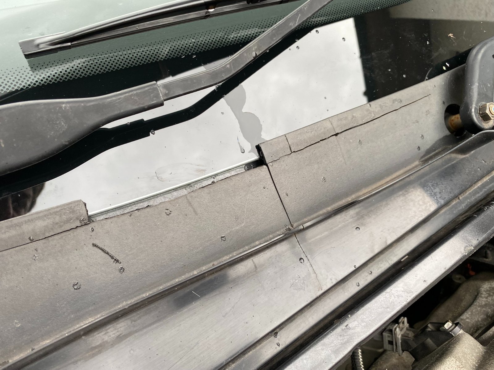

Windscreen day arrived today and I'm now quivering with rage. :evil:
I can't get any time off work this week so I had to leave it with my mum to deal with. The guy arrived and the first problem is that he needs to park his van beside the car to do the job - so mum ended up driving the car up the road to an area with some parallel parking (with no MOT... :shock: ) for him to do the work there then walked back to the house.
When he was finished he brought the keys back and then was on his way, with mum having to walk back to the car to bring it home. It wasn't until I got home that I realised he's completely buggered the scuttle and did not make any attempt to bond it to the glass at all - he just shoved it back in and sat it in place loose.
To say I'm angry is an understatement. Yes, the scuttle was in poor condition before but I'd managed to do a fairly good job of gluing it back in, however apart from not gluing it in at all (thus leaking into the heater fan) an entire strip is missing now:
I drove up to the location where the work was done and searched the ground - I found a few other bits from the job but not the missing strip. I also lifted out the scuttle and looked underneath in case it had fallen in there but nope. He's thrown it away.
So now I can't even glue it in myself because I'm missing a big chunk. :cry:
So, does anyone have a spare scuttle ? :(
