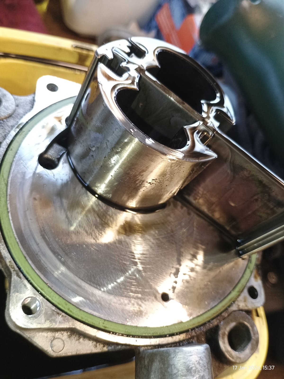

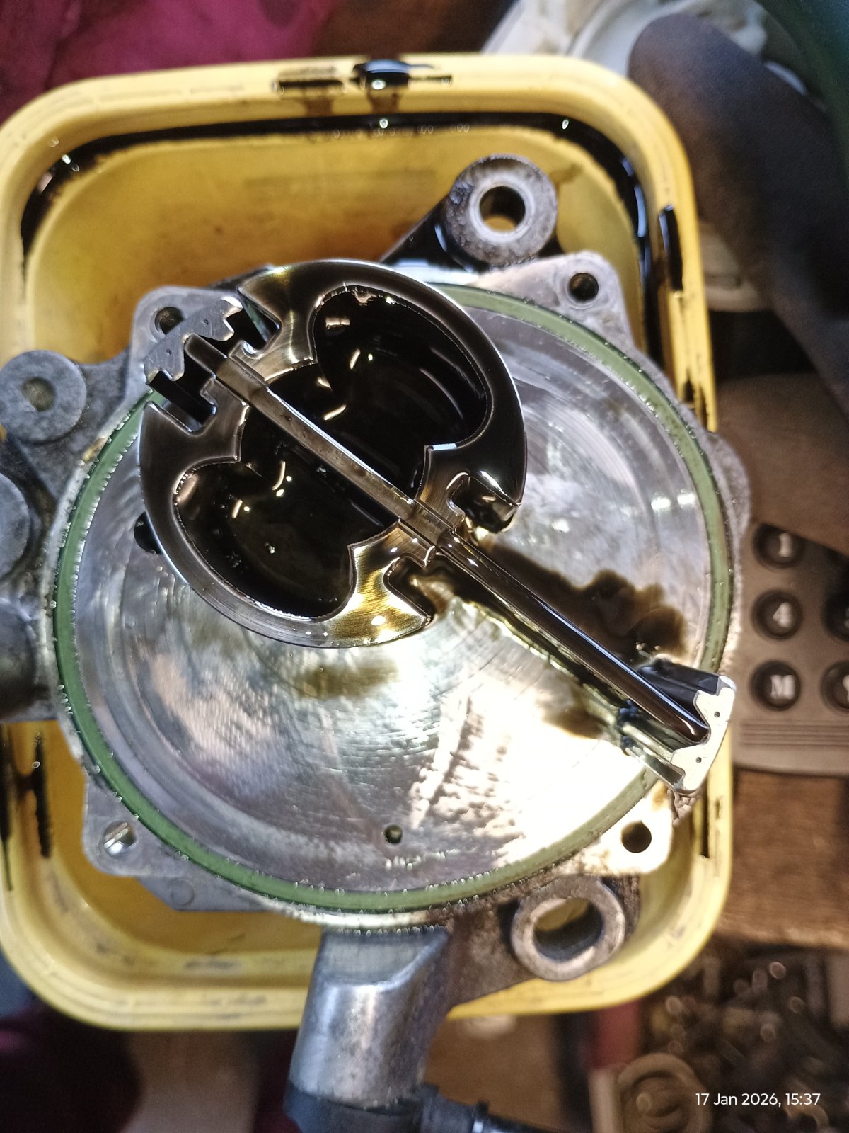

Vacuum pump has had an odd rusty patch as long as I've had the car. Took air filter housing off (inspected filter, haven't a replacement but will source one as current element is beginning to load up)
This improved access to the vacuum pump so it came off for an inspection and quick repaint

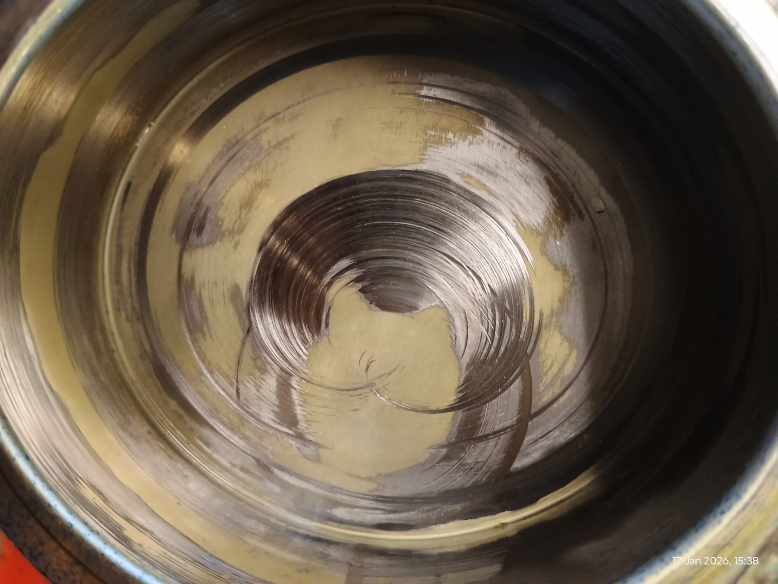

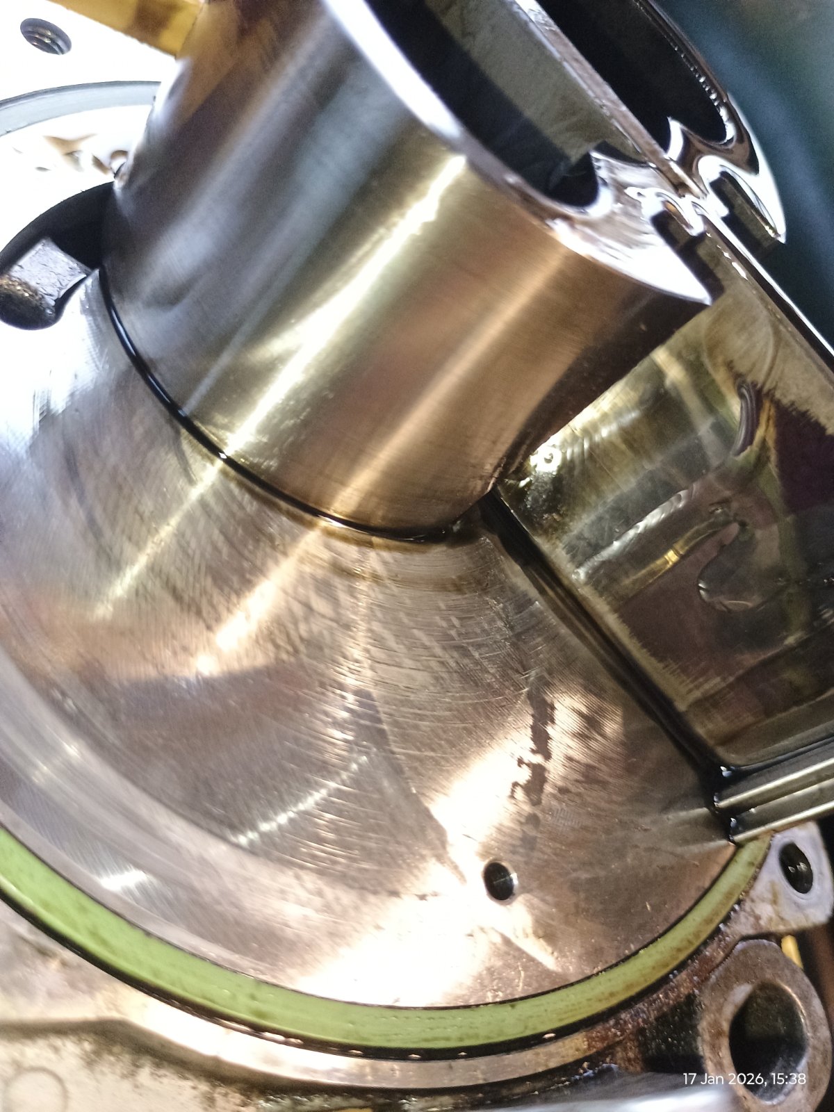

Inside the vacuum pump not looking that lovely. Lots of scoring on all working surfaces.

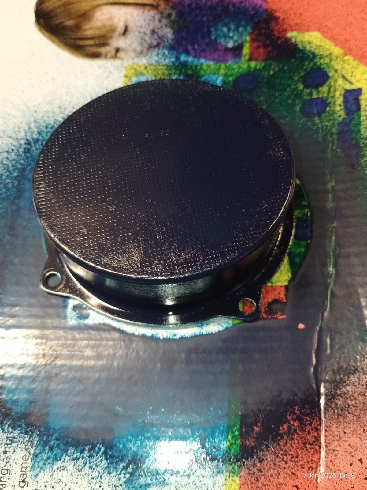

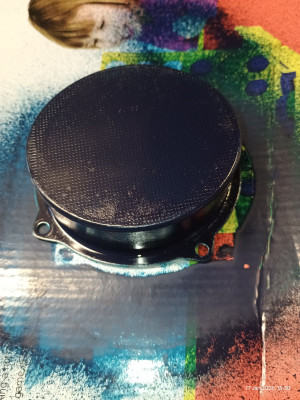

New paint job for the exterior (after the rust removed with grinder flap disk)

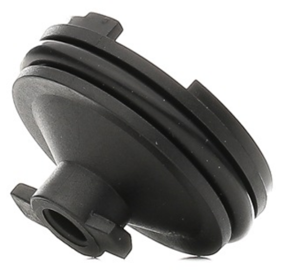

Nope! No sucker - old fashioned undo the plug out the bottom and let it drain. On the blue 308's plastic sump it has a plastic sump plug. Bayonet type quarter turn (having slid back a small R-clip which prevents it from turning - R-clip slides along a grove integral to the sump).mickthemaverick wrote: 17 Jan 2026, 17:31 Now you have me thinking Matt, if you are going for a tool free oil change how do you get the oil filter off? (I assume you are using a sucker so don't need to worry about the drain plug!)![]()
Then plug pulls out the way (with usual "try not to get it up your arm!" Game) and out it comes.

See if I can find a picture of the plug. Ah, if course Autodoc has a good image: £2.99 for a new one = https://m.autodoc.co.uk/3rg/14110655
