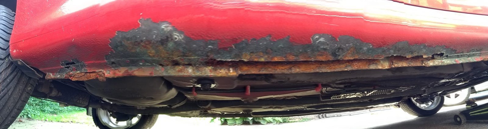

Similarly, this could easily have been end of the road for my wife's 206:
There's a hole in my sill
But a while later, new metal instead

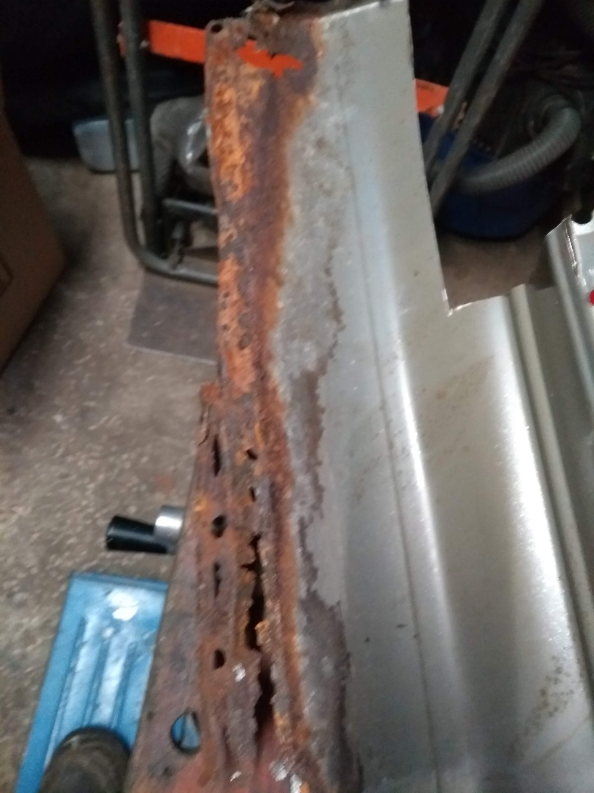

Shelf upright = inner sill
1 Exhibit A: definition of "like a pig in muck" :)

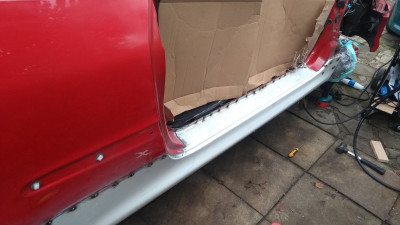

2 what the inside of the sill looked like, once removed.

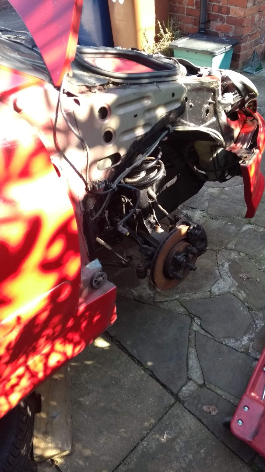

3 off came the front wing

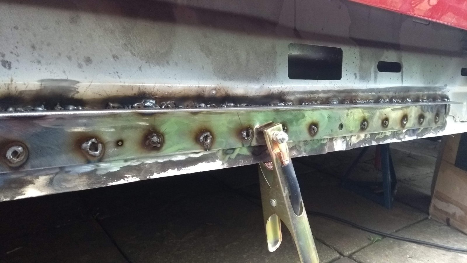

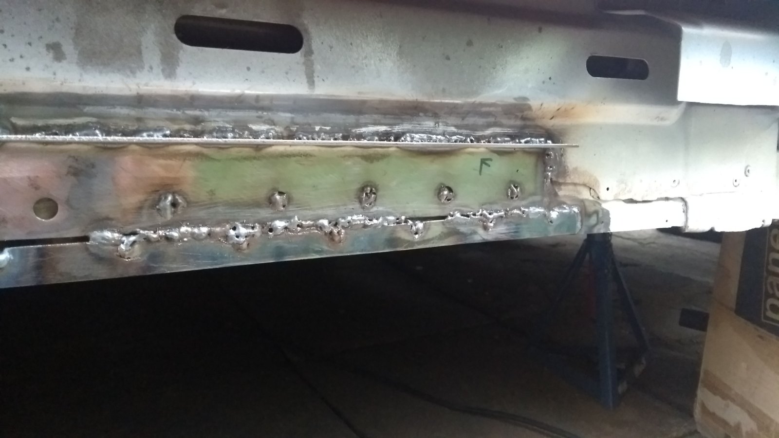

4 shelf bracket to make things more solid

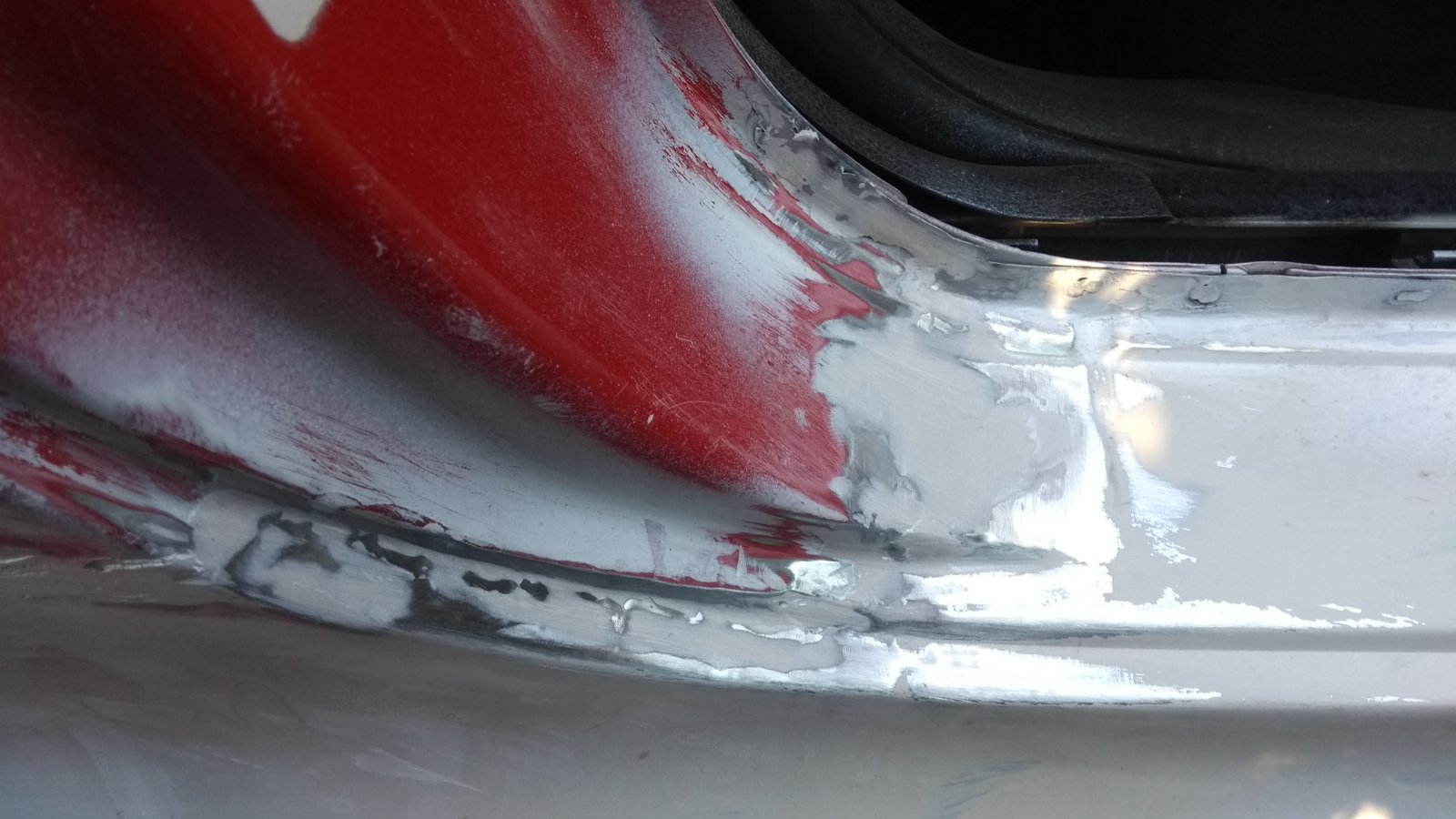

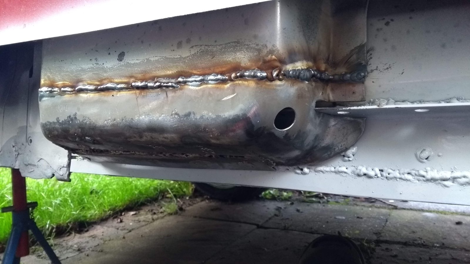

6 strange reinforcement box at base of the B pillar, bisected to allow the shelf angle to continue through. Then reinstated. A couple of large holes added - intended to allow a squirt of waxoil inside here (ah, still not done that!)

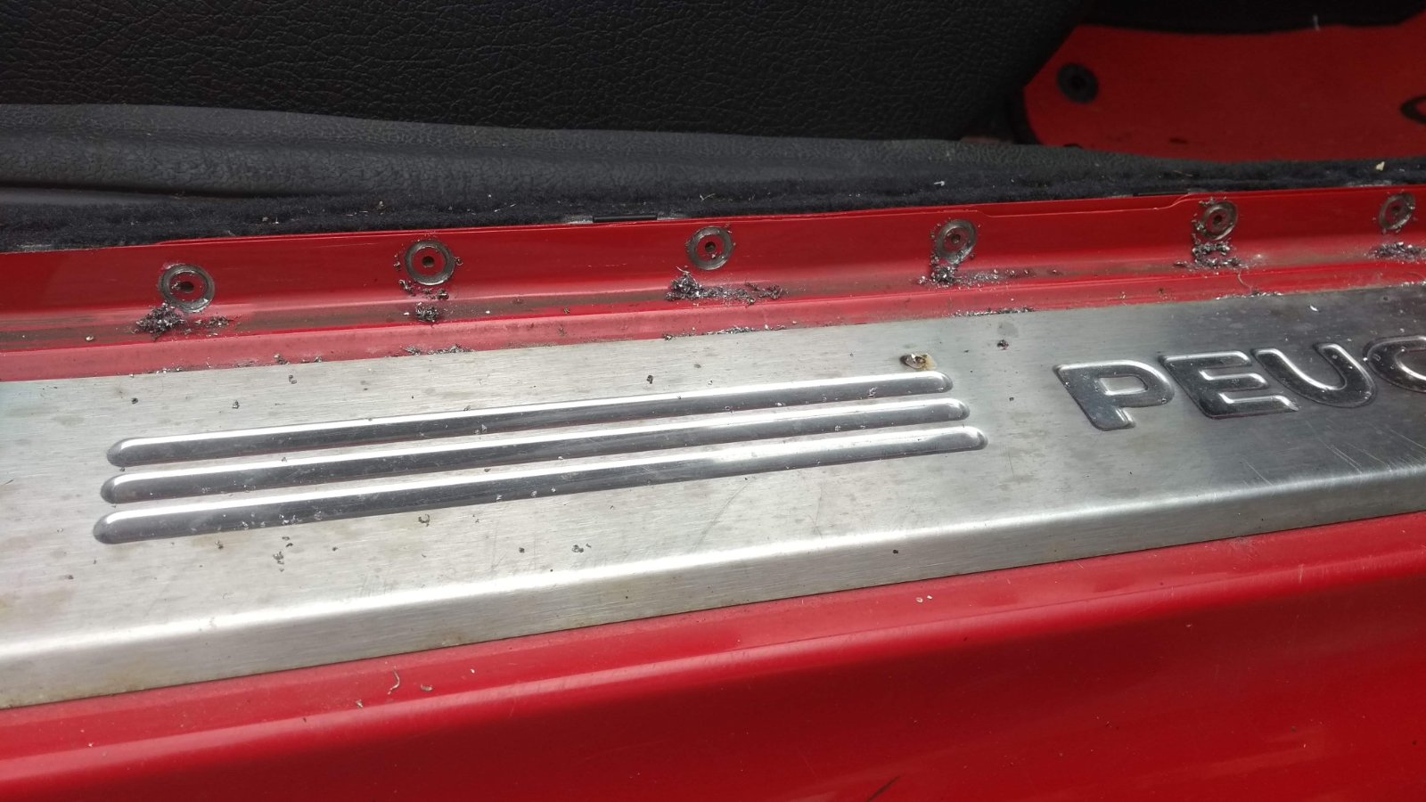

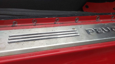

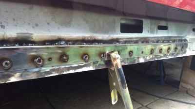

8 spot weld drill thing removed the fixings very well. Stainless sill plate is just stick pad on rear

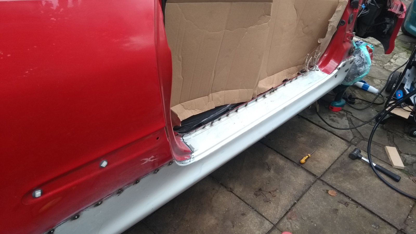

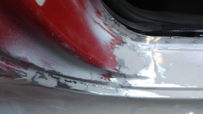

5 welding completed, but of filler just to neaten up what would hit you in the face on opening driver's door

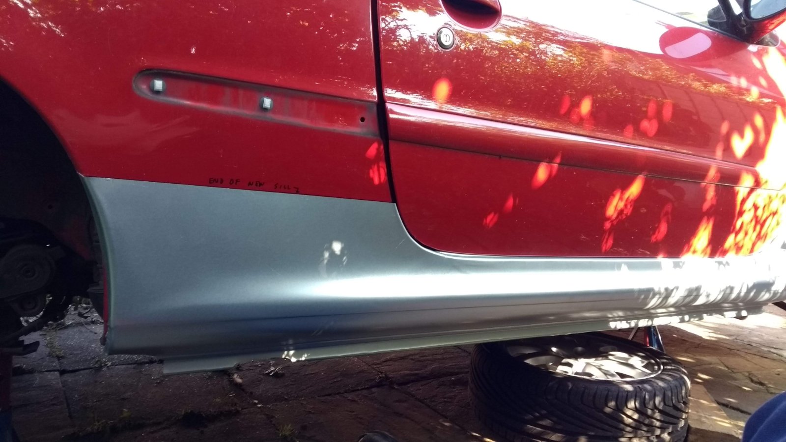

7 new sill tacked onto place
