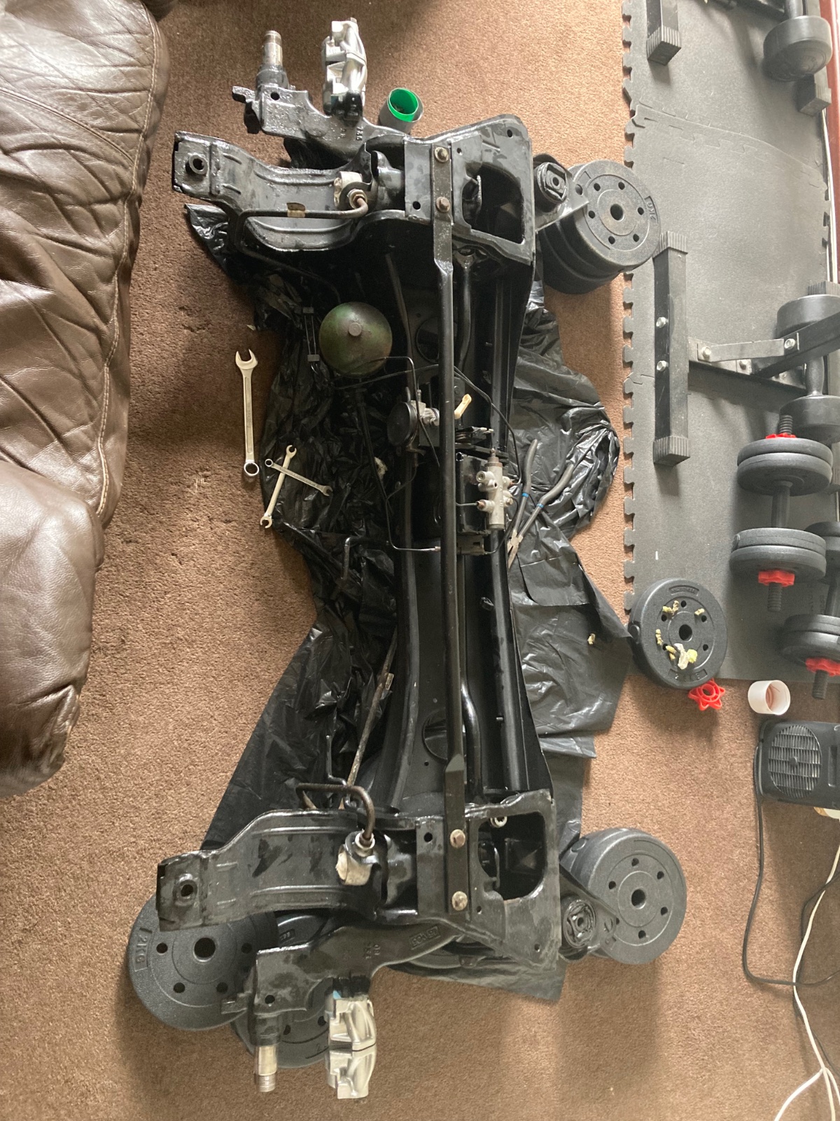

Hey everyone ive been testing fitting the rear subframe together using my memory and pictures, well mostly pictures lol,the good stuff is ive got the subframe back together.
Rear sub
Rear sub
, but I’ve realised ive got no pictures of the k connections and the break pressure shpere were that goes to, does anybody happen to have a diagram on were those pipes go

Blimey I hope that’s NOT your front room Scott :lol:

Skull wrote: 19 Apr 2025, 11:40 Blimey I hope that’s NOT your front room Scott :lol:
Ditto! Looking excellent though :-D

No worries, front room is safe! That’s just the back room mid-revamp, so ive got the opportunity to use it for some tinkering in it :-D

It wasn’t until I looked at it more carefully that I realised it was a subframe and not an inlet manifold…. 🤣

And it's good to see the subframe has been busy getting itself fit ;)

Rhothgar wrote: 19 Apr 2025, 17:00 It wasn’t until I looked at it more carefully that I realised it was a subframe and not an inlet manifold…. 🤣
Easy mistake to make at a glance

CitroJim wrote: 19 Apr 2025, 17:14 And it's good to see the subframe has been busy getting itself fit ;)
Haha yeah, it’s definitely been putting the work in, Glad to see it shaping up though, all that effort’s finally paying off.

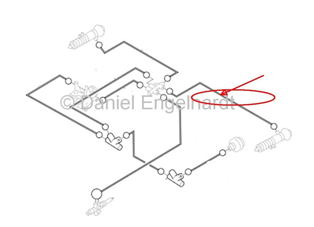

Does this diagram help?
Assuming non-hydractive with anti-sink

xantia_v6 wrote: 19 Apr 2025, 18:50 Does this diagram help?
Thanks a lot for the diagram—it’s really helpful and much appreciated.
Mine’s actually got Hydractive 2 suspension with anti-sink, so there are a few extra pipes in the mix, but this still gives me a good starting point to work from. Thanks again for taking the time to send it over

Beware that the anti-sink valve is connected differently on hydractive versions. I can't immediately find the correct diagram (one of my PCs has died), but see also the diagram for the activa (which is based on the hydractive version: viewtopic.php?t=85820

xantia_v6 wrote: 19 Apr 2025, 21:54 Beware that the anti-sink valve is connected differently on hydractive versions. I can't immediately find the correct diagram (one of my PCs has died), but see also the diagram for the activa (which is based on the hydractive version: viewtopic.php?t=85820
oh nice one, cheers for that. I’ll have a look at the Activa diagram, sounds like it’ll be closer to what I need. Sorry to hear about the PC—hope it’s not being too much of a pain!

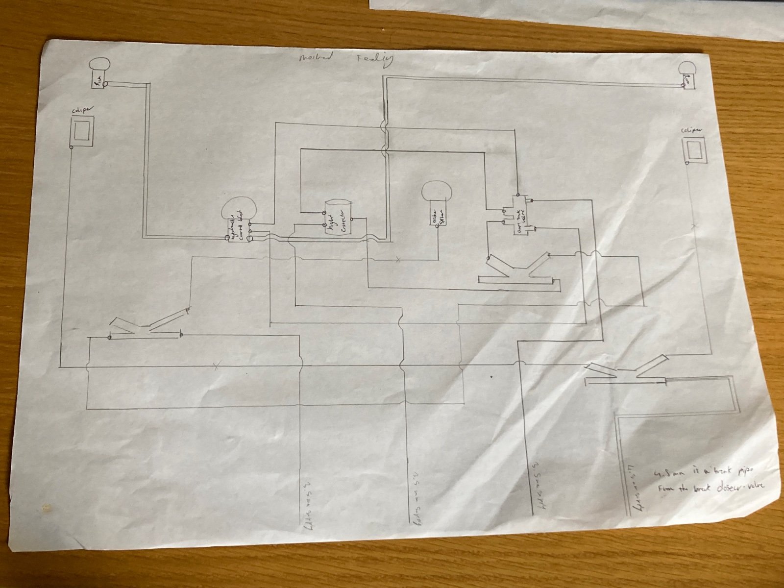

Been trying to make sense of the rear suspension hydraulics on my Xantia, so I ended up piecing it together from manuals, forums and old pictures.
I drew up this diagram based on what I found—might help someone else out there. If anything looks off, let me know. oh and a big shout out to xantia_v6 for the link putting me in the right direction.
