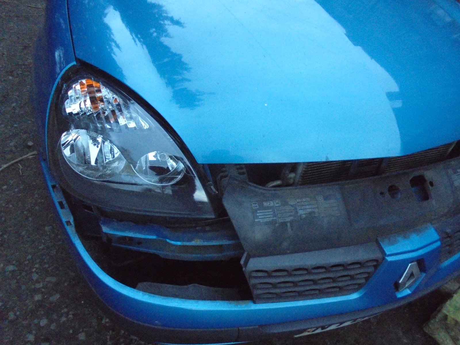

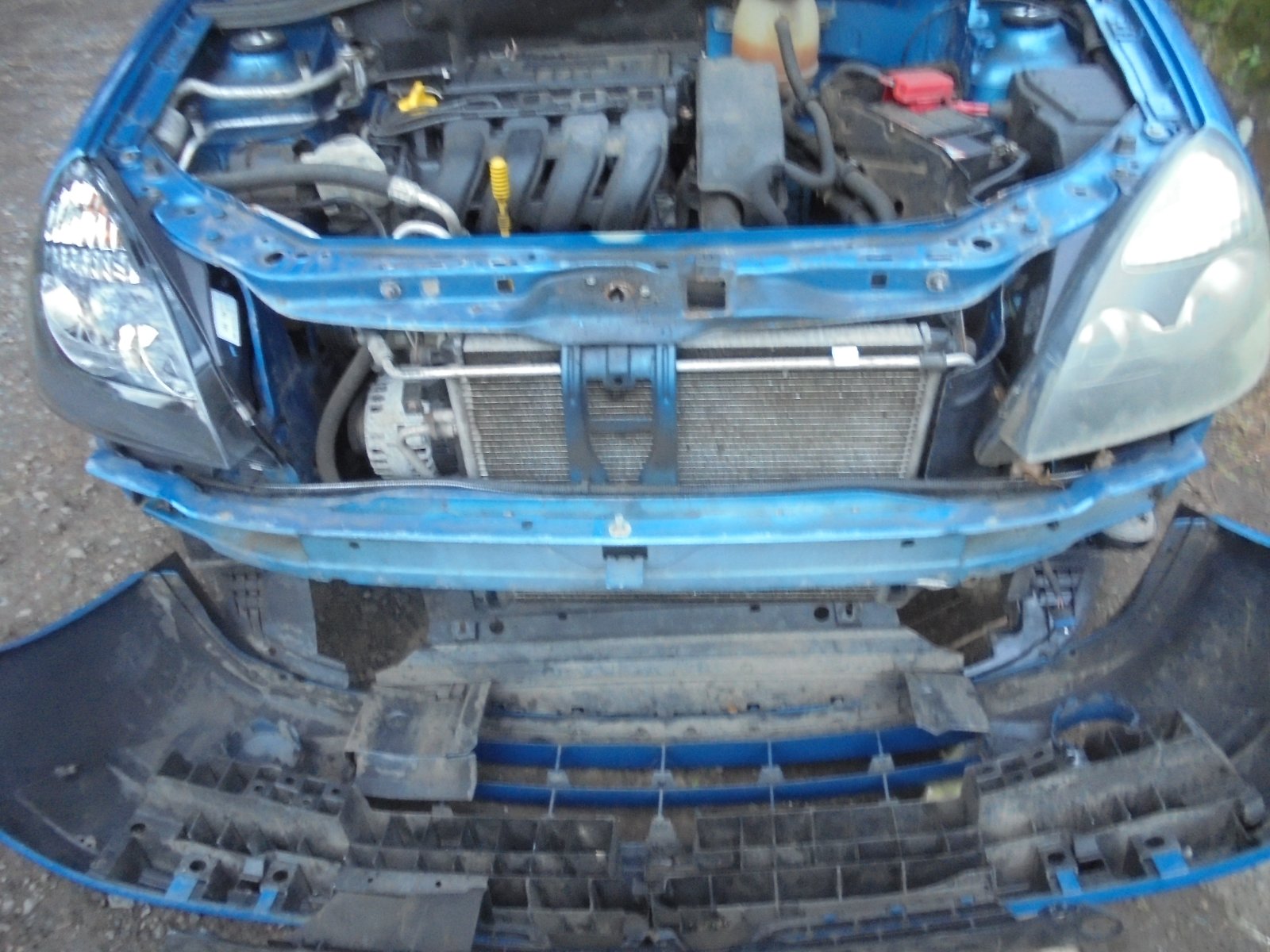

Got the lights and obviously even in the fairly ancient days of 2003, new cars had evolved into a headlight replacement job involving removing the front end of the car, formerly known as the bumper.
Clio Net has a piece on how to do it, plastic clips, rusty self tappers, and the odd rusty bolt to negotiate

I replaced the headlamp on my friend's 2004 Megane Convertible which involved removal of the front bumper but I was able to simply remove the screws on the side I did and pull the bunper away sufficiently to replace the headlight. So you may not need to remove the whole bumper, just release it side by side!! Good luck

I had already metaphorically rolled my sleeves up when your advice came in

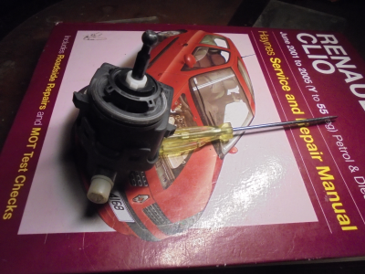

As well as moving the various bulbs to the new headlight, also have to move this thing. The ball joint on the end fits into a white plastic slot inside the lamp. Some kind of headlight adjuster.

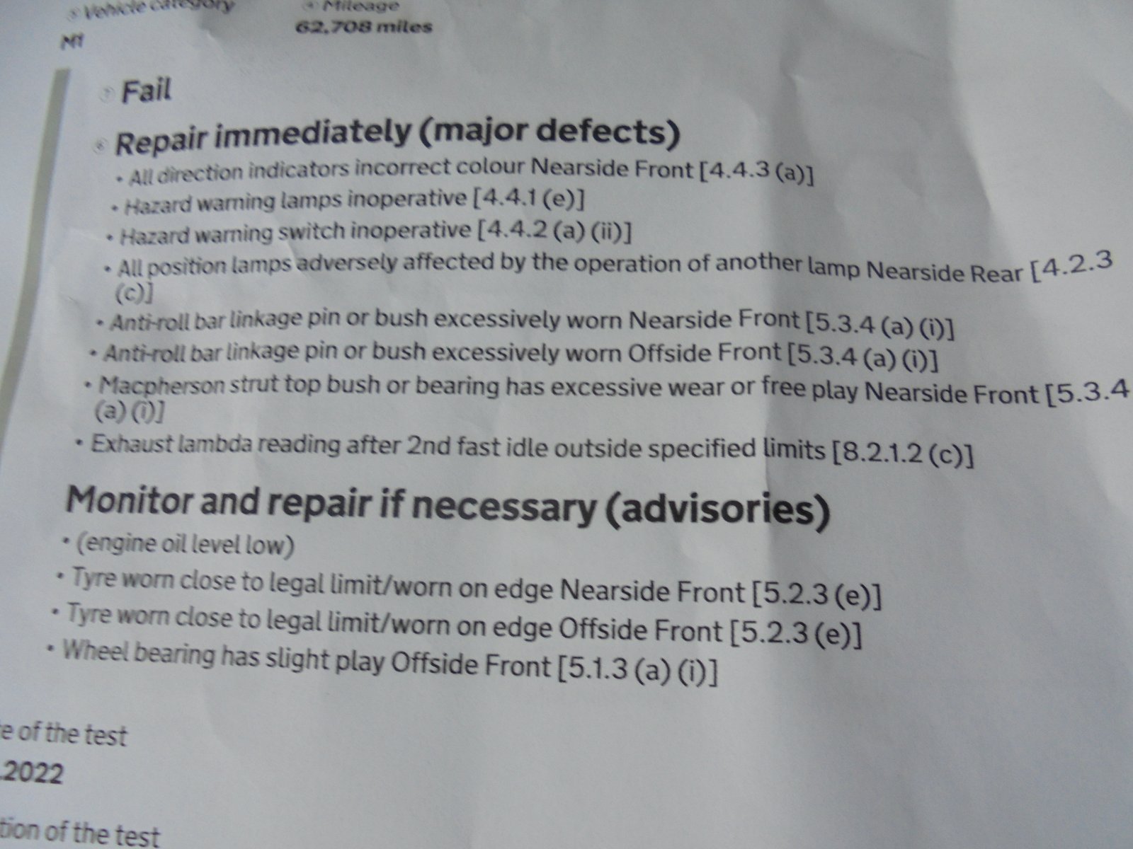

MOT Time, is the time when Bargain Basement motoring can turn into just motoring, and just normal running expenses.
BB Clio went off to Council testing station today, and here's the list
Pretty normal stuff.
Apart from
The overzealousness of the orangeness of the bulbs, they looked orange enough to me last night;
the MOT day I'm a French Hazard light switch, even though I was working fine last night, I'm going to play up on MOT day;
the barely noticeable "flashing" of the rear "side-light" bulb when the indicator light flashes, again peculiarly Clio, and a speciality of the model;
the normal mechanical wearings out ARB links, and a simple tighten up job on the top strut mounting;
the thing that most concerns me is the emissions fail, and what action if any I can take to remedy it, without making it uneconomic to resolve. Given a fair wind the annoying electrics and the mechanical faults are solvable.
The emissions failures were on the Lambda at fast idle max allowed 1.030 actual 1.060. Same result on 1st and second test.

My first move there Neil would be to use an injector cleaner which you add to the fuel tank and then drive 30-40 miles and it will clean out the fuel system. There are quite a few options on the market and I can say I used the Redex product on my petrol C5 and it did a good job:
https://www.ebay.co.uk/itm/373525182614 ... SwDUBgZ8qF
As for the oddities with the indicators I'd check the earthing points at each lamp and the flasher unit mounting. Good luck!

Thanks Mick. The car has an 18 year old catalytic converter, but when the exhaust downstream of the Cat was renewed I got them to renew the 2 oxygen sensors. Apart from what you suggest the only 2 escalations I could see affecting the result would be a new cat and/or new sensors.mickthemaverick wrote: 10 Feb 2022, 13:52 My first move there Neil would be to use an injector cleaner which you add to the fuel tank and then drive 30-40 miles and it will clean out the fuel system. There are quite a few options on the market and I can say I used the Redex product on my petrol C5 and it did a good job:
As for the oddities with the indicators I'd check the earthing points at each lamp and the flasher unit mounting. Good luck!![]()
A 2003 Clio whatever they say about compatibility with E10 fuel, was probably set up to run best on fuel with no alcohol additive. What would you expect as far as that Lambda test is concerned if I put Esso Synergy Supreme+ 99 Unleaded fuel effectively E0 into the tank?
