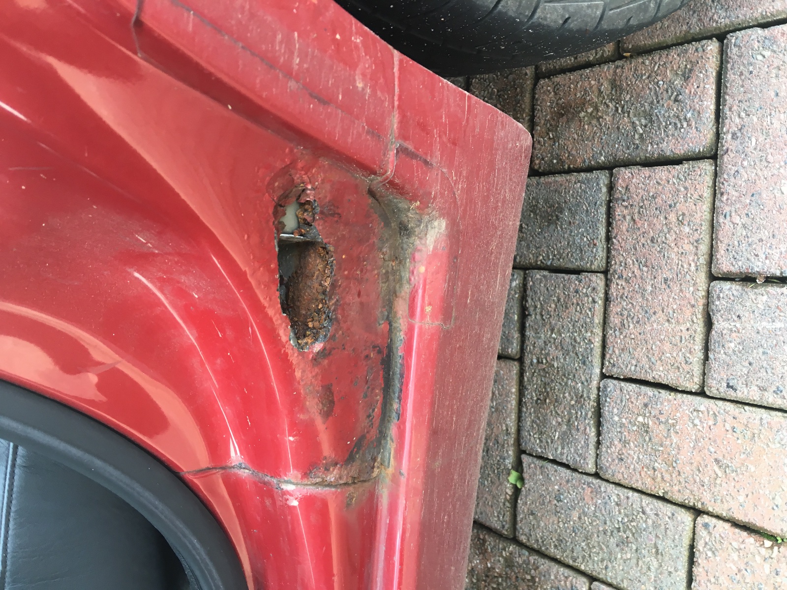

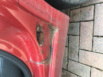

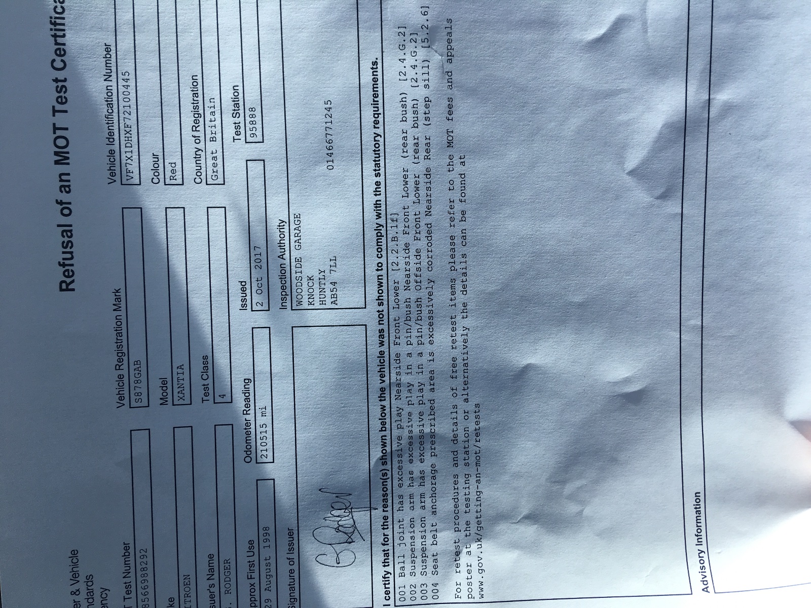

Gabby is wounded. Nasty horrible MOT man
After being hurt with just a thumb she threw her toys out of the pram and decided she wants 2 new p bushes and a bottom ball joint!
On the plus side tester Graham said she is a sound old thing and looks as if she has been loved. So off to see the guy that welded the exact same bit of my activa last year. At least he will know what he is doing this time!

Interesting it's gone there Davie - they usually go closer to the join! Anyway, shouldn't be too bad to repair. P bushes can be a pain - make sure who ever is doing them is either careful with the roll bar, or removes the link to the height corrector, otherwise it can screw up the suspension height! Ball joints can be very very tight....
