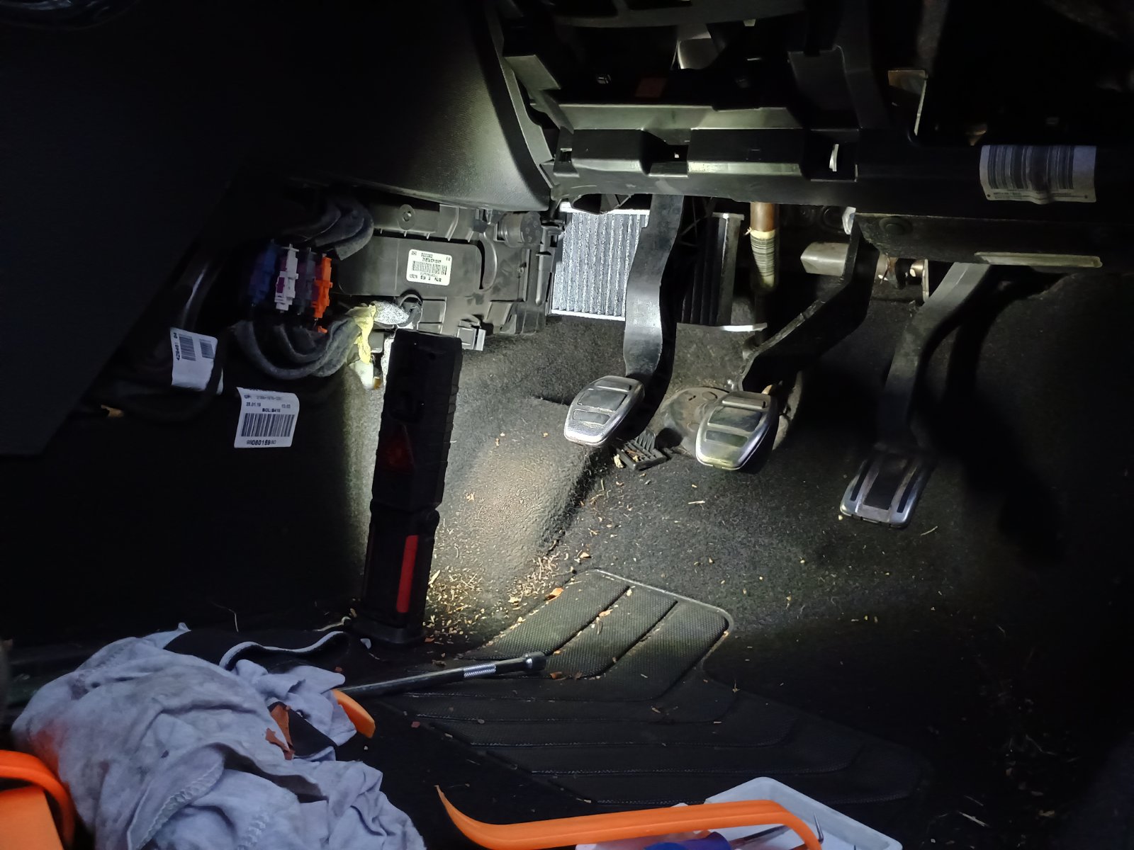

Wiper motor hopefully better,

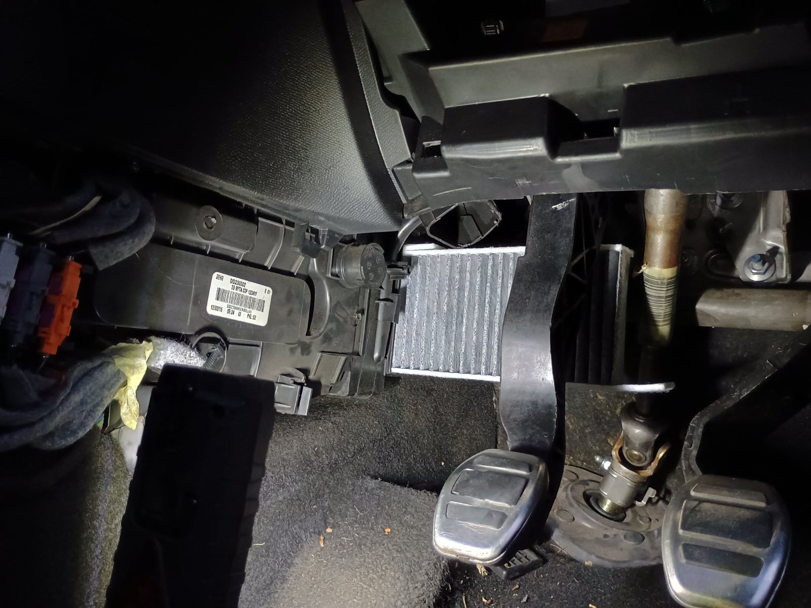

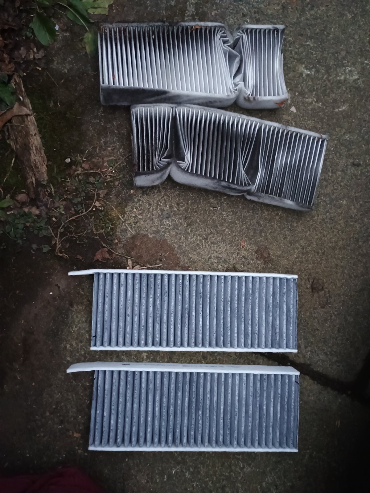

Oh and whilst I spotted where to find it, spot the cabin filter(s) that needed a change:
I made sure to ram the new ones in violently as the predecessors seem to have been! :wink:
Fairly sure they had concertinaed in situ so would have been short and hence bypassing at the far end. Goodness knows when last changed.
New ones are supposed to be "active carbon filters" (hence grey tinge) old ones are not and started off near white!

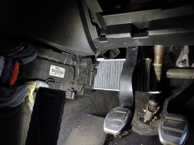

This is where they live:
(Just left of a non-functional clutch pedal :cry: )
Oh, forgot to say: disconnecting steering column greatly simplified getting clutch pedal and bracket into place.
