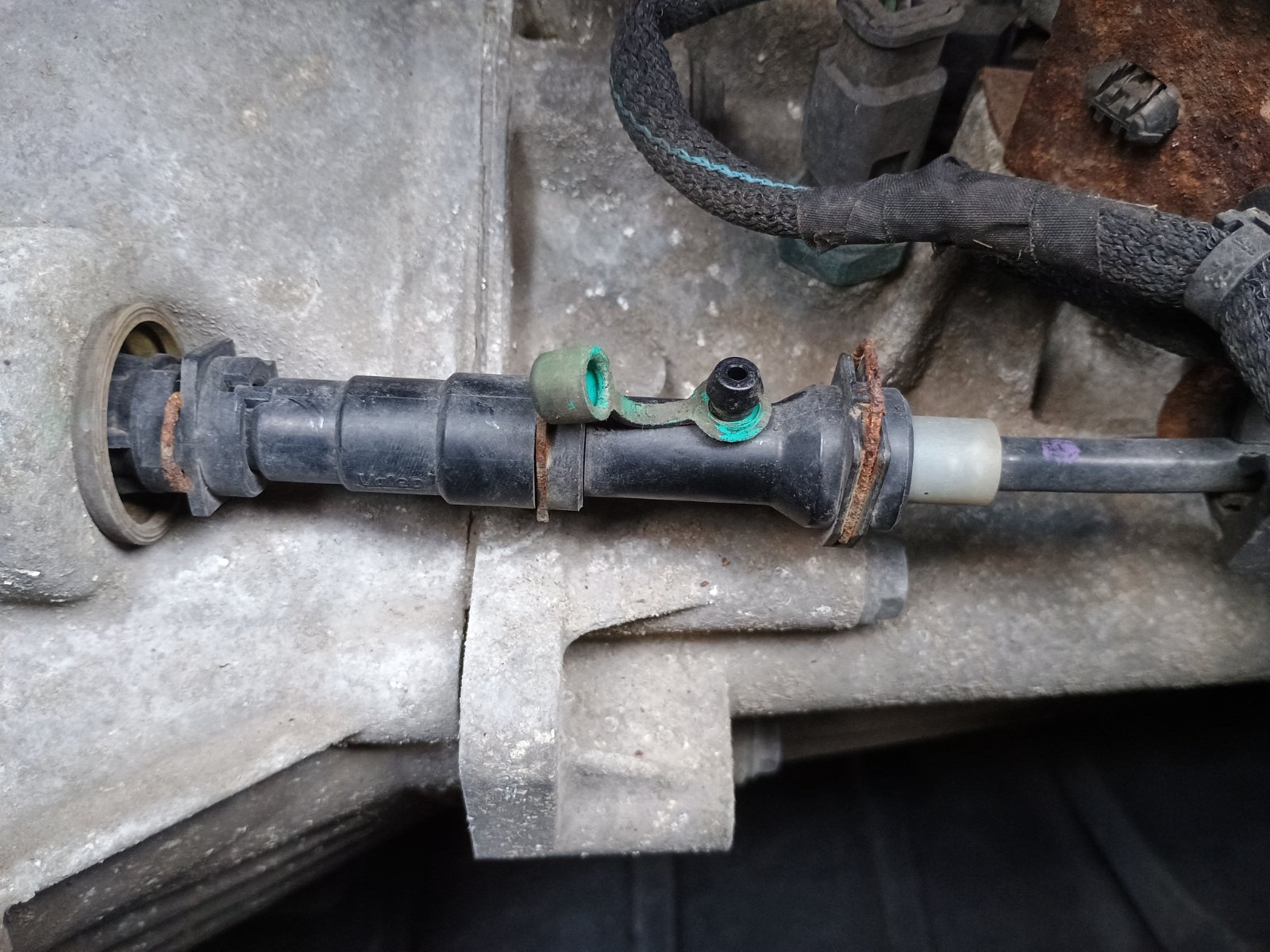

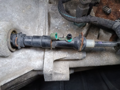

How does this bleed point work?
I'm stuck at present it does not seem to be any obvious way to open it. A quarter turn valve on the C5 but nothing to be seen here just a rubber cap!
Huskyxantia
Posts: 3911
Joined: 30 Jul 2018, 22:11
x 915
Unread post by Huskyxantia »

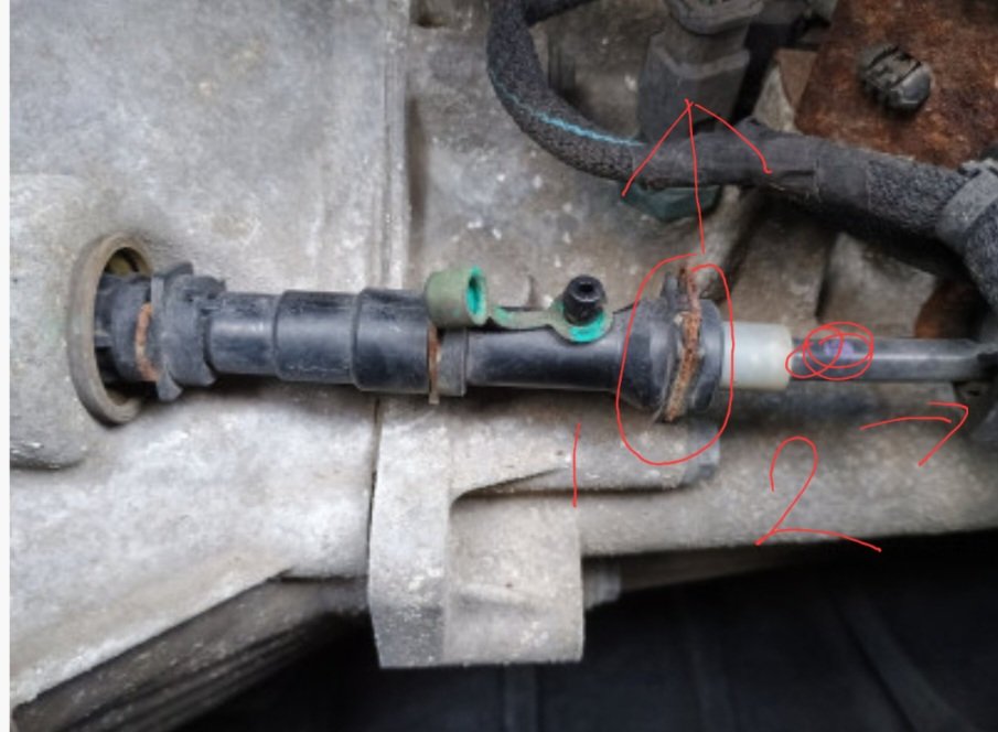

Pull that clip out then pull the pipe
:-D
Huskyxantia
Posts: 3911
x 915
The one closest to the white plastic part on the black pipe
:-D

Clip up , pipe pull out ... slowly it should reach a stop point then the fluid will come out , try gravity bleeding, if no luck then the old way , clip up pipe out pedal down , pipe in clip down pedal up and repeat.

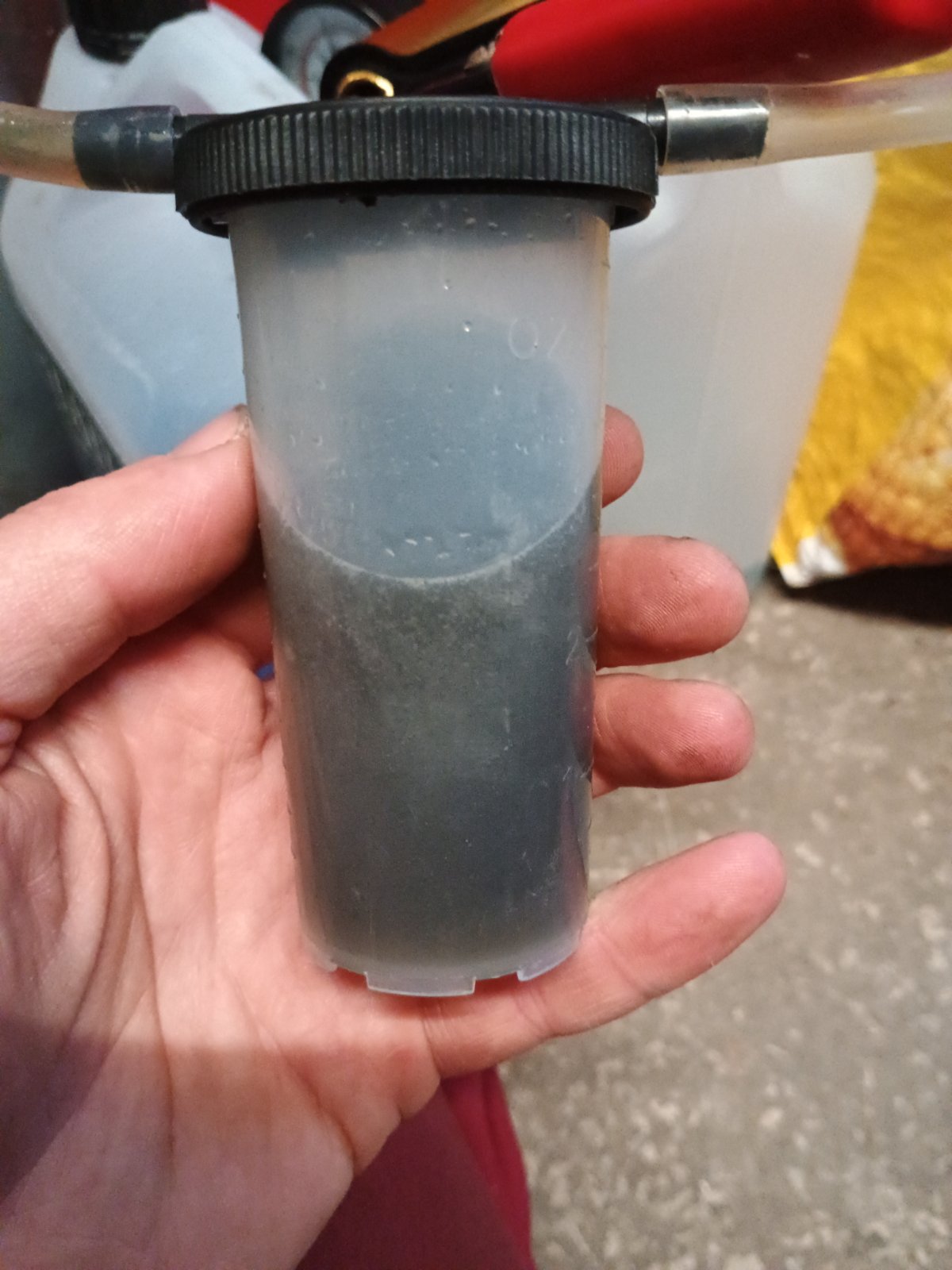

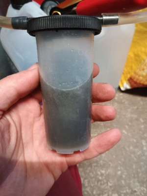

Spot on! Yep, had a play and worked it out. White plastic fitting pulled a millimetre or two back (after compressing the right hand clip - can squeeze it towards the pipe, no need to remove the wire clip) let's you pull back. This uncovered the side bleed hole and, if you don't pull it back too far, doesn't seem to let air in.
Not sure if succeeded yet, combination vacuum bleeder and pressure bleeder at same time! :-D
This is what came out, yuk!
