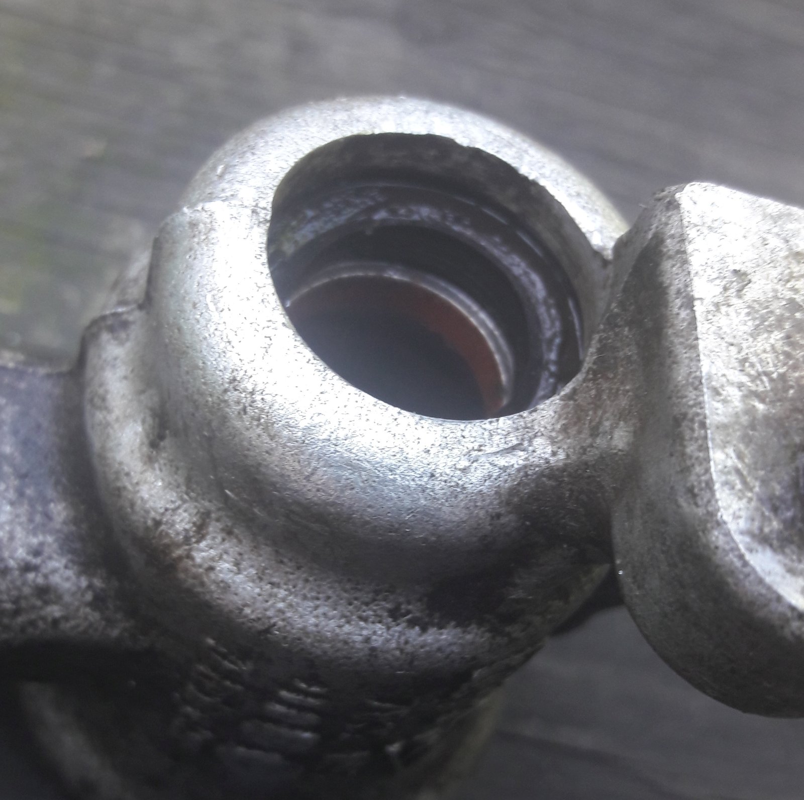

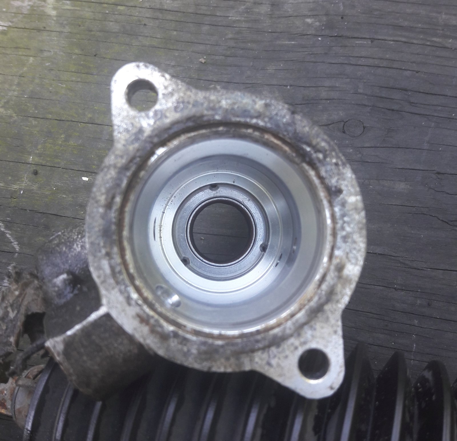

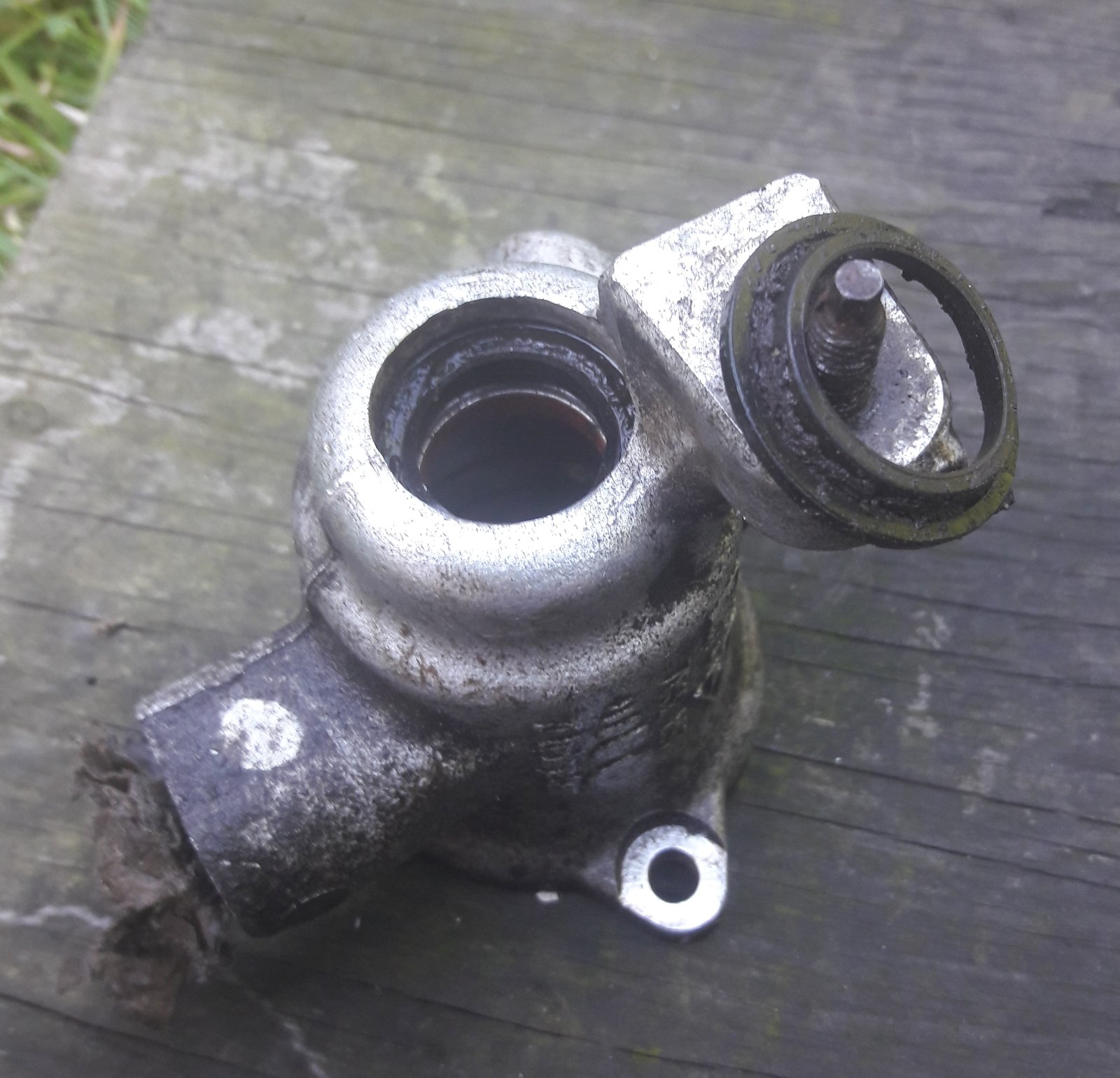

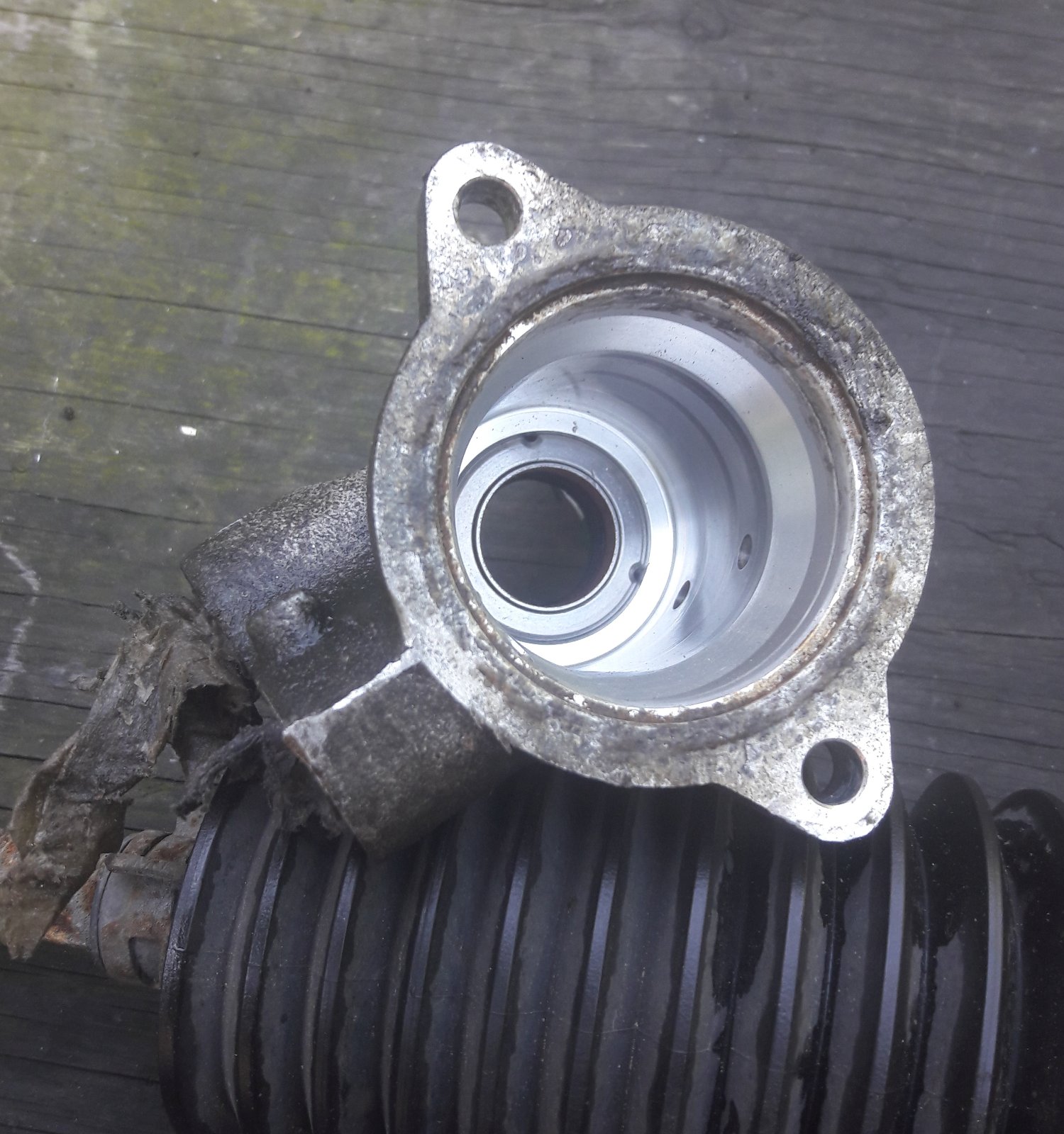

I couldn't resist any longer - so I set about taking my old spare leaking rack apart to see what I could see. And the result is... inconclusive.
After a bit of work the housing came off the shaft. The black ring sitting on the stud is a somewhat useless rubber dust ring that sits uppermost in the housing - this is the rubber seal you can see when you look down at the shaft on a steering rack.
Above you can see the single oil seal (a bit mangled) in the housing, and beneath that there's a thin bushing/bearing sitting in a bigger bushing - clearer on the next picture....
Looking from inside the housing you can see the thin bushing sitting in its larger ring.
See also.... The problem i've got now is how to remove the oil seal. The bushing and ring are in fairly solid and all the time they're sitting there the oil seal can't be removed. I'm presuming they're either threaded in or it's just an interference fit. The three pilot holes around the circumference lead me to think you need a three pronged tool to turn them to remove them.
Although it would be possible to fit a Speedi-Sleeve, unless you can get the old oil seal out to fit a new one, fitting a Speedi-Sleeve might prove a short term fix.
