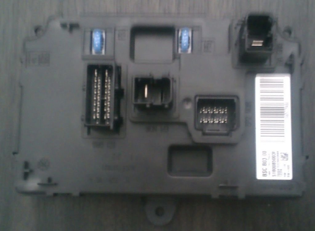

So ... an unexpected gift to myself for Xmas ... I've just bought a genuine tow-bar Citroen module from ebay.co.uk, new ... 90 GBP with shipping ... the thing looks like this (blurry pics from the seller):
Price of a new such module (from the Citroen Dealer) is roughly 200 GBP, so I'd say this is a bargain ... now, I'll probably order a Westfallia hidden tow bar from Germany (some 230 GBP with cheap shipping) in the next month or so, and then we'll proceed to officially install it (the module will probably be done by myself, plug&play in the boot & a DiagBox session for configuration)

Fitted one of these earlier this year (2015), simple job apart from getting the wires from the outside of the car into the boot area, you have to pass all ther wires through a very tight oval grommet - fun!!vborovic wrote: the module will probably be done by myself, plug&play in the boot & a DiagBox session for configuration)
Not sure how much of the OEM wiring 'kit' you bought, but to get the rear parking sensors to turn off automatically you will need the OEM 7 or 13 pin trailer socket. These OEM sockets have small proximity switch which tells the car that the trailer is connected.

We'll see ... the wiring kit is genuine Citroen, all included (without the tow bar ...
) ... which should do the job of turning the rear parking sensors off once something is connected to the socket (if I understood the schematics correctly) ... and it is a 13-pin version, so I'll add a 13->7 adapter just in case (the 13-pins are used only for the "advanced" trailers, ones that have reverse etc ... top range tow trailers or caravans).

That is okay then, the wiring kit from the new control unit (your picture) to the tow ball has everything you need, however, be aware that I had to modify the plate to which the 13 pin socket attached, because, Citroen (as we all know) do things different, basically I had to enlarge the hole in the bracket by about 6 mm in diameter and re-drill the fixing holes to mount the socket, not a problem just a Pain..........vborovic wrote:We'll see ... the wiring kit is genuine Citroen, all included (without the tow bar ...) ... which should do the job of turning the rear parking sensors off once something is connected to the socket (if I understood the schematics correctly) ...
