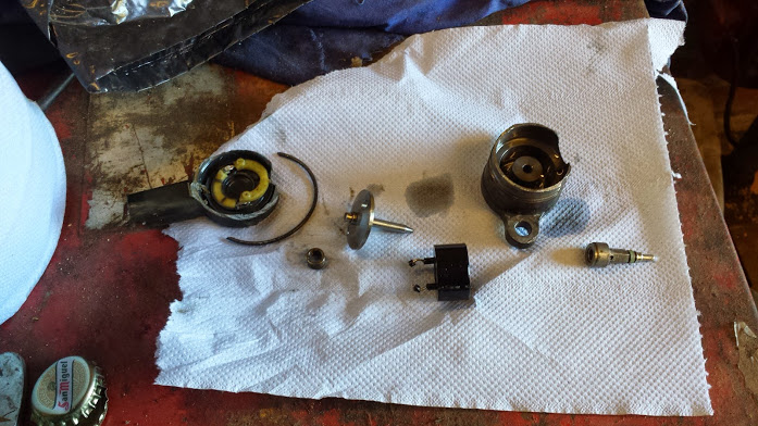

one of my 6 or so pressure regs.. dissected a bit..
chaps. is the filter for pressure reg the small disc on the shaft, far right of pic.. ((often hiding behind a little o ring?) )

No, the filter is the metal tube that faces you when you remove the regulator - very small holes.

Peter I see what you mean now.. the very end of the shaft/tube feels slightly rough? this is the filter.. very fine..
yikes,, will try and clean one with compressed air to see if it helps my issue
But.. All I will do is push the rubbish inside. . And then destroy injectors...
However. . If one clean makes the car start normally I think I will risk it.. to at last know what the problem was... then I guess it would mean a new lift pump.. New reg maybe. . And tthe end of 8 months of easy start
Fingers xrossed
Fingers xrossed

Some of these regulators come without the filter, so I removed it from the one I am using now and its been fine, but if you do that it interferes with the seal so I would be inclined just to grind the end off but make sure you get all the swarf out.

why is it blocking and what will happen when it no longer filters.. worst case scenario (assuming that it is blocking - hard to see even with a close up pic)
- Posts: 11778
- Joined: 02 Apr 2005, 16:11
- x 1240
Re: HDi 2.0 8V wont start when cold - FIXED - NOT - YES
I think its like the 1.6 turbo scenario, its the filter in the turbo oil feed pipe that blocks and destroys the turbo. My filter had metal filings sticking out of it, probably from the lift pump which I have now changed. I had three of these regulators and one was not fitted with a filter so I removed it from the original one and its working fine now.

Fixed,,,,
9 months of easy start.. usually mornings but last 2 weeks, 3 times a day...
this morning, started after 3 turns of engine
omg
Beer for Peter
