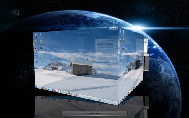

Unity, Jlm. Will be interesting to see the result of replacing Xorg.
One variant of the Kubuntu desktop:
Apologies for the scrolling requirement.

That Kubuntu desktop is rather good looking.

Mint Xfce failed to boot. Downloading Kubuntu now, perhaps Xubuntu would have been a better choice.
The Kubuntu desktop is highly customised.
The 'cube' interface is interesting :)

myglaren wrote: The 'cube' interface is interesting :)
Ohh :shock: That's a bit different Steve...

Re: Computer operating systems
Instead of multiple desktops - or rather a variation on them, you spin the cube then select the desktop you want.
