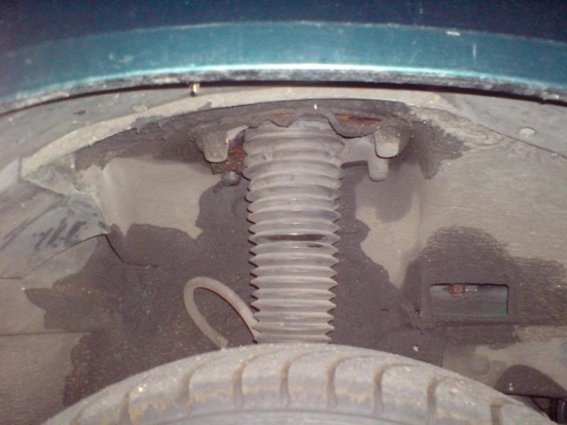

I think it's going.... what to do! what to do! this car has nly done 28K from new - 2 owners and apart from this it's mechanically great, recent cambelt, oil, filters, spheres and hydroclean
bumhats and cock monkeys
Graeme M
Posts: 28673
x 5671
Well worth fixing before it buggers the bonnet.
Car is barely run in.
andmcit
Posts: 4299
Joined: 03 Mar 2005, 17:59
x 30
Unread post by andmcit »
There's no point in plans to scrap it just yet Graeme.
The rubberised lower 'protection' has obviously failed and is now likely
causing more harm than good trapping in the moisture rather than repelling
it; I'd say peel it off NOW to prolong the chances of the strut top!
The main collar plate doesn't look past rescuing with some decent anti rust
and paint protection as there's still some 'meat' to the visible thickness - is
it actually flaking/crumbling up or just rust brown?
The brilliant low mileage whilst being great in respect to wear and tear on
the car could possibly count against you on the strut tops as they've sat for
long periods of the cars' 15+ years without the airflow of normal use to
keep any moisture out! IF the car has sat with the top wet and festering
you really need to examine both tops very closely and plan to source
some good secondhand units or budget for a bit of wallet bashing...
the car is well worth sorting this issue out; there can't be many 28k
Xantiae about the place and it'd be sad to see it scrapped having
barely been used!!
All the best, Andrew
aerodynamica
Posts: 1690
Joined: 26 Dec 2007, 18:10
x 215
Unread post by aerodynamica »
Don't worry Andrew, I'm with you there - I'd never scrap a car with only one major problem! I spent too much on it getting it back on the road in January (when there was NO sign of this a the time) Cambelt, oil, oil filter, 5 spheres, 5l Hydrorincage, diesel filter, 3 wiper blades, 1 pattern part off side leccy mirror, rebuilt front height corrector and new plastic link, 2 front tyres and one replacement remote for the locks. All DIY of course, (except tyres) but still mounts up the cost in parts but flew through the test in January.
I checked the strut tops back in February and although there was a wee bit of deterioration, it wasn't crusty or distorted. They were derusted and painted but now there's a sudden deterioration to this present state - I'm really quite surprised how bad it is so suddenly!
I' say it's a bit flaky under the rubber that's flapping off. I really can't tell for sure how thick the plate is as it's so obscured so without removing both sides I can't tell so maybe it's time for the strut tops to come out and renovate the plates if they're saveable. Balls to buying a set of strut tops at around £100 a pop!
I think it is a ridiculous design fault. If one of these goes on a car cornering at speed it could be an end over end situation :shock: not heard of this yet though...

i dont belive these can be repaire, as i think they are quite complicated, im sure they are not just a lump of metal with a rubber coatting, as they must be sort of a road noise deadening device, which means they will be two picecs of metal bonded together by rubber
regards malcolm

Actually think the collar's all one thickness of metal - or is it mdf or ply?
I've not seen or heard of one fail at speed but then if it did 'go' and took
the car into the scenery the wreckage could hide the failure... :shock: A
discussion about this "fabulous design feature" on Xantiae and Xm's here:
