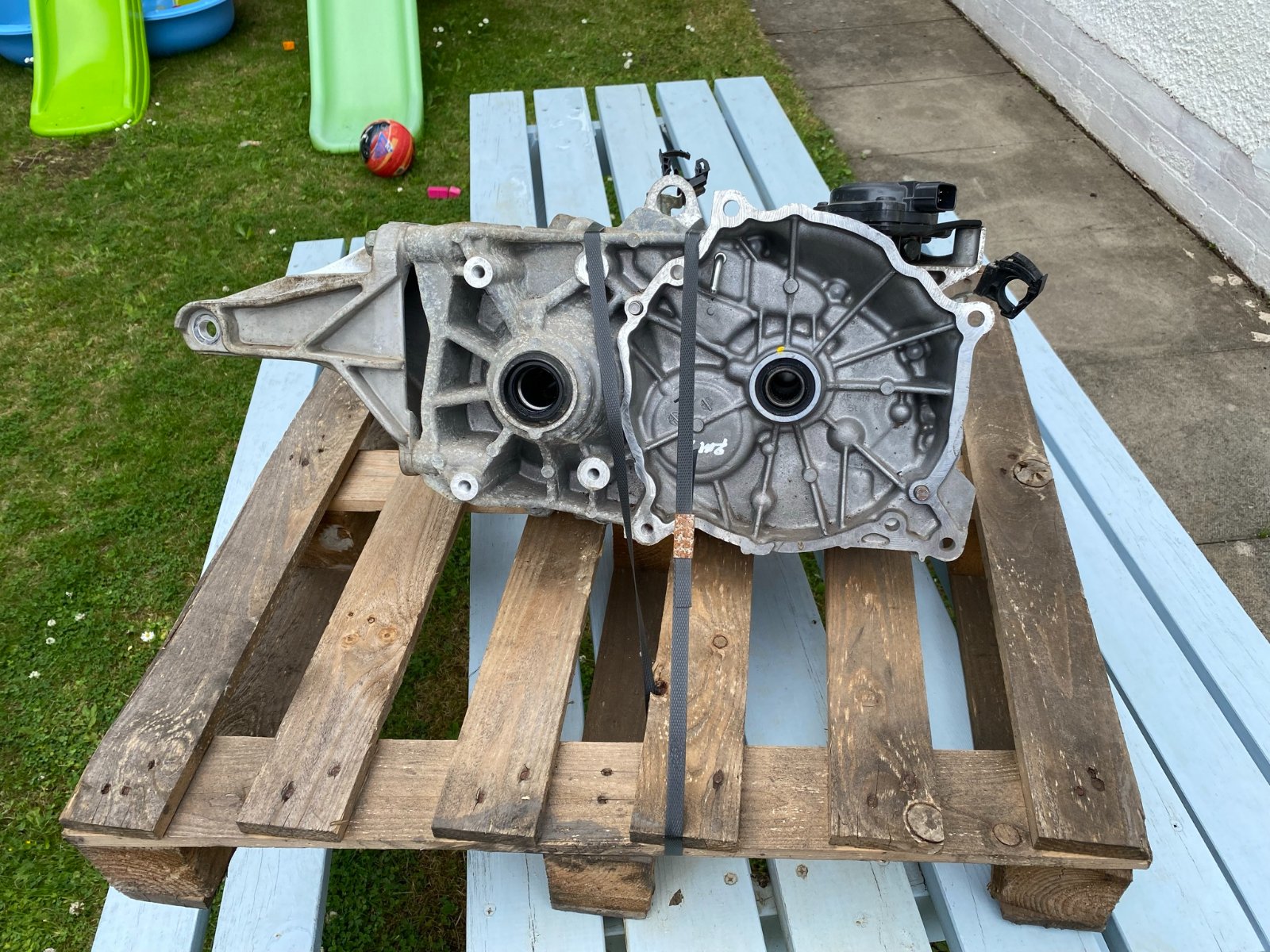

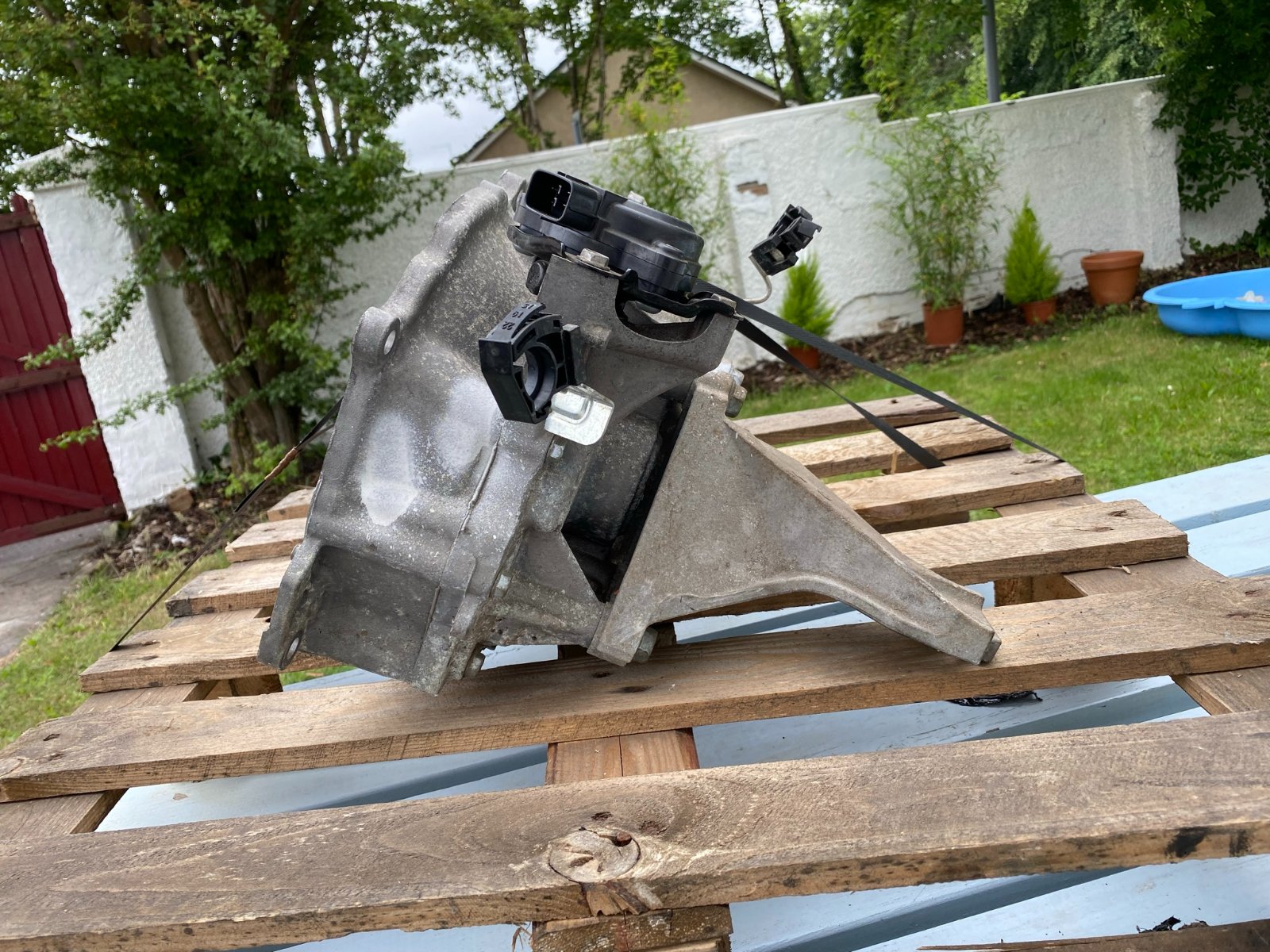

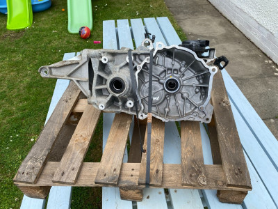

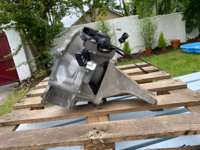

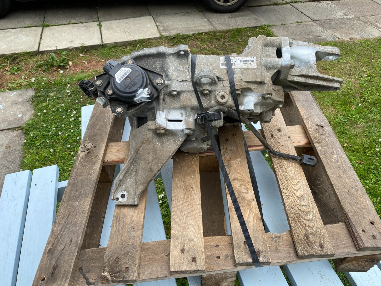

I've been waiting at home today for the Gearbox to be delivered and it has now arrived. :)
It came in a large pallet delivery truck strapped to a small pallet with a plastic cover taped over it.
It seems to be in good condition and I cut the cover off to inspect it before the driver left.
Sadly the pallet is a little too big to fit in the boot of the Leaf otherwise I would have just put it straight in there. So I'll have to repackage it to fit it in the back of the Leaf in a way where it won't roll around and get knocked about. The two engine mounts are still attached making it a bit of an awkward shape. Hopefully I can find a box and some foam at work tomorrow.

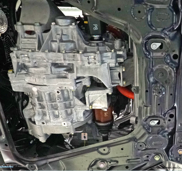

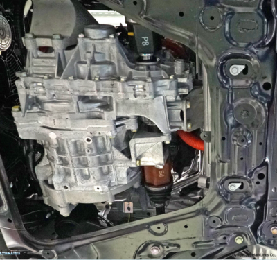

That's the gearbox all padded and packaged into a new box and stuffed snuggly in the boot of the Leaf ready for the car to be collected.
I just need to find who is going to do the job for me. ;) I'll get onto the phone tomorrow to see if I have any luck.
A poster on speakev found a nice underneath photo of the Leaf with the under tray removed which makes it clear that this is a relatively easy job - if you have a two post lift and a couple of gearbox jacks that is! One jack to support the remaining motor/inverter/charger stack which is somewhat heavy and only left with one engine mount, and one to lower the gearbox down..
Without a two post lift and a gearbox jack or two it would be too difficult though.
