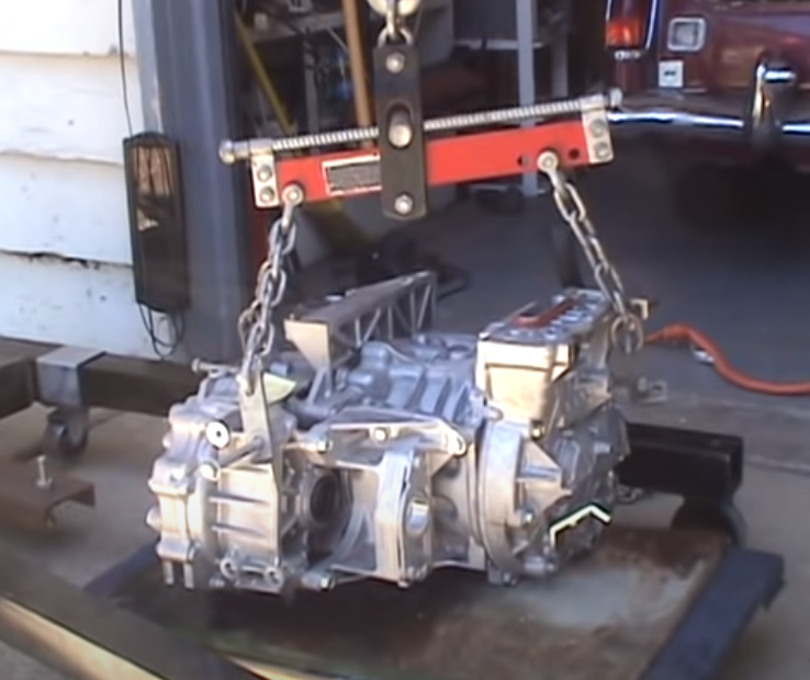

In your earlier video on the tear down you can see it at about 18 mins, not too dissimilar to the later PSA ones, bearing held in by a retaining plate. The housing it is in appears to need to be removed after that as it is bolted to the gearbox and obscures some of the gearbox retaining bolts.Mandrake wrote: 08 Jul 2021, 22:04 It appears to have an intermediate bearing flange on the drivers side driveshaft - I assume this is bolted onto the gearbox and probably has to be detached to pull the drivers side driveshaft out?
When he lifts the box off in the vid at about 20 mins, it doesn't look overly heavy, 20-25kg maybe.Mandrake wrote: 08 Jul 2021, 22:04 The motor weighs 58Kg according to that report but I haven't been able to find a weight for the gearbox yet. How heavy it is affects how easy it is to do the job with manual tools of course...

Ah well spotted - "Item location: Nissan UK warehouse" I presume means this is a new gearbox and therefore the new price is £3,544 inc VAT - that is what I was trying to find out earlier from Nissan to judge the cost/risk ratio of taking a chance on a 2nd hand box. At £870 including delivery that's 1/4 the price going second hand.They also appear to list a full box, at a shade over £3.5k https://www.autofixa.com/320103NA0A/p0/

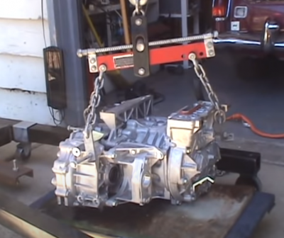

I think I might have found the weight of the box - this video measures the combined weight of of the gearbox and motor at 180lb or around 82Kg:
The previous link stated the motor alone weighs 58Kg so if both those figures are accurate the gearbox must only weigh 24Kg - about the same as Joshua, who I can still lift and carry around.
Does that seem plausible ? In this most recent video the motor does seem to dwarf the gearbox so maybe it is plausible that the gearbox weighs 24Kg and the motor weighs 58Kg.
24Kg is in the "balance it on a jack for removal territory", although the motor also has to be supported by something if the gearbox is removed as two of the engine mounts connect to it.

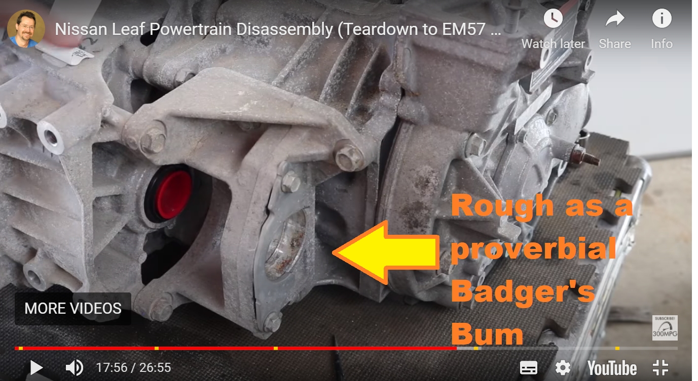

Another thing I notice in that video is the bracket for the drivers side driveshaft intermediate bearing appears to bolt onto the rear of the motor not the gearbox housing and in that video the bracket is still there while the driveshafts are removed - so it looks like it may be possible to withdraw the driveshafts leaving the bracket on the motor although not sure if it would need to be removed to reach the bolts on the gearbox.

I can pick up a 5 spd BE3 box, probably weighs around 40-45kg, so 24kg for the Leaf box looks about right - and right on my earlier estimate. You could probably just lift it off and out from underneath, if you watch Kevin Williams Clutch videos I posted about, you will see he does this with all the boxes - god knows how!! However, there is an eye on the top of the box, I would be tempted to rig up a 4x2 across the engine bay and rope the box up to that to hold it whilst you get it off the input shaft, and then you can lower it out at your leisure.
In the tear down video at 18 mins when he removes the driveshaft bearing bracket, it is bolted into the gearbox, and clearly obstructs the box to motor mounting bolts, so will have to come off.

That bracket with the intermediate support for the driveshaft looks a bit of a potential failure/rubbing point not sure if there is some kind of bearing in that, maybe some of the other bits and pieces can be thrown into the deal for the gearbox, if they are all coming from a decent car. Maybe driveshafts on some sale or return basis should you need them, if they do turn out to be part of the problem.

There's a good pic here which confirms what you say - the driveshaft intermediate bearing bracket bolts between the gearbox and motor:In the tear down video at 18 mins when he removes the driveshaft bearing bracket, it is bolted into the gearbox, and clearly obstructs the box to motor mounting bolts, so will have to come off.
