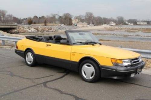

Which SAAB?
I could and should have had some to change the filter in my daughter's second 900 but had none and couldn't shift it without risking damage - it was supposed to have been serviced before sale but was so rusty it must have been there for years.
Like this - most thought it was a 93 but it was a month too early for that badge.
