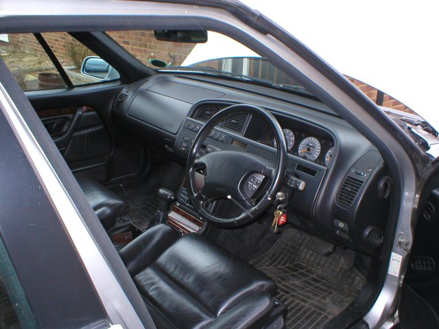

A good day of spanners today...
But first a shot of the engine bay showing the bundle of fun under the bonnet 8-) Doesn't it look tiny!
And the interior. All very black and as cool as a cool thing:
I gave her an oil and filter change this morning. I don't believe the old oil was bad but I always like to do it for my own peace of mind. Whoever did it last had clearly had four Weetabix for breakfast as both the sump plug and oil filter were very tight indeed :evil:
Happily there's no leaks underneath from any component and I was happy to note that during her 300 mile run to Somerset and back not a spot of coolant was used. Unusual as it's my experience that the ES9 always seems to use a bit.
I also bled the rear brakes as I felt there was, compared to the Xantia, just a tad of brake delay. Just a little air came out and I was delighted to see the LHM is very fresh and very green :)
I tried again to get into the gearbox ECU with both the ELIT and Lexia but no joy. That is an odd one and I reckon there must be a wiring fault between the diagnostic plug and the ECU. Whatever is making the gear display flash is not at all problematic as the gearbox works perfectly...
The climate ECU looks a bit unhappy and I've asked in the sales and wants area for a spare if anyone has one. Lexia reports a load of unclearable faults relating to the blower and flaps so to rule out the ECU as the cause a swap of ECU is needed.
Again, it's not a showstopper as the heater works well enough to keep the car toasty warm on a day like today and it regulates temperature - it just can't make the blower run at anything other than half-speed...
I did intend to have the spheres off this afternoon and test them but the weather has intervened and I've decided that perhaps on a personal level I've done quite enough for one day. Maybe tomorrow.
I know the accumulator is good as I can hear the regulator ticking infrequently. Interestingly, the accumulator is a grey one. Also hydractive works a treat too but I do have my doubts on the total happiness of all the spheres and on the ride height which I'll make a separate post.
All in all, I remain very happy with the car and although not perfect is not at all bad. Just enough to do to keep me amused without struggling...
A gearbox oil change will be carried out soon as I've just entered into a deal to split a bulk buy of 20l of LT71141 with a fellow V6 owner :D The present oil looks and smells OK but knowing the box has been overhauled I'd like to change it for as bit of peace of mind really.
