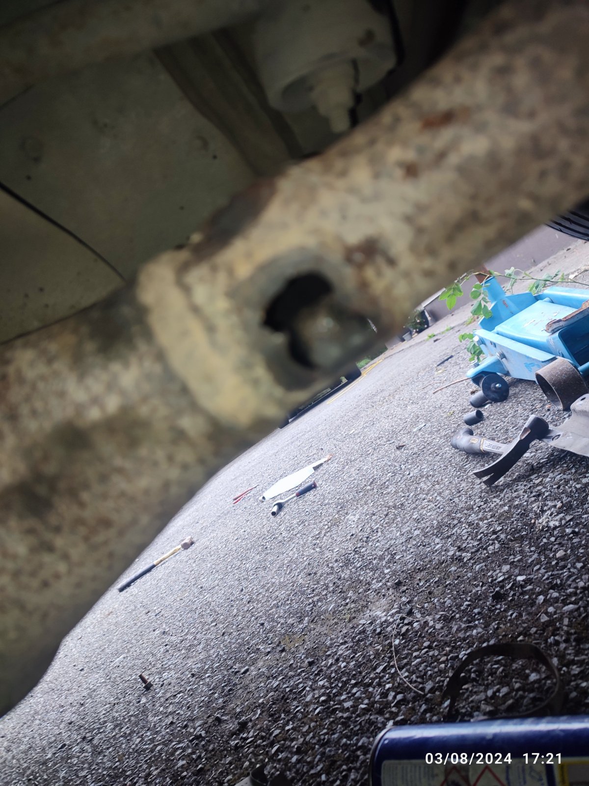

It's a bank holiday weekend here so a bit more time. The weather is patchy at best so far. Her indoors wants me to bring her out for lunch and to be honest I could do with a change of scenery. If necessary I'll work from home on Tuesday and get at it as soon as I am finished. I have the pipe wrapped with two sections of pipe essentially a sleeve held on with pipe clamps. I'm going to get some high temp stove sealant and push it in around the edges. it should last a few years. This is the hole I'm dealing with but I discovered another hole on the other side hence the sleeve. It's right in front of the cat so a weld in that badly corroded pipe was never going to work.

Well I got the exhaust patched using a section of pipe cut in half and sleeved onto the pipe with some exhaust paste and pipe clamps. Regulator in and working on the Primera. I now have a functioning car at least that doesn't sound like it is going to fall apart.

Err, well at least there's no doubt where any noise might be coming from!! Good work on the patching up. It's hard work fixing something you know is going to be moved on - enthusiasm to go the extra mile is hard to find!
