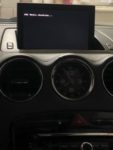

Hi rallerix,rallerix wrote: 09 Nov 2021, 18:24 Hi folks,
In the meantime I have changed the SD card in the RT6 to a SanDisk Ultra with 16 GByte.
Then I unzipped Marc's 2.77 ISO (thanks again!) To a USB stick and burned it to CD.
To make it short: the installation always breaks off with "error during flasher loading".
But one after anonther:
1. Restart the RT6 with the CD inserted: "CRC Media Checking" for approx. 5 minutes on the display.
2. "Flasher loading" (10 sec.)
3. "InitSoft" (1 sec.)
4. "Disk check" (5 sec, then CD ejection)
5. "error durign flasher loading" ... "Product restart in 5..4..3 ... s".
The next attempts always start at point 2 and end at 5.

I know this thread has been quite a while, but I'm just trying my luck here. I'm trying to replace my RT6 SD card as well and also stuck at the same steps, just like what you are facing. My unit is also 2.75 and trying to update to 2.77 which thankfully supplied by Marc.
Have you manage to successfully update your unit? If so, what have you done to complete it?
I just realized from the log that my unit is RNEG2009_EUR_2_70 and giving error upgrading because it doesn't match the 2.77 RNEG2010_EUR_2_70. Maybe that is stopping it to upgrade. Not sure what will happen if I change the Config.ini to match the one in the RT6, will it start to install?

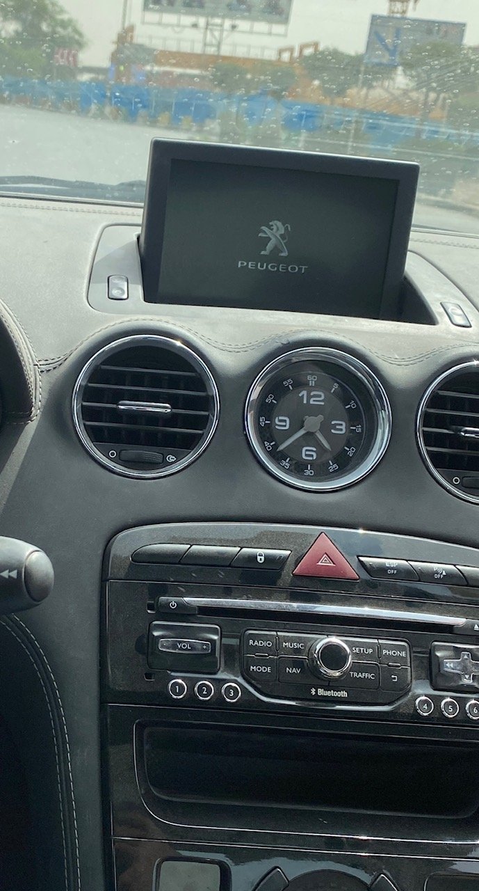

Hello, good morning, I have a Peugeot RCZ 2014
The sd card seems to be broken, but how can I do the MiraScripts you described? Because I do not have a picture
Thank you for your help

I can't help you if yours has got to this stage where it is not displaying anything - have you actually tried the first part of the Mirascript instruction yet? Normally when the system has an issue it looks for certain files in the USB key and will execute the script automatically - assuming your display is working fine this should not be a problem.

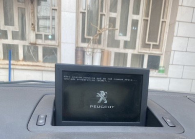

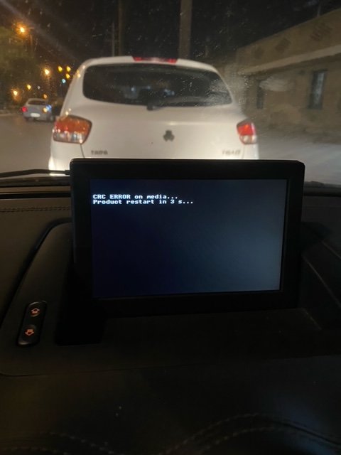

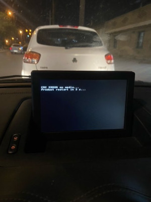

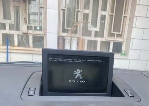

Hello good time
I changed the memory, I did the upgrade process, but it got stuck on this page while installing the firmware, and it took about 2 hours, but it was not done.
I tested again, but when I insert the firmware CD, this error appears now
firmware 2.80 tested
