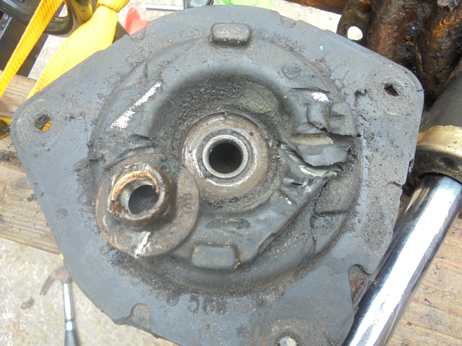

Needed some bits off the old strut, so had to dismantle it. Would have been nice to preserve the top mount, but did need the gaiter and the rubber bumpstop or whatever it is. Knew there would be difficulties, no change that into impossibilities, of getting the top nut off. Because its recessed it collects water and rust welds the nut to the threaded part of the strut. Yes there is a 6mm allen key slot, you put an allen key in there, and take an 18mm ring spanner and the nut unscrews easily.....only when the car was brand new in 2005 I'm afraid.
Dug out the Lidl/Aldi improvised spring compressors again. Work perfectly.
So here is the carnage, but when the new parts arrive, all the bits required to assemble the new strut will be in place.

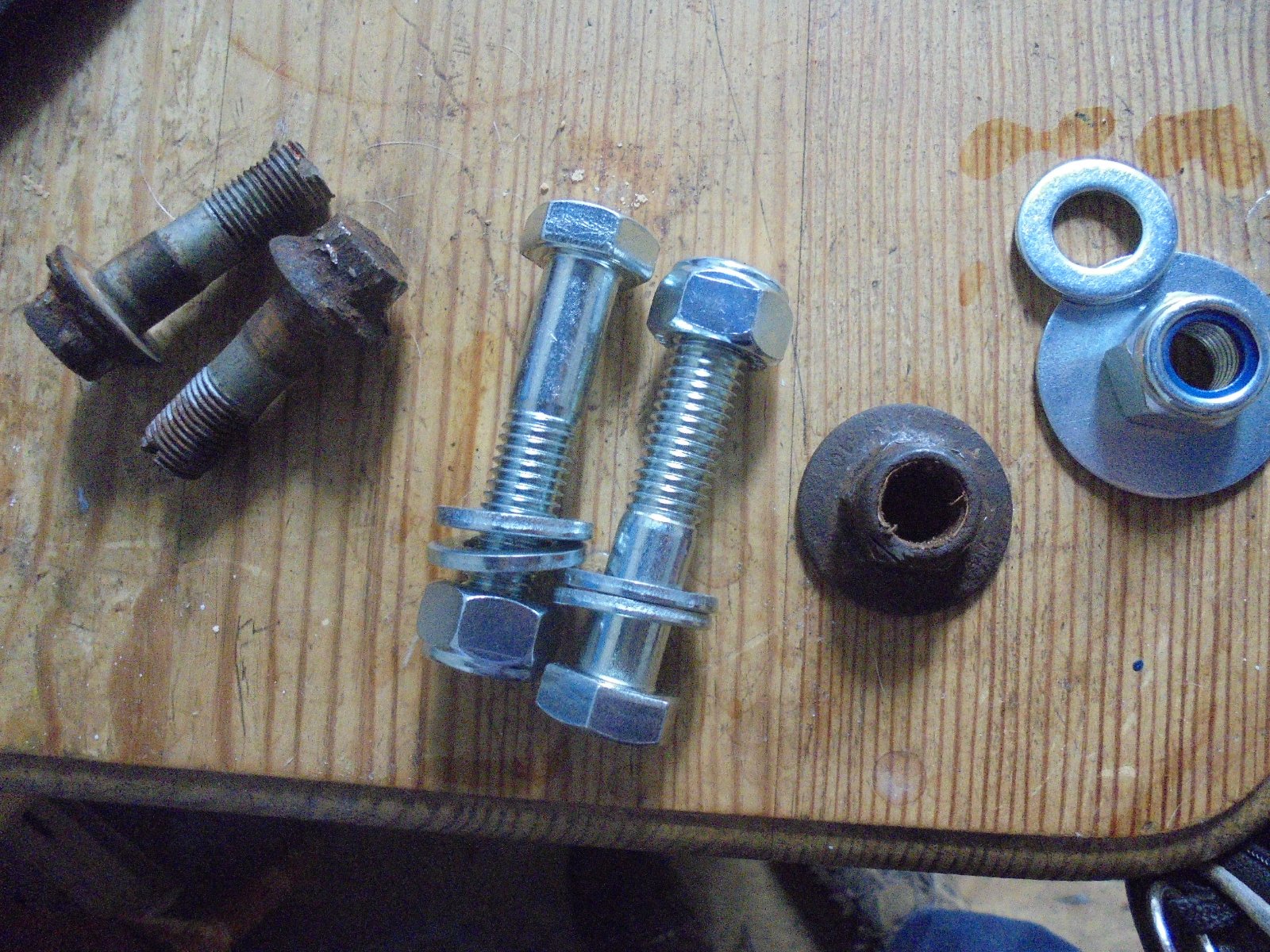

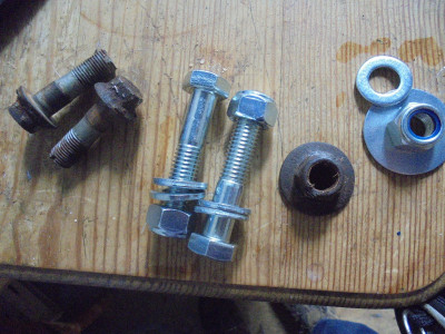

Downside of the ordering of parts with the free delivery option, you can't get on and sort stuff straight away, and you aren't totally sure at the start of the week which day they are going to arrive, although tracking of shipments is pretty good. So mine are arriving today all being well.
Meantime, of course the bolts for the strut had to be destroyed so a visit to the local agricultural engineers Aladdin's cave of stuff has appropriately produced "new bolts for old".

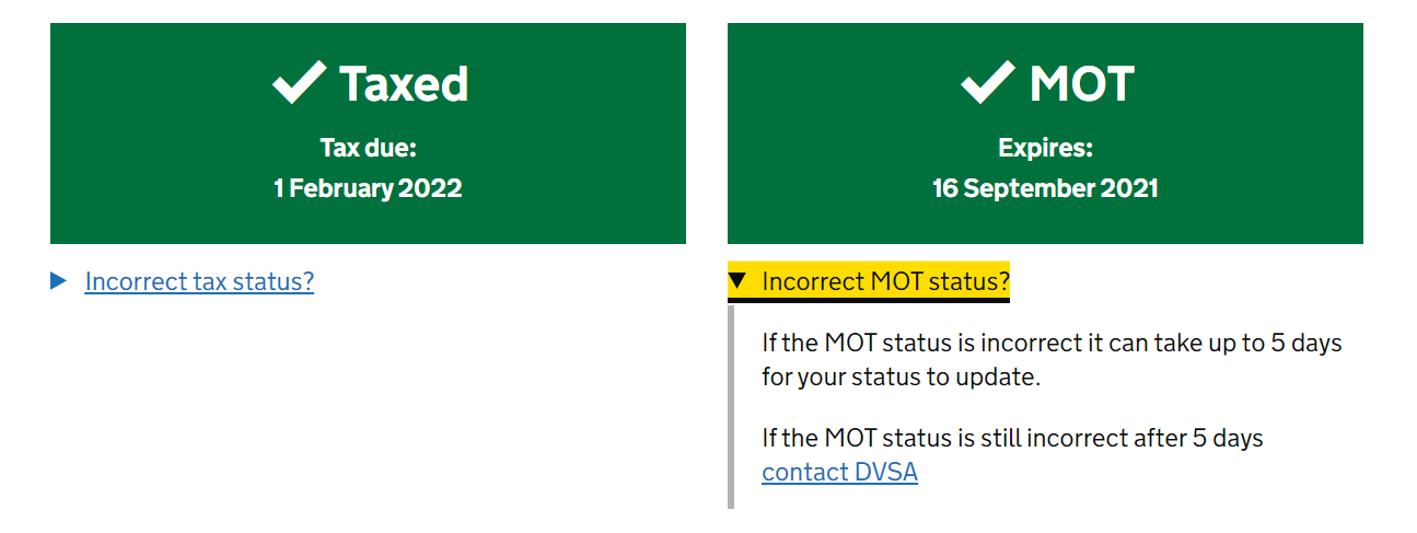

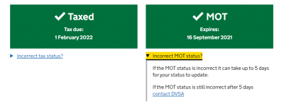

Micra is in the twilight Zone at the moment. Failed the MOT on the Coil Spring, now replaced, but having to wait until Monday for the MOT all clear. Looked at the DVLA MOT and Tax enquiry and its all green. Taxed and with the original expiry date of the MOT still unchanged (Early test was a week ago yesterday).
All the MOT is is an assessment of the vehicle on a particular date, and the next assessment required is on another date 12 months hence, so the validity of the MOT remains until that date. I have probably confused the system by submitting the Micra for 2 months early one, as the original expiry date has not been updated.
At any point in the year, MOT failure faults can develop whether this be tyre wear, or indeed coil springs breaking. My early MOT test identified the coil spring problem and its now fixed.
I will not take the chance of driving it around this weekend, but were I stopped, a check with the official DVLA records would show
It has been just over 5 working days, since the failed test so maybe it would go red sometime next week. Won't be able to test the theory out because its back on Monday to hopefully get the new ticket! and the new expiry date.
More a curiosity than anything else. I do hold the view that if it has failed the test then until you get a test pass certificate, whatever the DVLA website says it shouldn't be driven on the roads other than back to the MOT station.

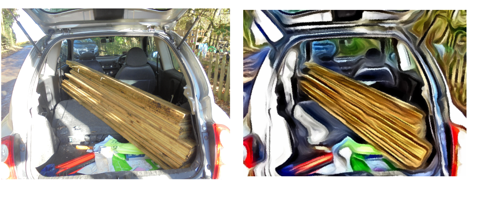

Re: Bargain Basement Motoring
BB Micra got the nod today, but one of its normal allotted duties collecting timber fresh and wet from the preserver tank at the sawmill.
