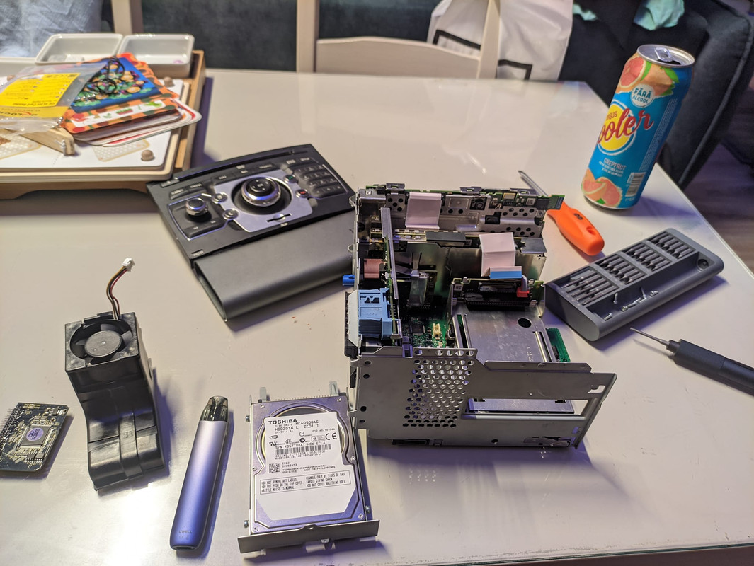

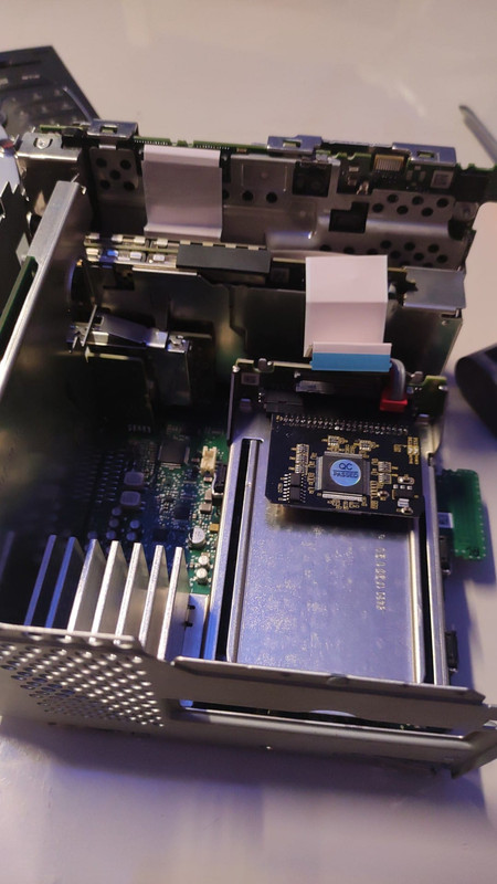

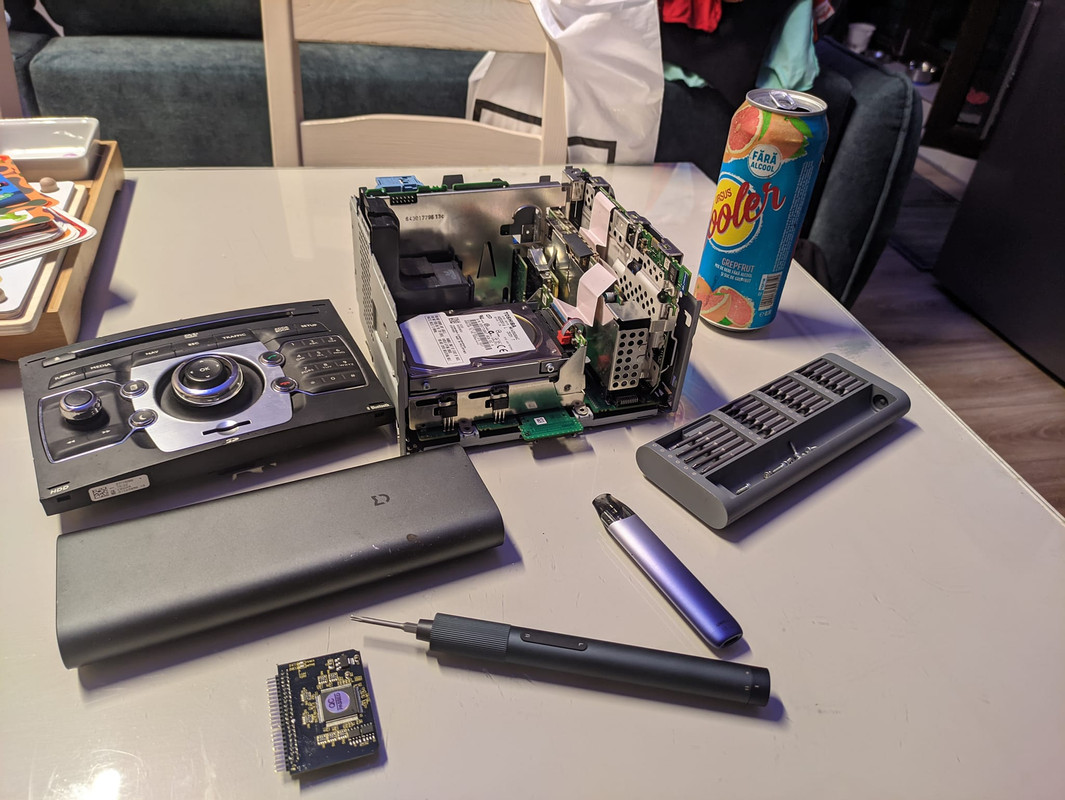

So here we go, in a rainy weekend i started this project.
I have purchased the 44 pin IDE-SD card adapter, 64 GB card formatted FAT32.
Now i'm also thinking about changing the cooler, for a faster one. I found some coolers with 12.000 rpm, the original is only 5000 rpm. Man, the unit was so hot when i removed from the car taht i had to wear gloves.
Now i'm going to the car, hopefully the harness will be long enough as i have RT6 on my Citroen C5.
Wish me good luck guys

Nice pictures on the inside!
I still haven't opened my unit, but my options are running out fast, so I'll likely go there too.
Is that fan 4cm size and does it have some label on it?

Re: Guide to Replacing the NG4 Navidrive 3D Hard Drive with a CF Card
40x40 mm, 18 mm wide, with 3 wires. The label says
Y.S.TECH
DC BRUSHLESS FAN
FD124020EB
DC12V
0.12A
Y.S.TECH
DC BRUSHLESS FAN
FD124020EB
DC12V
0.12A

This one is not on a heatsink, this is supposed to take out the hot air from the chasis only.
Things went well, i only need some time to test it and I'll get back with impressions.
But it's promising!
But it's promising!
