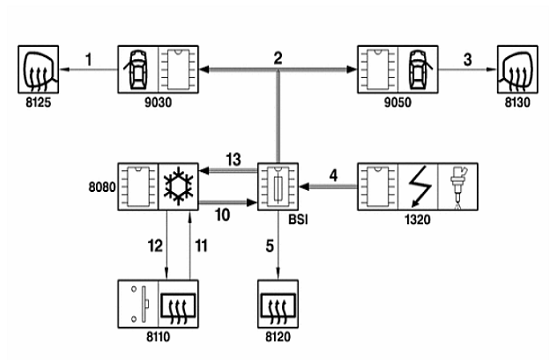

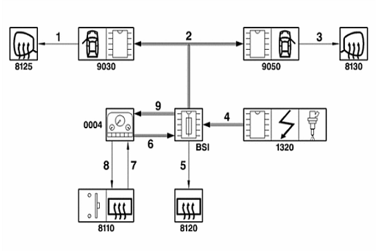

I pulled up a diagram for a MK1 so it's not specifically your car, James? But it shows three fuses in the heated screen circuit.
One's a Maxi Fuse to the BSI. Then two for the BSI HRS relay itself; the main switched power to the screen and another for the relay coil.

Having the VIN would of saved putting 2 diagrams up, but this is the wiring depending on your system. As you can see, the heated windscreen on the version with automatic A/C is routed via the A/C ECU.
Single Air Conditioning Components
Single A/C Connections
Automatic A/C Components
Automatic A/C Connections

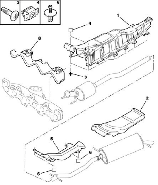

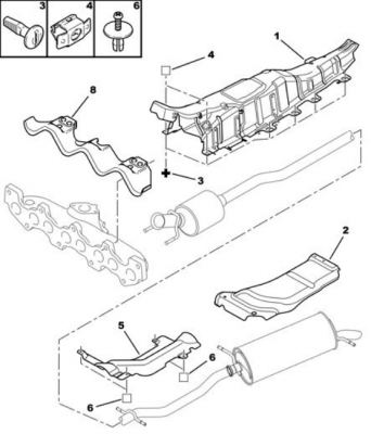

I am making slow progress with things (although there are DEFINITELY things I will get PTS to do). I currently don't have my Citroen manuals installed, so can somebody (probably Marc!
) let me know the part codes for the clips that hold the heat shielding in place around the exhaust? She is making a horrible noise (not the creaking of the rear arm bearings), and when I looked underneath I saw the heat shielding was sitting on the exhaust.

Here you go:
3 - 7013V8 (Rivet) - 58p 4 - 703018 (Clip) - 34P 6 - 153916 (Rivet) - £1.80 |

Thanks, Marc.
