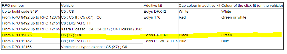

Your build date is 02/04/2012 (RPO 12929), so your X7 will have originally had Poweflex Additive filled at the factory and should have a blue click fit connector. will have Extend and will be a Green Click Fit:

A C5 X7 with a build code of 12929 takes Eolys EXTEND and should have a green click fit connector.
Part no 1623961580 for a 1 litre kit or 1623961680 for a 3 litre refill kit.

I've just corrected my post - as I read the 'Except C5 X7'.

Its easy to miss the ‘except’ bit.
It should be noted that when it says black click fit this means the colour of the cap in the filling kit, not the fitting on the car.

If you get your RP number found on the bottom of your tyre pressure label & your vehicle model the table above will tell you which fluid you need.
Dont use PAT fluid, i find it amazing that PSA have 4 different fluid types most of which cant be mixed with each other but euro crap parts sell ‘uiniversal’ PAT fluid that goes in every PSA car with a DPF. Make your ownn mind up based on that.

Your RPO is 12126, so the fluid is 'Eolys Extend' which is used on the C5 X7 from RPO (build date) 12076.

I did check that door label and you're right. 12076 is build date.

I think you typed the wrong RPO - 12126 is your build date. 12076 was the date from which this type of Eolys should be used. So Eolys Extend is what you need
