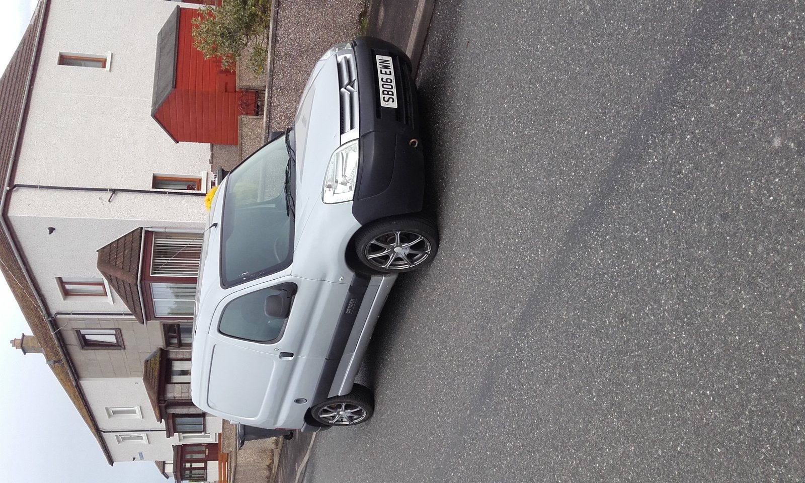

Good road adhesion Davie!

- Posts: 14310
- x 3296
Re: Davie's french attraction.
Nah, that is average adhesion (I mean, I have seen BUSES with that level of grip). For GOOD adhesion you need to find a decent overhang, and then go hooning on it!
With 17" wheels you will break the eggs when you cross the ploughed field
Its a big jump up from 175/65x14 rusty bald and perished steel wheels to 215/40x17 front and 215/45x17 back alloys with 4 relatively recent tyres! The rear wheels now look a bit /-\
I hope its just looking like that because they are much bigger and not cos the axle is going. I would not have put on that size of wheels if they had not been lying in the shed anyway, and I probably would not have bought the van needing 4 tyres if I didnt have the wheels and tyres lying. The wheels suit tha van far better than they did the xantia though
