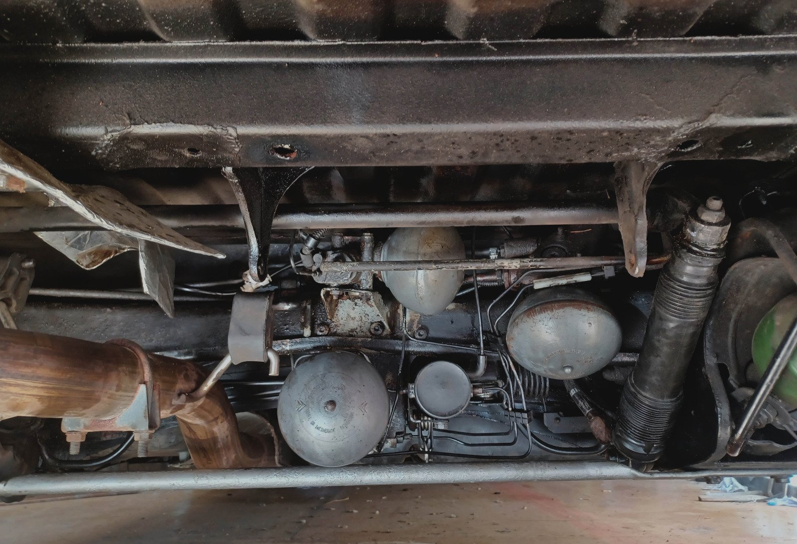

Spheres tested, max 2.psi pressure drop in 6 years.
Leak fixed, had to replace the return (3 point) from the electro-valves to the underbody return line.
To do this I am "experimenting" with Push-fit Pneumatic connectors and PU tube. I first tried some very cheep ones (China?) which were LHM safe but leaked at the seals a little, I have switched to (in comparison) some quite expensive ones with twin seals and these passed a long term "low pressure test" ( a clamped syringe ) so I have now progressed to a On-Car test.
All nice and dry again now.
Lets play ----SPOT the Push-Fit Connector----

Those spheres are doing very well to hold pressure so well Alasdair
A nice crop of mushrooms you have growing there!

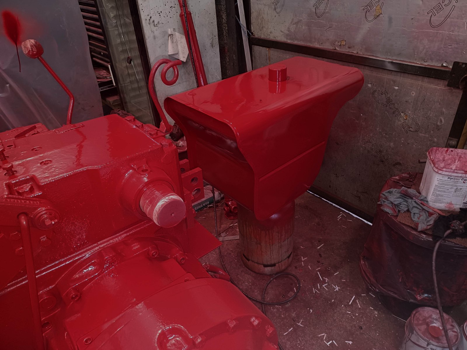

Recently.... I have mainly been painting a tractor

Is that red or blue Alasdair

- Posts: 11838
- Joined: 28 Mar 2013, 21:05
- x 1996

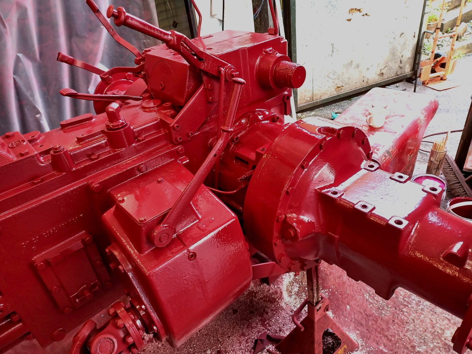

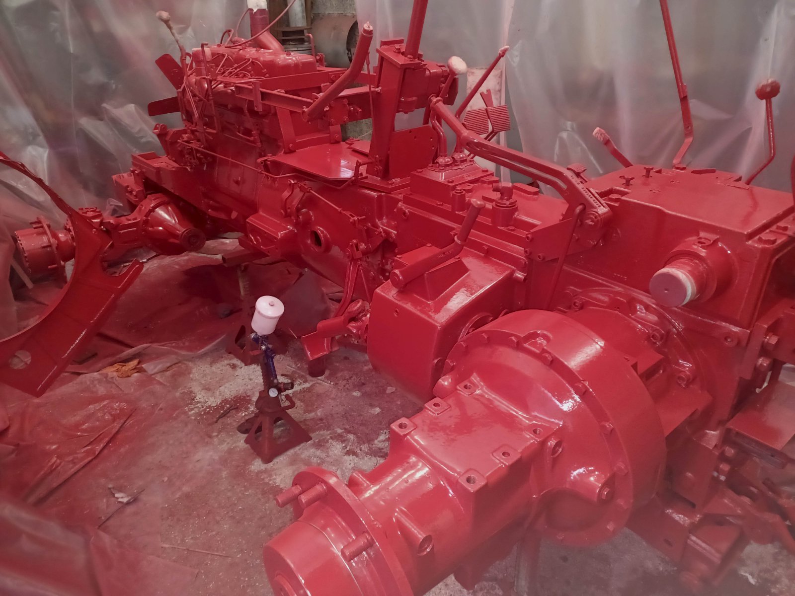

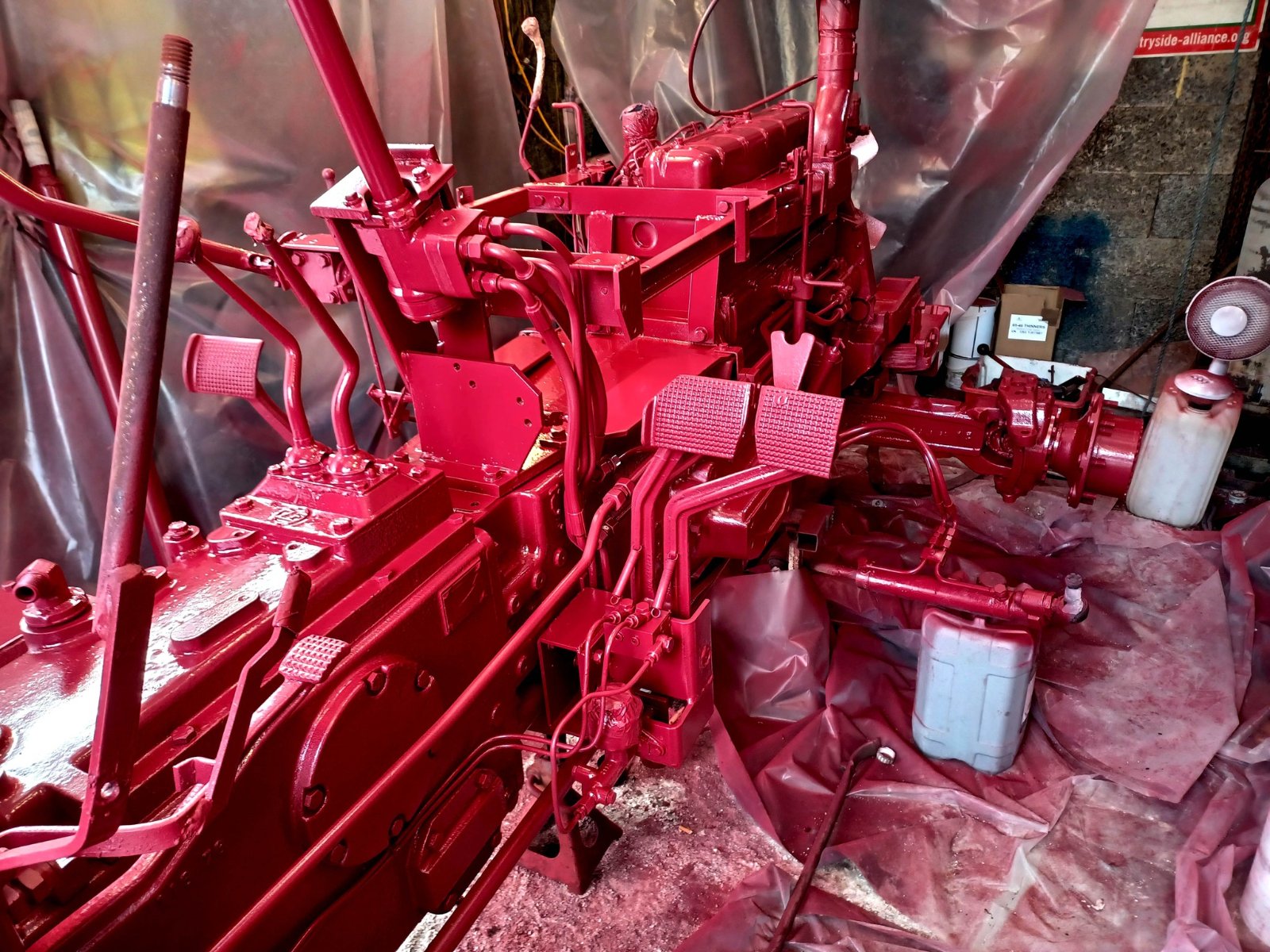

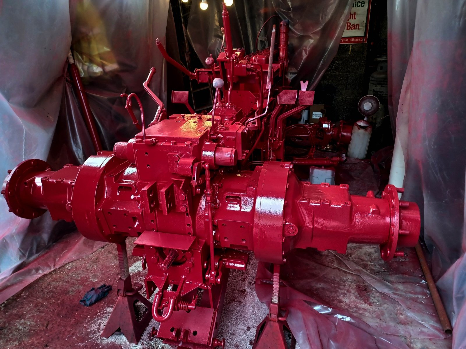

Re: I am an Activaist-v6 and a 2.1Estateerr
It was a day to make red a bit "redder"
Apparently the 1st colour was for an earlier type of International tractor and not this one.....so on with some new paint.
- Posts: 55135
- x 8415
My goodness, that's proper red
I see nothing escaped the sprayer
Good work Alasdair and I'm looking forward to seeing it for real soon
