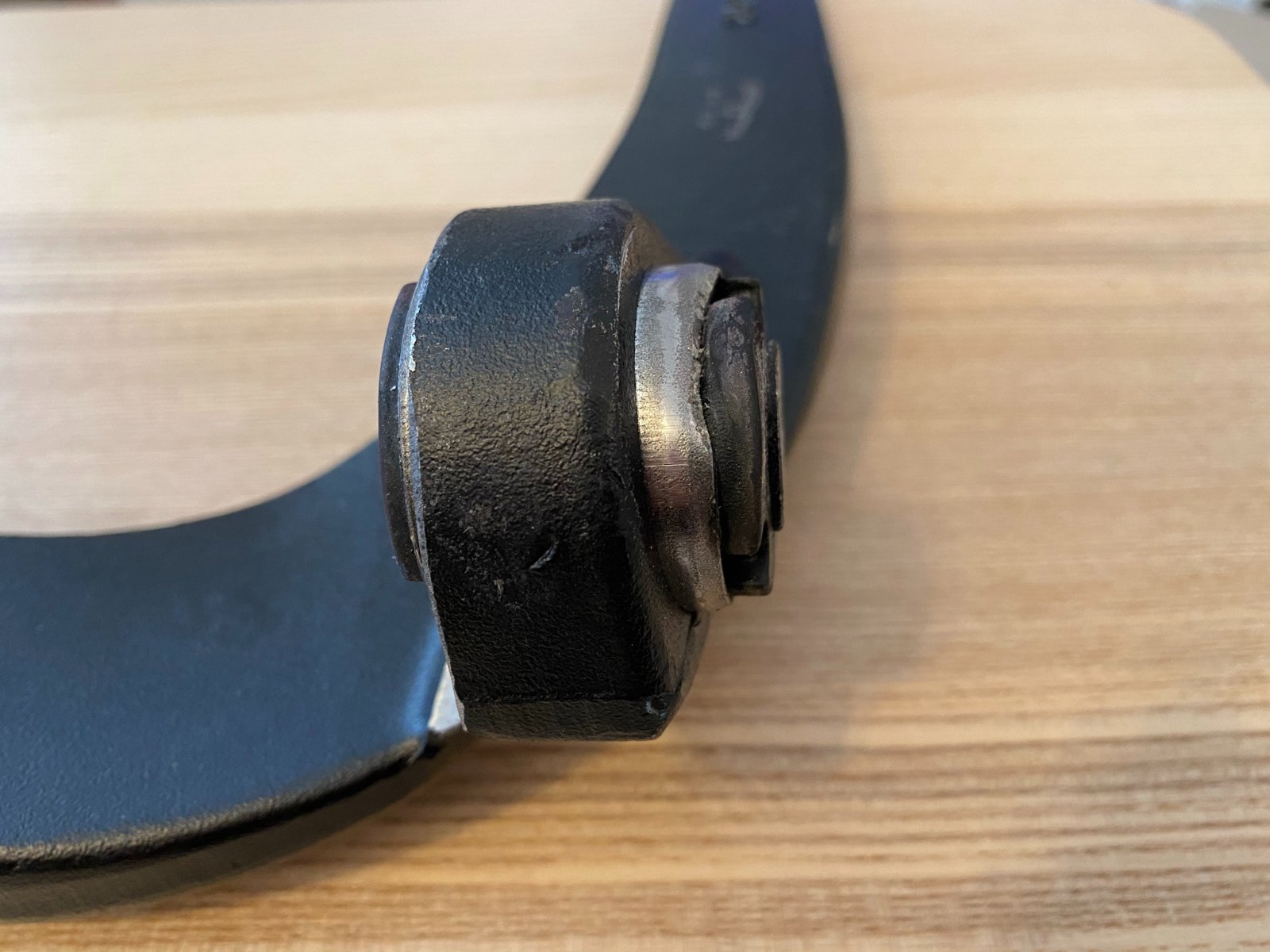

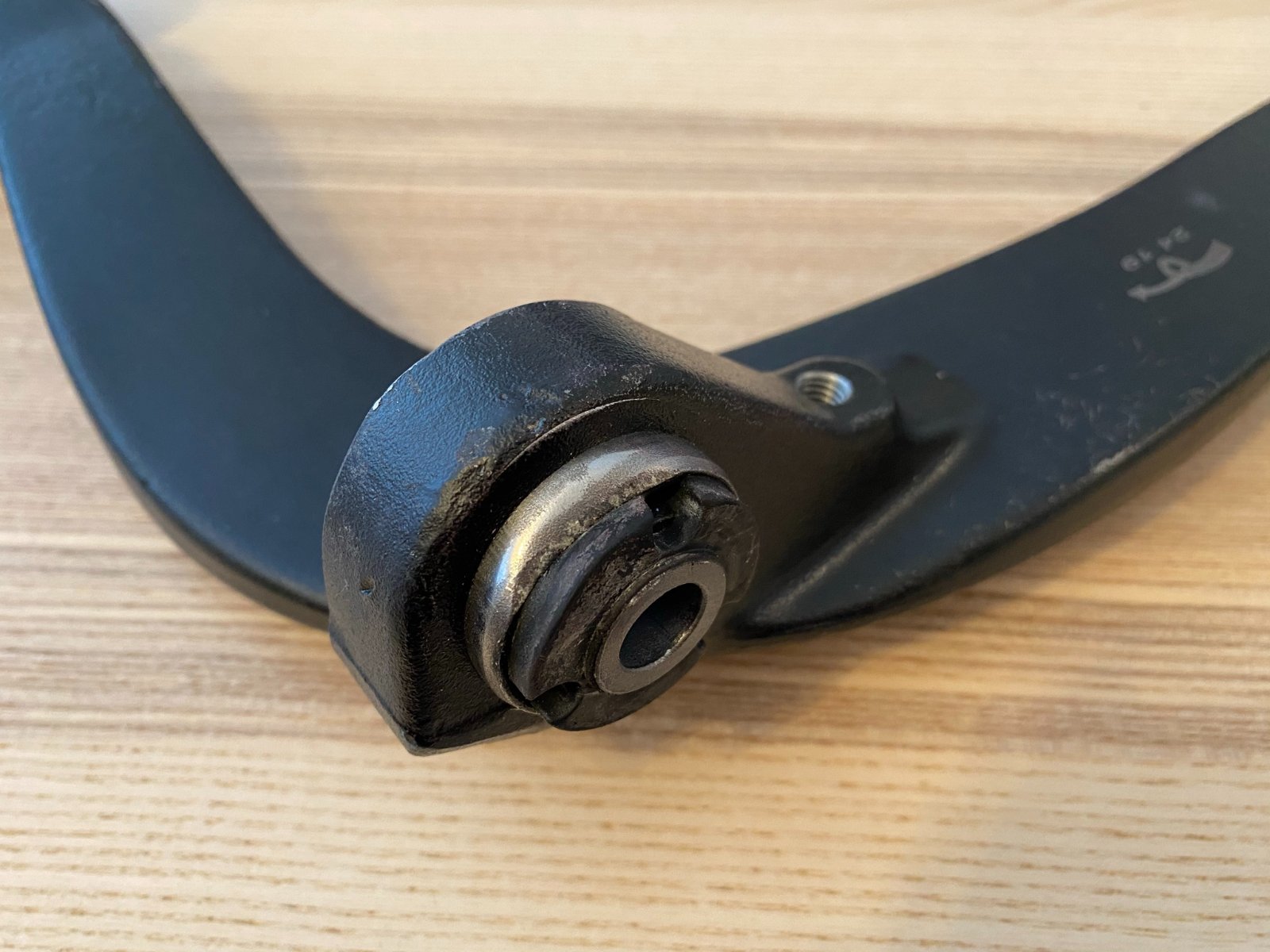

More frustration with the suspension arm...
First time I received an empty box, then they resent the arm which arrived last week (but I've only had a chance to collect it from the inlaw today) and someone has decided that just wrapping it in a black plastic bag with no padding is acceptable.
It just boggles my mind how slap dash this is.
Predictably, it's suffered a fall somewhere during transport (probably thrown into the back of a courier van) which has bent the metal frame around the front bush:
The bent over edge is far too stiff to straighten with the bush in place and the sharp edge is digging into the edge of the rubber a bit which might cause it to cut into the rubber with movement.
So the question is what to do about it? Just make do and hope it will be ok or send it back for a refund and yet another delay and possibly having to pay return postage?
Really not happy, and very unimpressed with the lack of care in packaging and sending this arm on both occasions.

Mail them a photo of the damaged item and the "packaging".
Ask for another, for immediate dispatch.
Return the damaged one, if they ask for it.
Disgusting.
Mister Auto would have sent one of those out in a gigantic, padded box, if my delivery from them today is anything to go by.
Disgusting.

The odd thing is that I've had loads of things from CarPartsInMotion from small parts to coil springs, and they've all come - without exception - well packaged and without issue. I don't think it helps that the courier depot that serves Simon's area appears to be staffed with neanderthalswhite exec wrote: 20 Apr 2021, 19:46 Mail them a photo of the damaged item and the "packaging".
