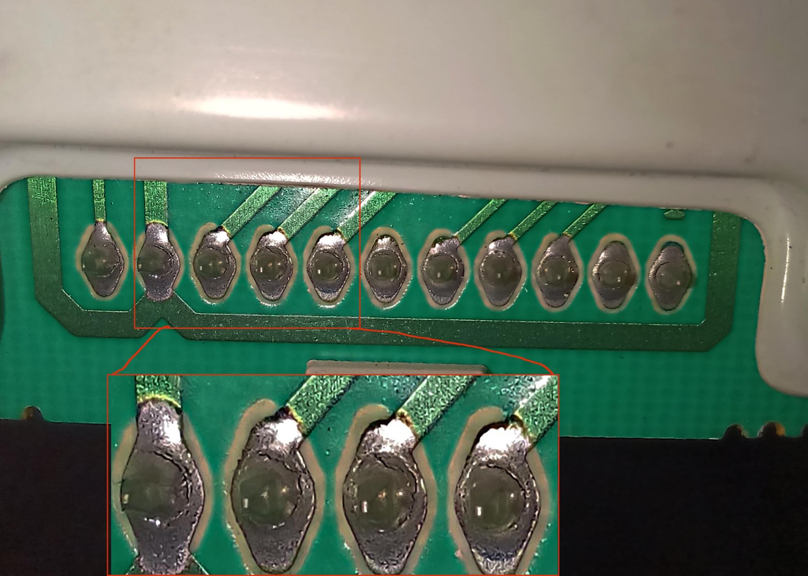

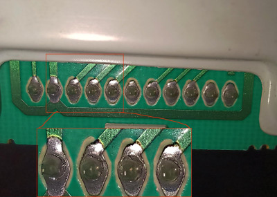

I removed the dash for fix some dead bulbs (headlamp lights high/low beam bulbs and one of the speedo) and chase down an Intermittent fuel gauge.~
Gauge was "sticky", moving it through its full arc a few times has fixed that.....it was tight from about 1/4 up....I slowly worked it up step by step until it moved by blowing on it and falls back cleanly and at a constant rate now.
I changed the bulbs but funny things were happening when I reattached the connectors and checked.... I am glad I did !....... time to resolder all the connectors on the dashboard with LEAD !
Small sample....they ALL show signs of fracturing so I will do them all even if "good"
Posts: 55048
x 8378
Re: I am an Activaist-v6 and a 2.1Estateerr
Yep, those joints are properly dry! Well spotted!

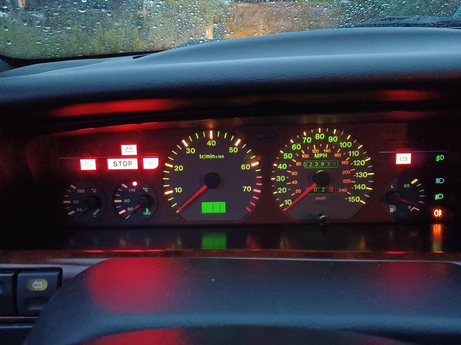

All fixed now.....
BUT....can any Xantia Nerd spot the change I have made to the "illumination"...........(no, not LED)
Posts: 55048
x 8378
There's nothing more satisfying than all bulbs being present and correct on a Xantia dash :D
The digits on the speedo and tacho look greener than usual and from memory I cannot recall the major speed markers being white with the minor ones being green?
I'm sure I've missed the obvious...
Posts: 14306
x 3306
The rev counter, where the numerals are, appears different to me.
Posts: 11824
Joined: 28 Mar 2013, 21:05
x 2000
Unread post by Stickyfinger »
Well spotted chaps.....I have removed the green from the main markers to improve "quick glance" of speed/revs (The green is better without the flash going off !)
