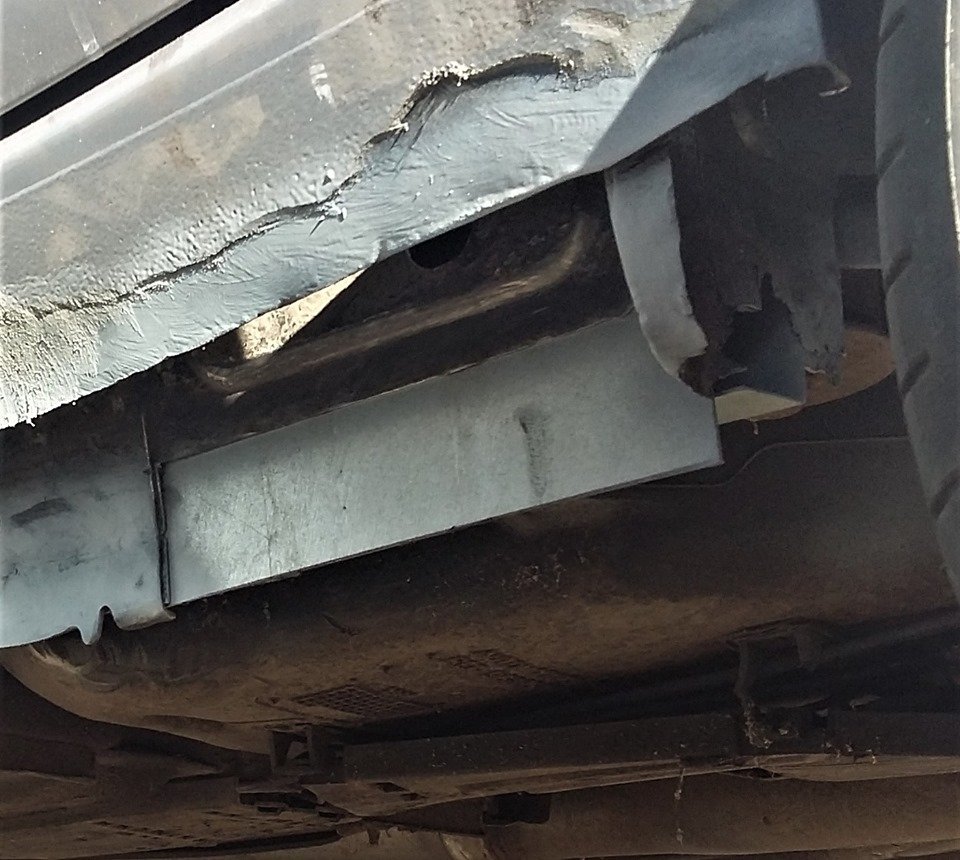

Thankfully solid in that area....I still have to make the edges neat etc, but on advice I will wait until I have the section cut from the LatTIVA they tidy them both together to get a close fit.
I will make plates for the inner sill box section, replace the the lower sill seam and ensure it is level (add seam seal where needed, Zinc weld through primer) then close with a small end plate and apply Bilt&Hamber cavity wax, only then will I cut the outer sill section from the other car.

Roughing out the repair sections for the lower edge of the inner sill.
I will tack these in place and make the end plate ....I will then take it all off and fold the lower edge of a shaped piece to fit the lower edge as per the original outer sill, before bending it up to the cut top edge to remake the outer sill.
I will then take it all off, seam weld the new inner sill piece in then fit the outer sill and again seam weld it, then hide the dressed weld under new stone chip.

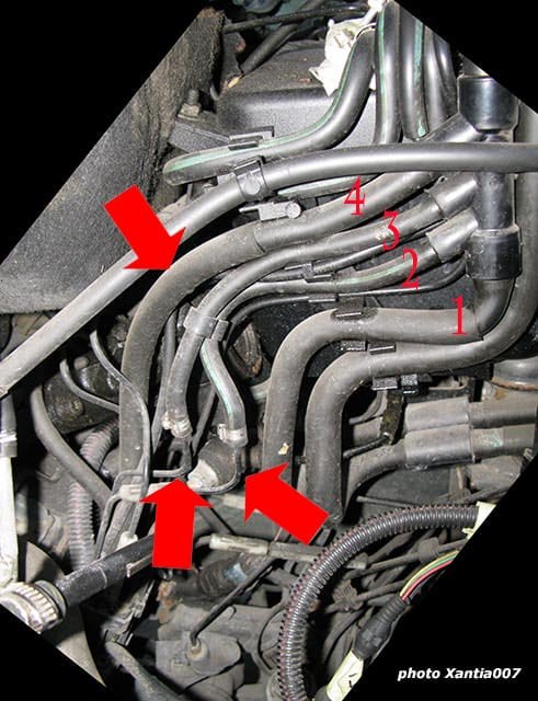

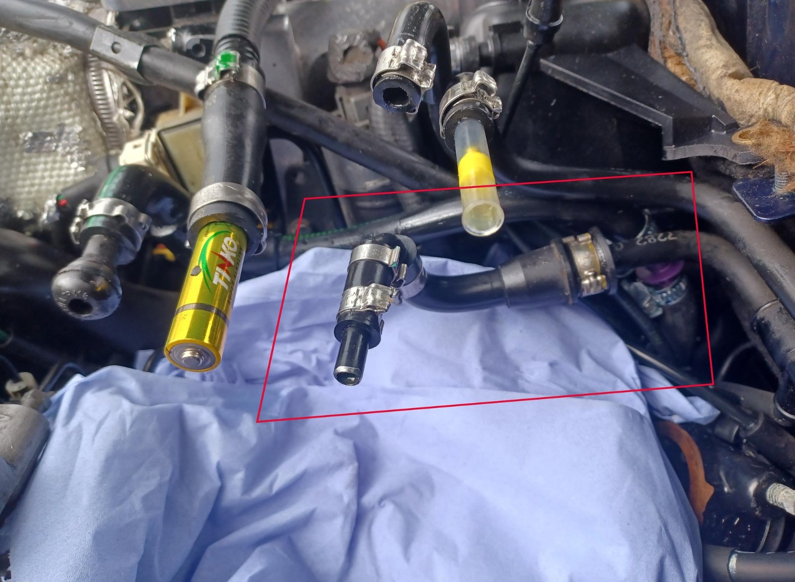

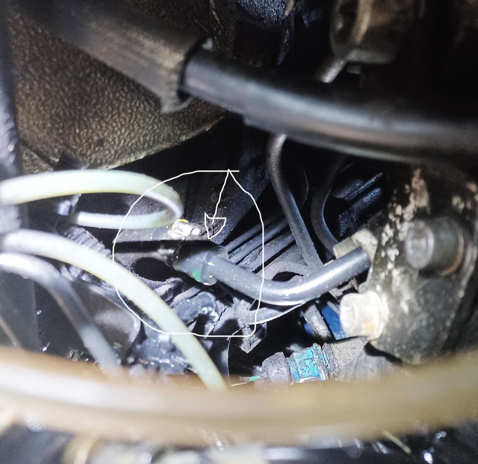

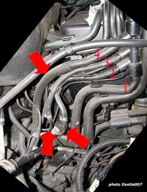

Grrrrr....leak from the pinion return pipe connection.....that is a total bu@@er to get at.
this is how the pipe runs down to connect to the pinion leak off pipe
I need to splice in a section of pipe (into No4) .....anybody got a 3 fingered long armed child I can borrow ?

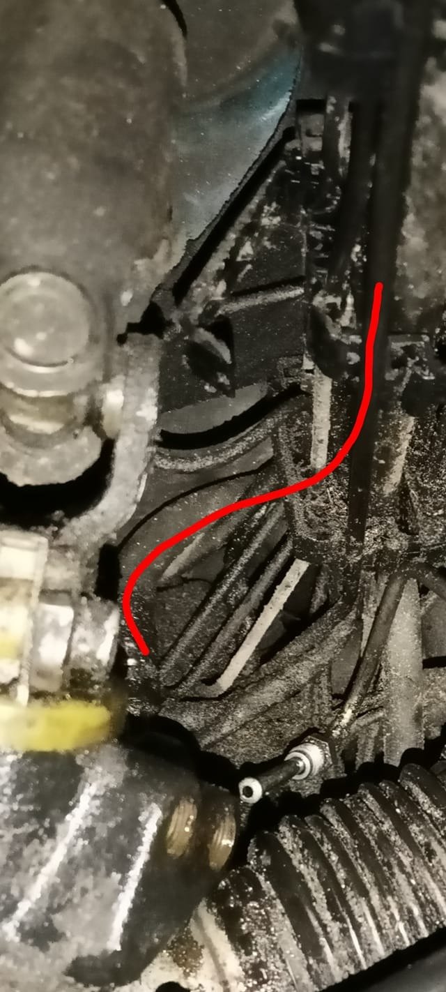

Re: I am an Activaist-v6 and a 2.1Estateerr

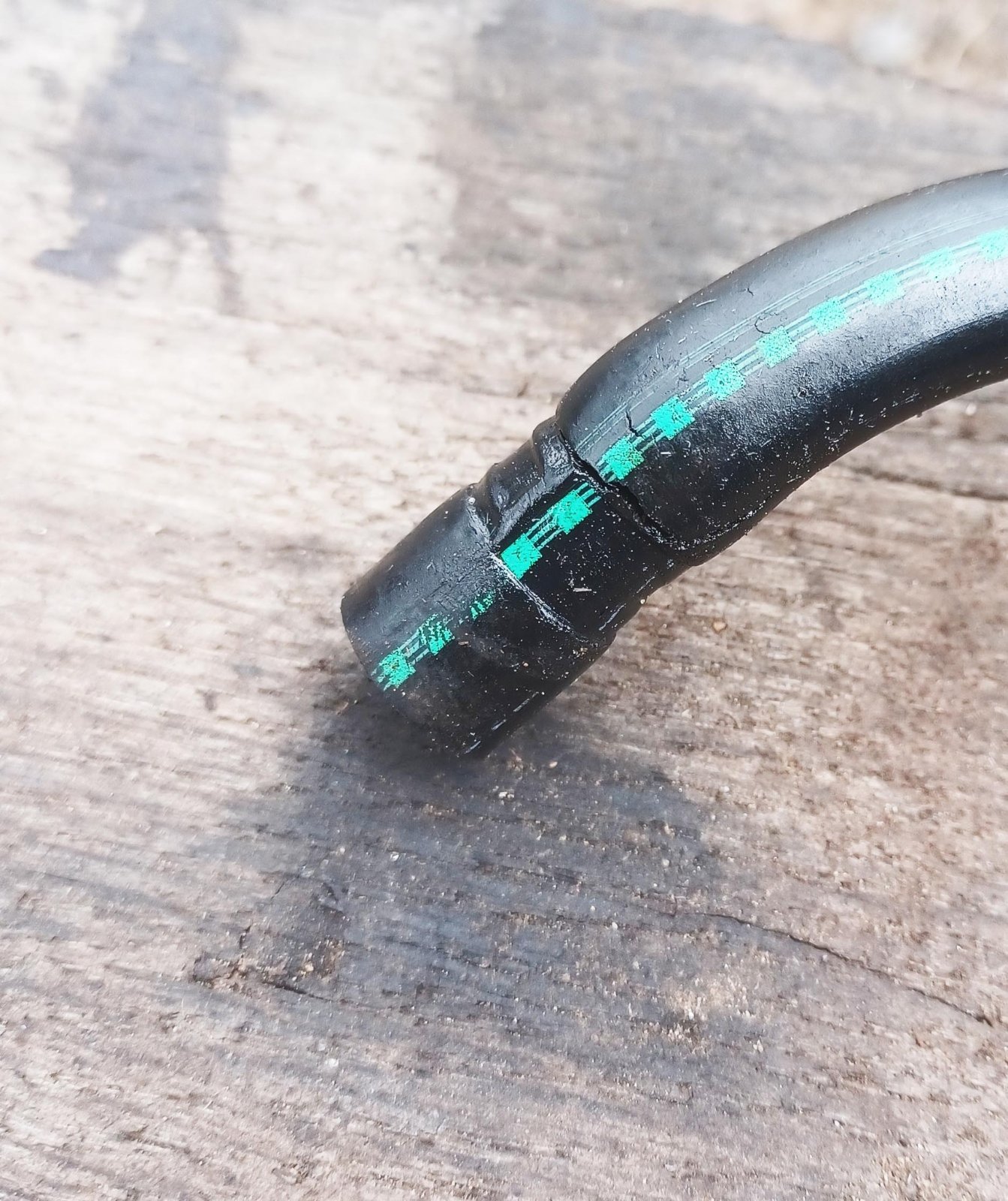

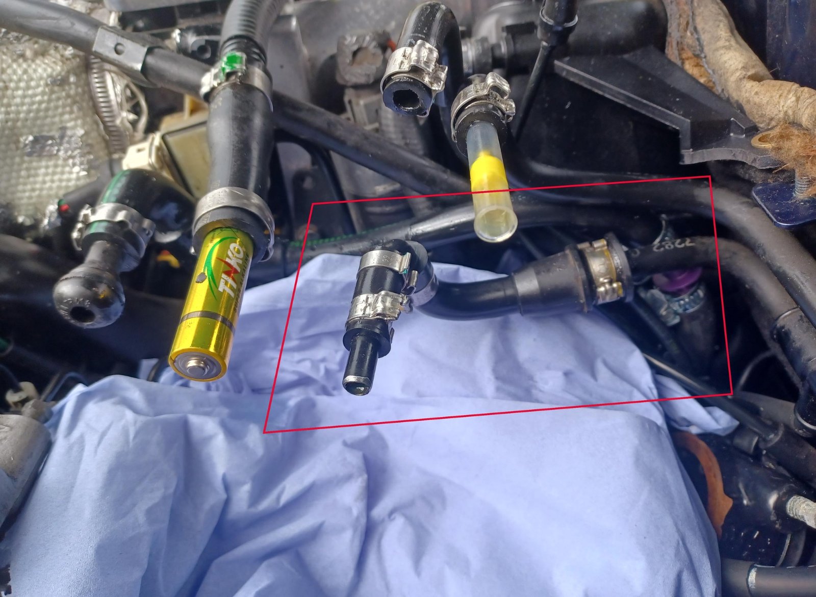

UPDATE :
Pipe was split just by the clip..... the new rubber "tube of pain" is now on the pinion pipe.
Next challenge is to get it clipped/jubilee'd up, that is going to be a sod to do.
It has only taken me 2 1/2 days !!!!!!!!
The -Temp- fix of the return line from the steering pinion is fixed, by replacing the line compleatly and joining behind the LHM tank.
Sadly this resulted in a couple of failures (more cracks) in the strut return octopus which required more work.
All seems like it is holding now..... new octopus is on the way from France.
