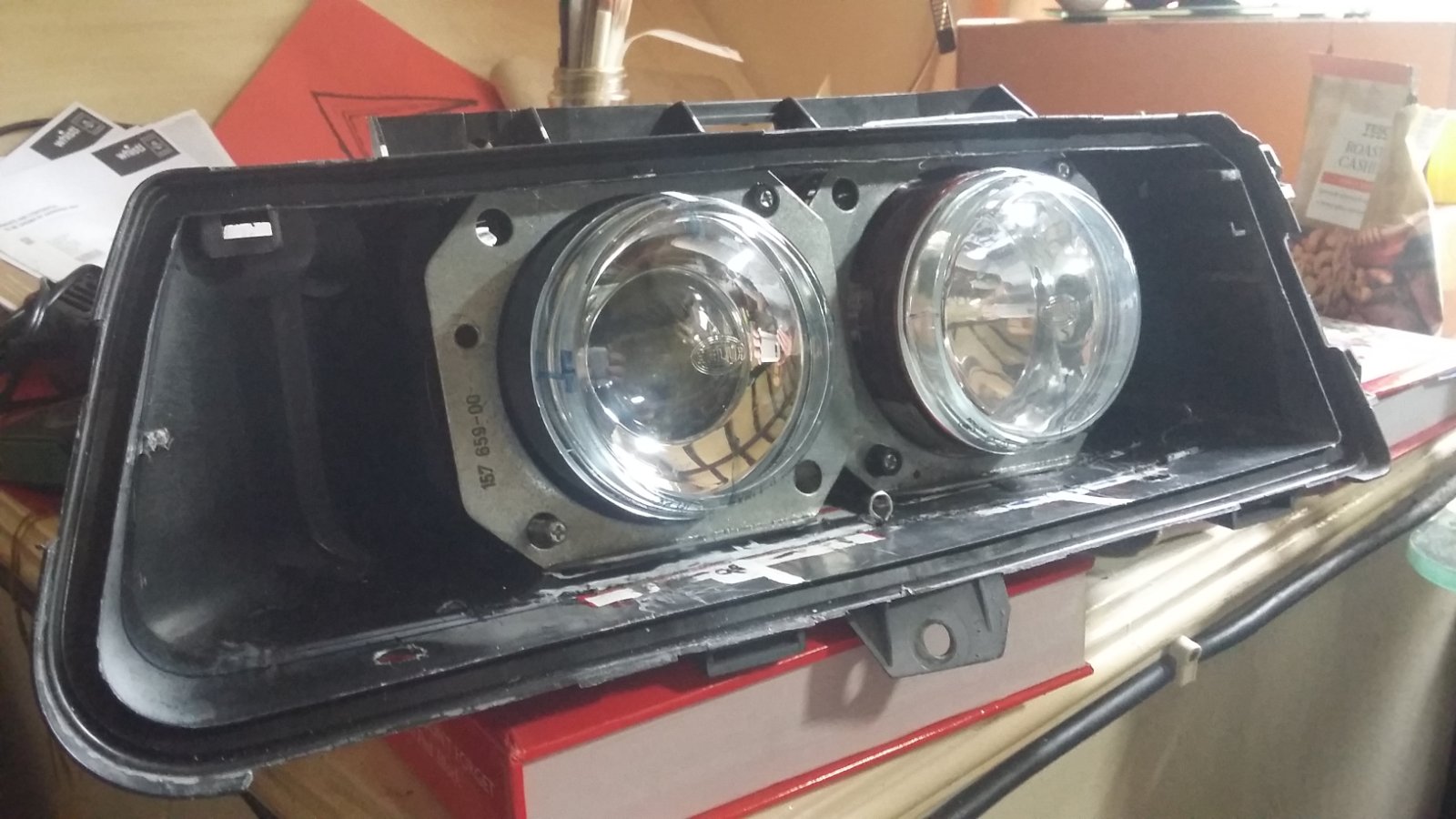

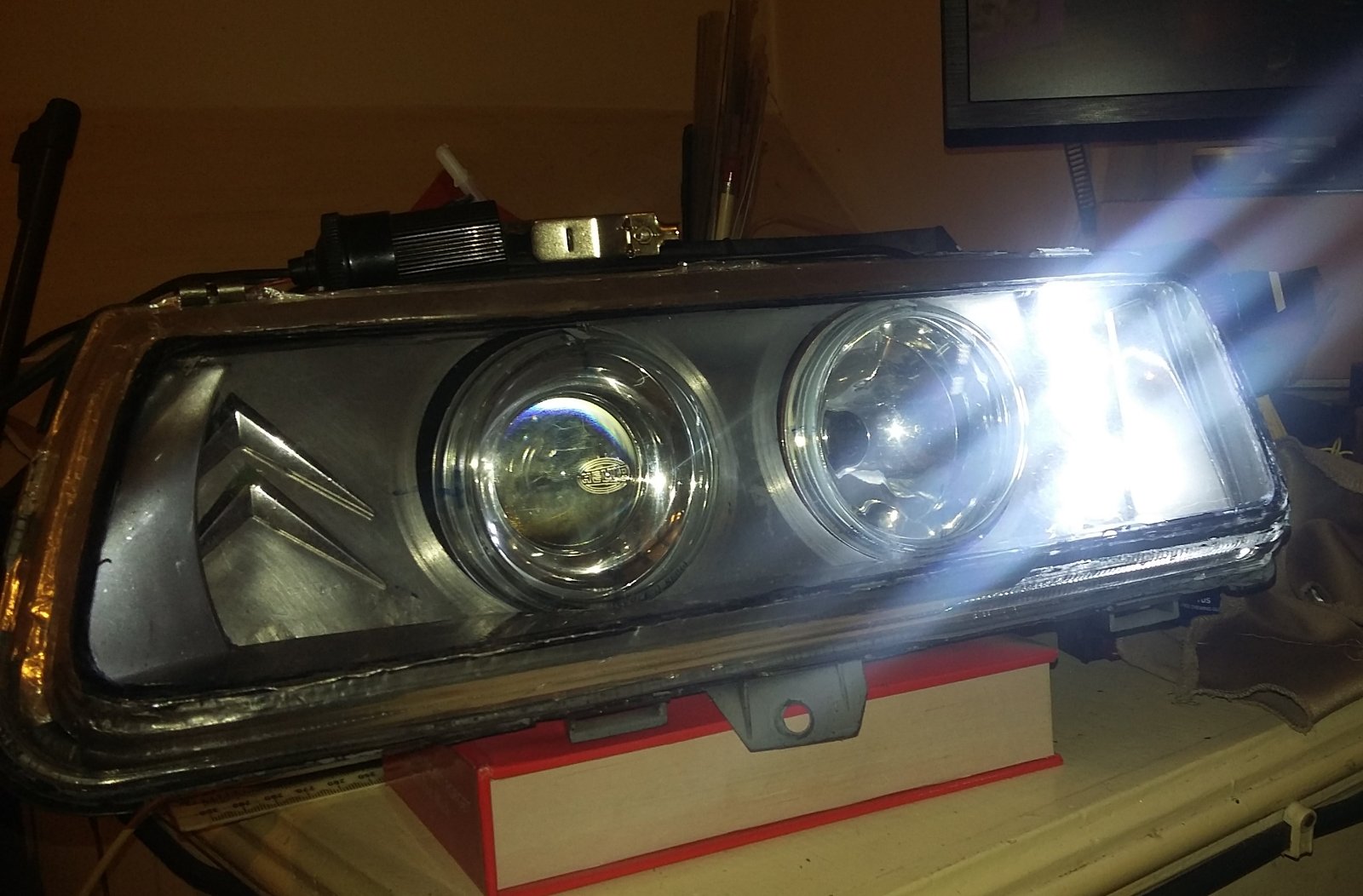

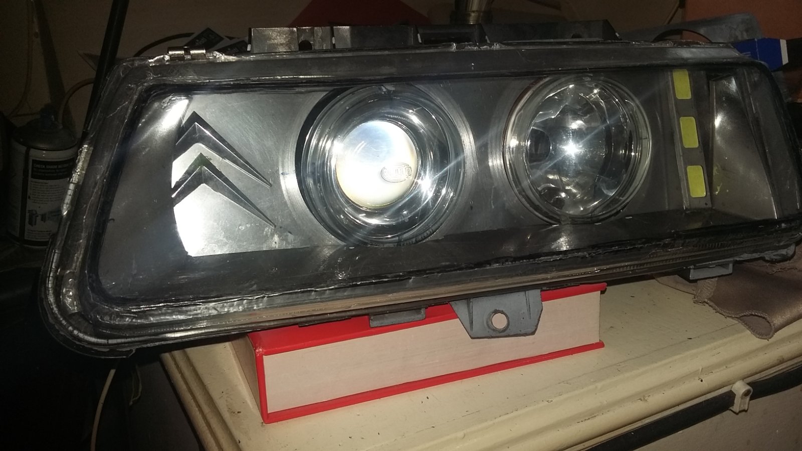

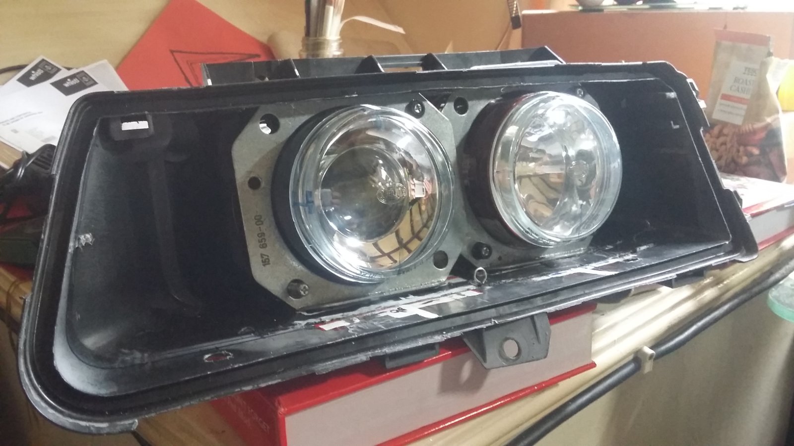

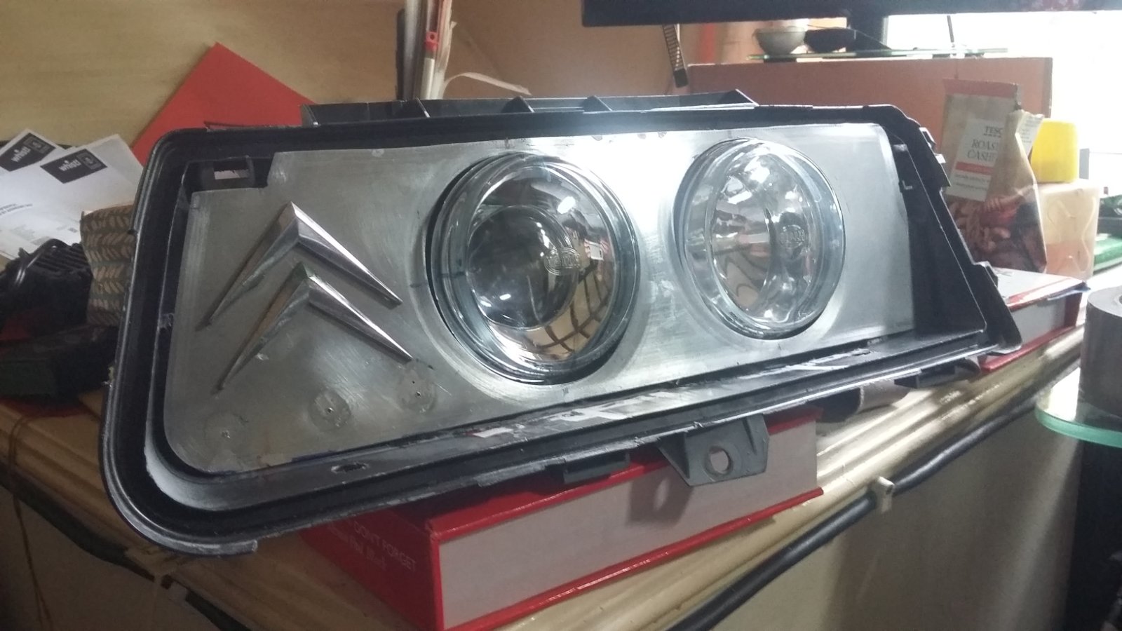

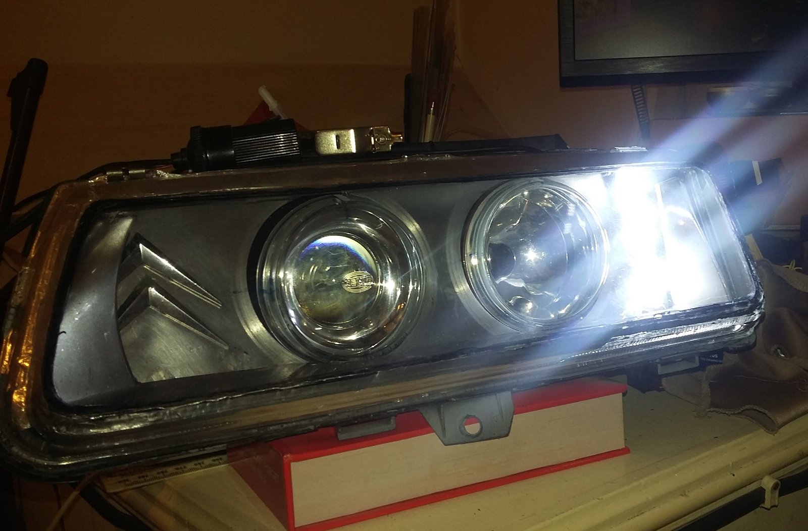

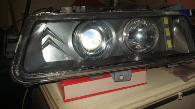

I have now totally simplified the way to fit upgraded lamps from Hella...these lamp units have approval/markings for use in the Eu and also use the original style H1 bulbs.
I am making final measurements, drawing "Lay-On" masks to enable the small alterations to be DIY-able with minimal materials.
At present other than the Hella Units I will need the glass "blown" in plastic, the face plate cut with a water-jet in S-Steel and 2x simple flat brackets made at the same time.
LED's
I will hide these behind the face plate and have a set of drilled holes with lens inserted..
LED's

Re: I am an Activaist-v6 and suffer AX-isum
I like the way you have included the chevrons Alasdair.

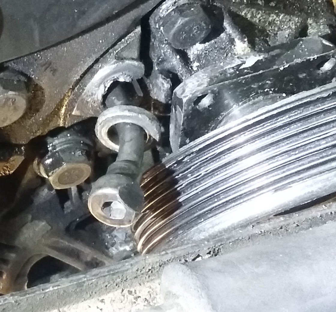

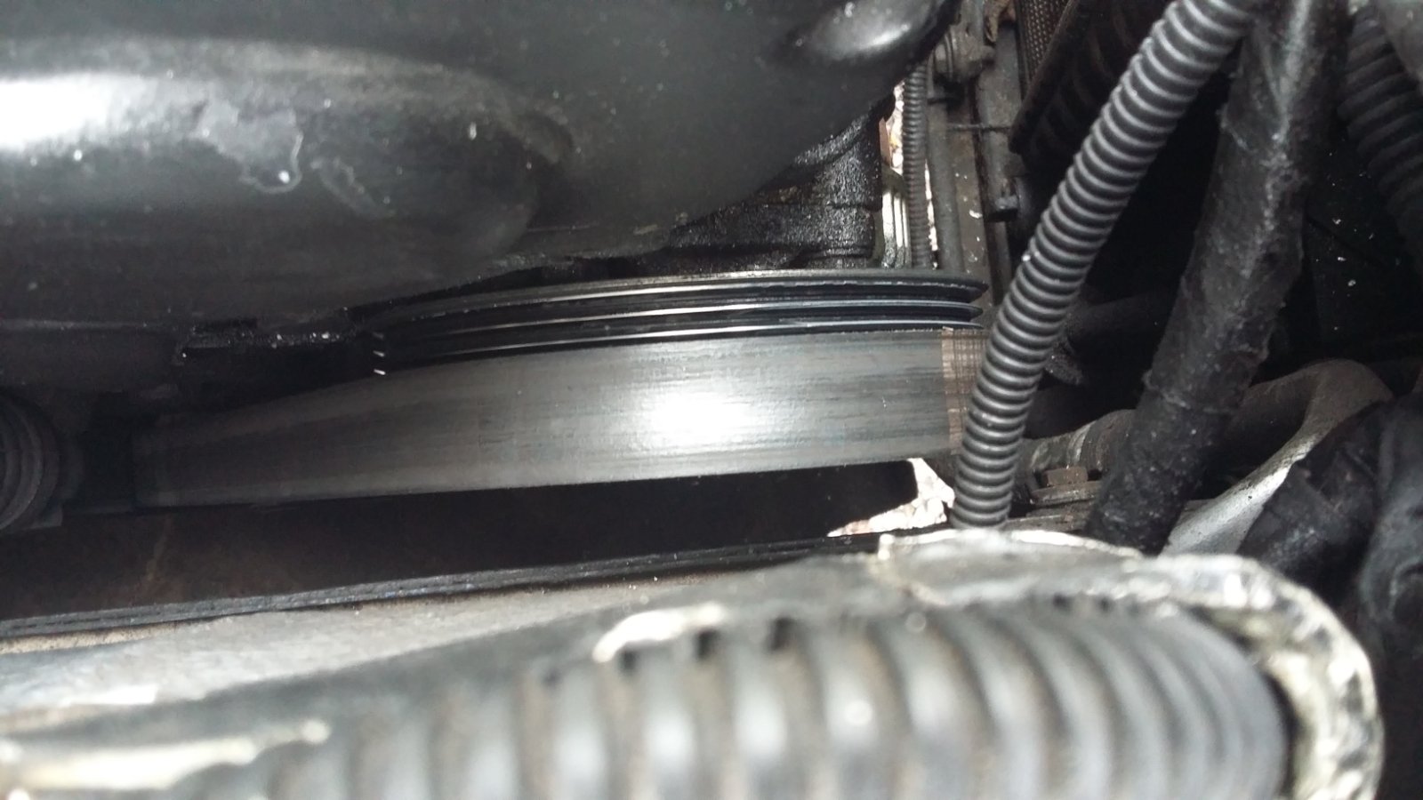

BUGGER !....
Ummm, I wonder why ?
ohhh dear failed HP pump securing bolt (threaded area)

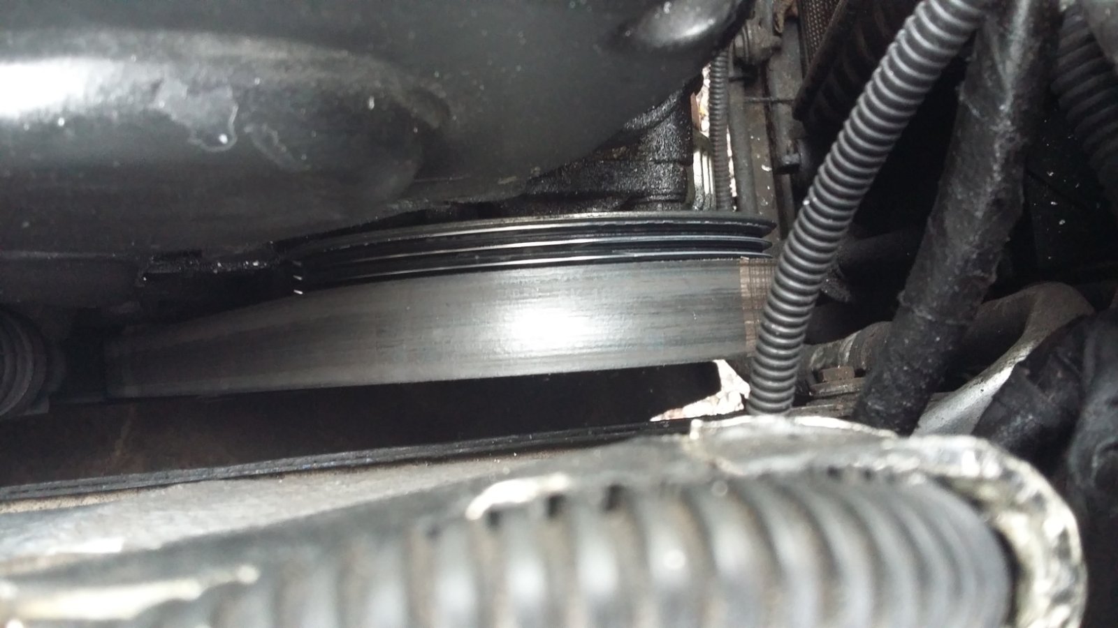

Ohh great, this has wrecked the lower pulley as well.
How did the thread fail? If I have understood correctly.
- Posts: 11836
- Joined: 28 Mar 2013, 21:05
- x 1996
Not a clue....the rebuilt pump was put on 3+ years ago
- Posts: 10971
- Joined: 09 Nov 2005, 22:03
- x 1459
Did the thread strip or something else?
- Posts: 11836
- x 1996
bolt failed just above the thread....the long top one...the bent one in the photo
- Posts: 10971
- x 1459
I would have thought that failure likely caused by the other bolts being loose, throwing strain any vibration onto that one.
